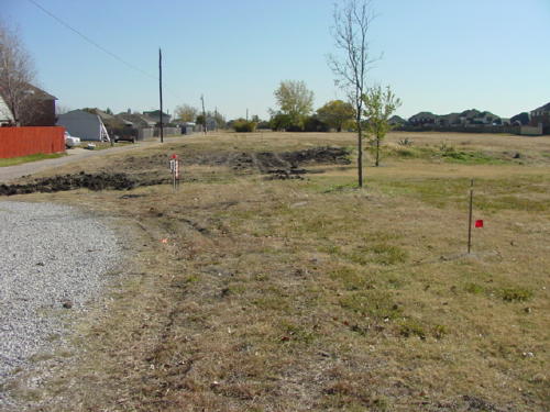

Here we have bois de arc (bo dark) trees. Little they have thorns from heck. Old they're tough. I pulled a bunch of posts this summer that had been in the ground since 1961. They're still usable unless you've got your heart set on using wood staples. Won't work. Stuff's harder than a bad girl's heart.

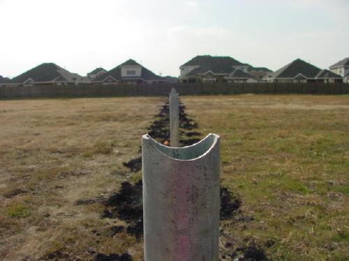

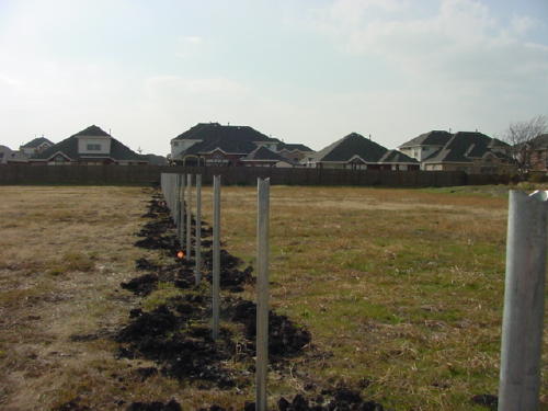

This is looking down a line for 276'. Ready for top rail to be welded in.

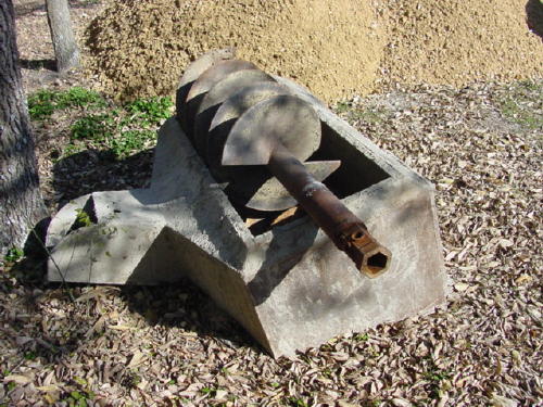

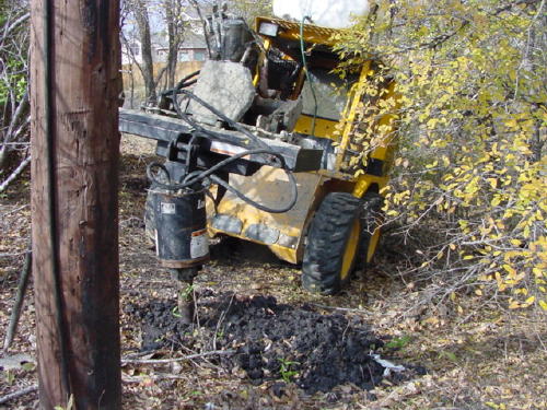

Drilling holes can sometimes get you into the tightest of spaces.

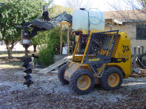

/ Fence project #25
But when it gets this tight I get out old Roja, my favoritest friend when doing holes in tight spots.
/ Fence project #26
This is Roja with a twelve inch bit. She can drill a twelve inch hole six feet deep and has done so on may occasions. But since Iris has come into the picture Roja hasn't seen much action. But man, in the old days, we did the deed over and often.

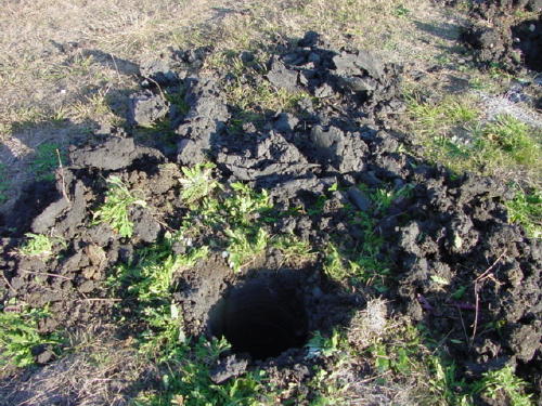

I know what you mean about fear barriers (electric fences) Paul. We used to have an old boy here in town that had about five acres right at a pretty busy intersection. He had one hot wire around what he wanted the cows to eat. Worked fine as far as I know. But it used to blow my mind to see a couple of cows and a steer or two behaving behind just a threat of a fence. /forums/images/graemlins/grin.gif
Yesterday evening--last night we got less than an inch of rain. It turned the clay into a fine mess. I'd probably have been better off just stripping down and wallowing in it before I even hit a lick at work. Stuff got everywhere.
Of course I couldn't drive along the fence line because Lucy is the stickingest truck I've ever owned. She sees mud and she just squats and won't move. So I pulled out the long leads. There's nothing as much fun as handling two hundred foot of welding cable in gumbo mud. Pure t fun. /forums/images/graemlins/frown.gif
Here's a shot of my boots. They were like ankle weights all day long. This clay just gangs up on a boot if it gets a chance.

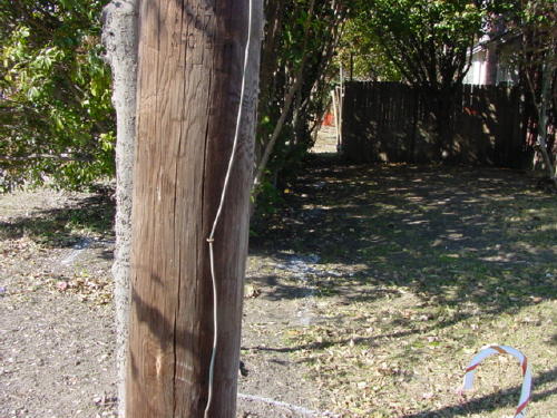

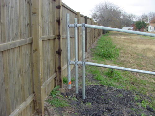

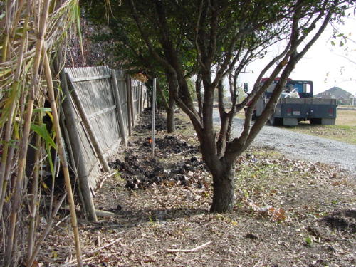

One of my more serious concerns when doing a fence is keeping it on my customer's property. I really discourage putting it on the line unless both parties are paying for it. Of course most times when I'm called in to do a fence there's a problem already between the two parties. /forums/images/graemlins/ooo.gif
In this situation they built the screen fence six inches inside their property line. I wanted ours to be a couple of inches inside each way too.
So I did this.
It covers the area without attaching to their fence or their ground.
You can see the property pin in the corner of the picture.

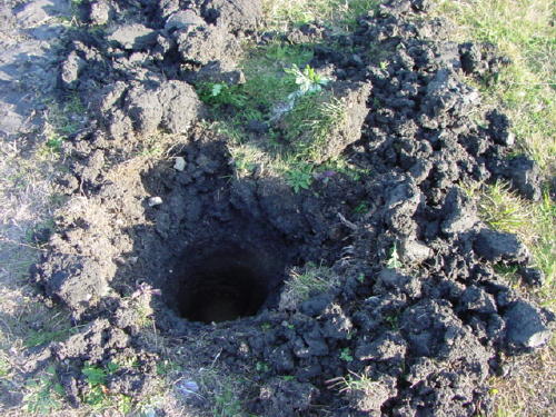

This is looking down the interestingly tight section. It was a bugger bear to dig. It wasn't fun to weld in. And I look forward to putting in the wire like getting a root canal.

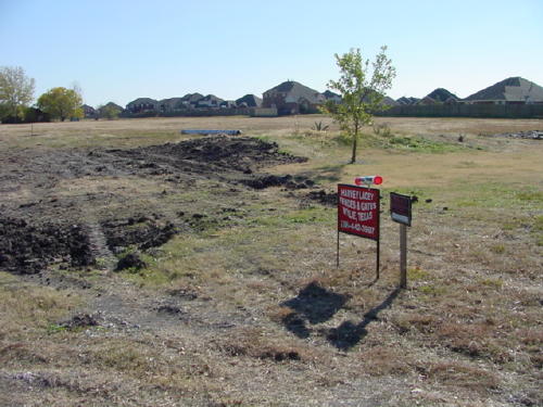

I've got about a hundred and fifty feet to weld in and then it's time to put up the wire. One of the things that's different about the way I do it versus the way it's commonly done around here is I put all the work into setting the posts in line and set for height. Then when it comes to welding it in it's just a matter of laying in the pipe and it's ready, all fitted up and with a joint even Ray Charles could sew up. The only cutting is done to so that all joints in the top rail are over a post. I've seen lots of broken apart joints done by weldors much better than myself. So I cheat. I make sure the joint is not only welded but it's welded to the post, insurance for the insecure you might say.
This is the last leg. It's only about a hundred feet in length.

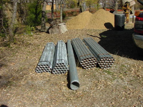

/ Fence project #37
Remember this?
Check it out now after I've put most of those twelve yards through the mixer and then into holes in the ground.
