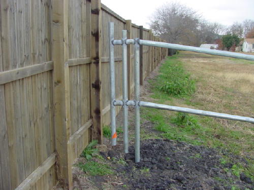

/ Fence project #43
If you look at the hinge post you'll see that I use the gate upright as part of the hinge system. That's point one five four wall galvanized two inch pipe. The pipe is hot dip galvanized. That means it's galvanized inside too. That's a good thing.
Now the pipe has about a two point next to nothing I.D. One of the problems with hinges is if they're not kept lubed and active and they're the same metal they freeze up. Especially if they're mild steel. Rust can be the tie that binds. /forums/images/graemlins/grin.gif
The pin for that hinge is two inch stainless bar. It's not cheap, twenty two dollars a foot for scrap price if'n you're buying. Of course this gate has less than a foot of pin in it. Actually there's a four inch piece at each end. That's enough to tie into the strength of the horizontal rail which is what I think is important. The stainless and the galvanized combination should never bind. They'll also last past my lifetime. /forums/images/graemlins/smirk.gif

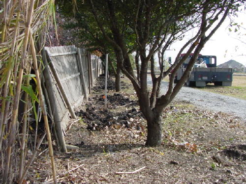

/ Fence project #46
This little angled panel took as long as stretching a full roll. Pain in the backside. But part of it.

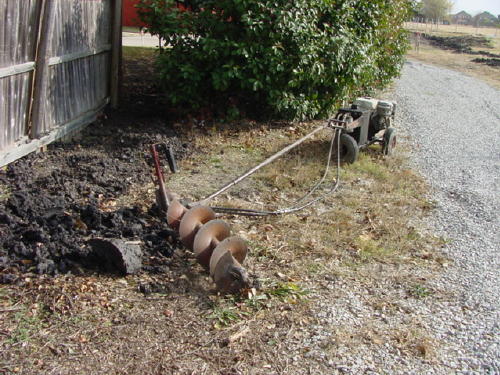

/ Fence project #47
Looking east.
This is five foot non climb horse wire.
I use steel fence ties. Aluminum is for sissies. It doesn't work worth a flip besides getting a job done half way fast like.
When I'm done each fence post will have four ties. There will be five ties between posts on the top rail. Each tie will be tight.
Lately there's come out these twist ties. A couple of problems with those. First the ends are a potential hazard to livestock. Secondly and just as important, they don't secure the wire the way a fenceman doing a steel tie does.
When a tie is put on properly the ends do not present a hazard. And it works with the post and the fabric to get the best out of each.
I'll climb off of my soapbox.
I like my work. I hate to see the craftsmanship taken out of it.

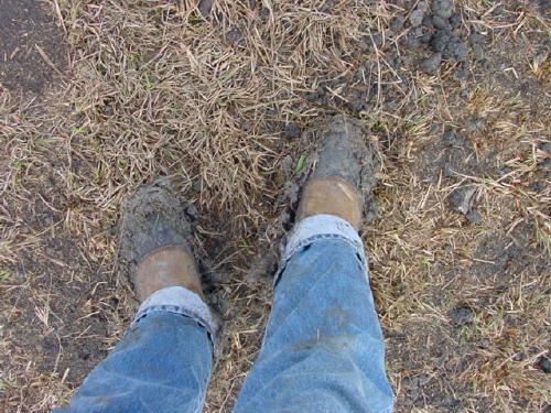

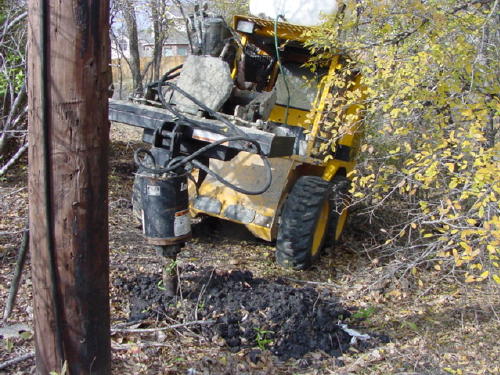

/ Fence project #53
I stopped by my local rental store and rented a trenching attachment for a skid steer. Iris handled it like it wasn't nothing but a thing.
That darn gumbo is a bugger bear to do anything with but wallow and get it all over you. We did about four hundred feet of six inch trench eighteen inches deep.

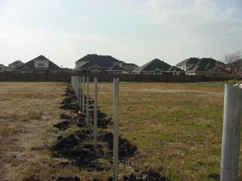

/ Fence project #54
And that was before lunch! I had to develop a little technique because just doing it like in normal dirt didn't work worth squat. But one Iris and me got it figured out it was grass through a goose, er, uh, goose through grass?
