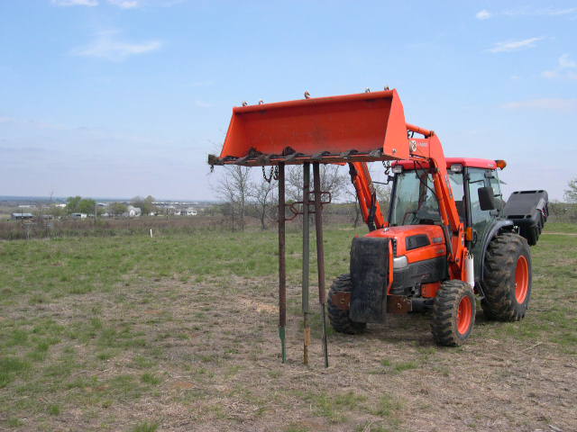

dmccarty, the following tehnique is recommended:
high tensile wire for everything, either barb or smooth
high voltage, low impedence fence charger on at least one smooth wire. Smooth wire is made hot. Use a 100 mile charger only... the smaller ones don't work well.
5 strands minimum, 3 barb and 2 electric, or that and more barb
T posts for the line posts
SECRET: DRIVE T POSTS WITH YOUR FEL... see photo below, use a pipe sheath to keep T post from bending and to get all same height unless you hit rock.
Corner braces shound NOT be a true H brace where the cross bar is
centered. Cross bar should be as near the top of the brace posts as possible and distance between corner and brace post should be long... recomment 7+ feet
You need to put in a corner post and TWO brace posts with cross bar as indicated
Sink corner and brace posts 4 feet in ground.. it's about twice as good as just 3 feet
You should use rachets to tension each strand of wire... leave in fence to take out slack later
use a rachet on your corner brace wire.. leave in fence for taking up slack later.
I've tried numerous T post spacings for the line posts... I've settled on putting a post every 5 of my steps... am 5'10" tall... further distances over time result in animals going thru.
PM me if questions

TXDon,
Thanks for the info. I like he FEL putting in the TPost. I'll have to try it or a variation. I'm not sure it will work off the FEL for me though. I'm in heavy thick woods and it will take alot of work just to clear 6-8 feet to get the tractor in along the fence line. Having enough space to get the tractor perpendicular to the fence line is problematic....
BUT, I do have a backhoe. :D The JD48 should be albe to push down and would be much easy to use in the limited space. :)
Is the pipe attached to the FEL somehow?
Do you just start the Tpost and then push it in with the FEL?
Later,
Dan
   / fencing 100 acres #19
I put in T posts as follows:
I have a HST transmission... makes creeping easy... necessary for this work.
Have a trusting buddy place the bottom of the T post where it belongs with the proper side out, etc. Place the CENTER of the FEL on the top of the T post... very gently while buddy holds it, just enough down pressure to hold it in place.
Buddy backs AWAY from the post for safety.. 6 to 10 feet... THEN apply gentle down pressure... post should begin to slip into the ground, but because of the geometry of things, at about 6 inches in, the top will begin to come inward toward the tractor, getting the post out of plumb. STOP the down pressure, raise the FEL, the top of the post will spring back into place, now you can again put down pressure on the post. Continue until post is fully in the ground. If you hit a rock, you will feel it, front end of tractor will begin to rise, DO NOT get front wheels off of the ground.. you WILL slide sideways and post will not be the better for it. If post hits tough dirt and won't slide in further, you CAN kinda tap the post by dropping the FEL on it... takes a little time to get experience on how high to lift the FEL before dropping, etc... but quickly learned... if you have actually hit ROCK, you will NOT be able to pound the post in this way... it'll simply break somehow... I've adopted the philosophy that if I can't drive it any further with FEL, then it's in good enough for me and leave it be even if it maybe isn't in exactly as far as other posts...
Pipe sheath around post is a KEY addition that I consider MANDATORY for safety... it keeps the post from assuming a C or S shape and snapping off... trust me, it happens without the pipe sheath... about 1 time in 15 to 20 posts.. pipe is just an extra long T post driver, not attached to tractor in any way, end is flat with welded plug, handles added for ease of carrying, etc.
I sometimes put extra weight in the FEL bucket, makes me feel better. I expect that a variation with back hoe as the driver would work, too.
I hang a 5 gallon bucket, or several, from the FEL chain hooks.. makes a good place for carrying stuff. FEL bucket is a good place to put the spare T posts that you will be driving later.
When it's all done, you can walk back down the line of posts and pull the posts into vertical as best possible... I've never done a perfectly vertical job, but I remember that my shoulders are still operative and decide that using the FEL is a GOOD thing. Sometimes, a post will twist around so that it makes it difficult to get a clip properly set on it... in this case, I use a LONG pipe wrench and twist the post back into line... attach the pipe wrench right at ground level.
Around here, there is another way to make a fence corner... take a cattle panel, wire it into a circle and fill it with rocks... This post WILL NOT pull out of the ground. Depending on your resources, this could be a possibility since you have equipment to handle rocks. If you don't have too many corners, this can be very effective and cost/time effective.
jinman, the only effective corner I've found is to sink it 4 feet, have two brace posts with the cross braces 90% of the way off of the ground. Cross braces should be pipe, wood tends to bend and slip out. I use metal pins to keep the pipe cross braces in place.
