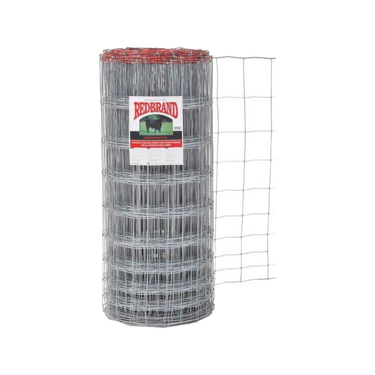

Knotted field wire. Shop around! wide range of prices.
Knotted is best. Welded rusts at the joints and fails.
Usually, 330 ft rolls but I have seen in 1000 ft rolls.
330 is enough for 1 man to handle.

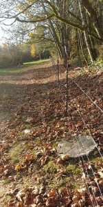

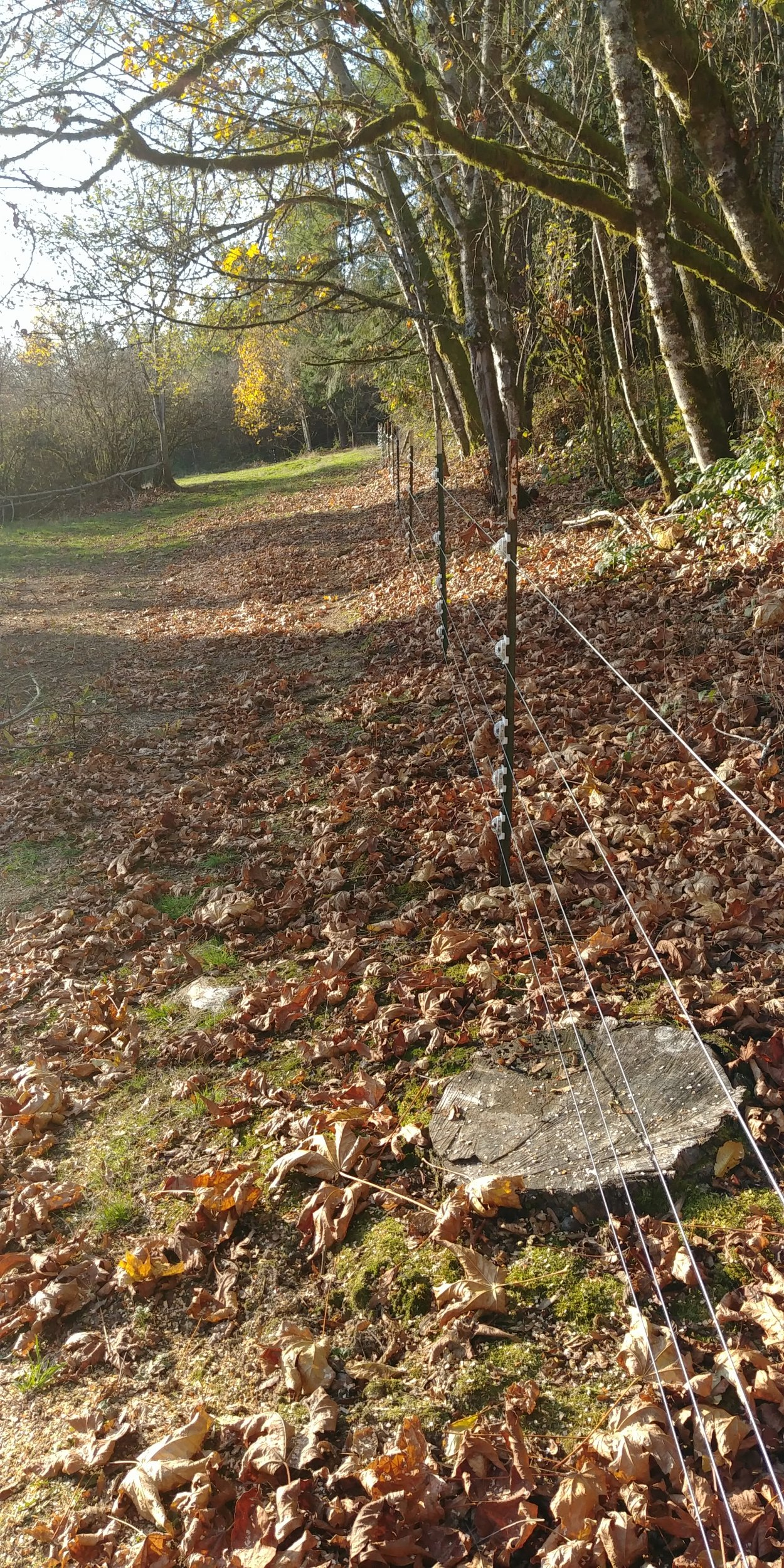

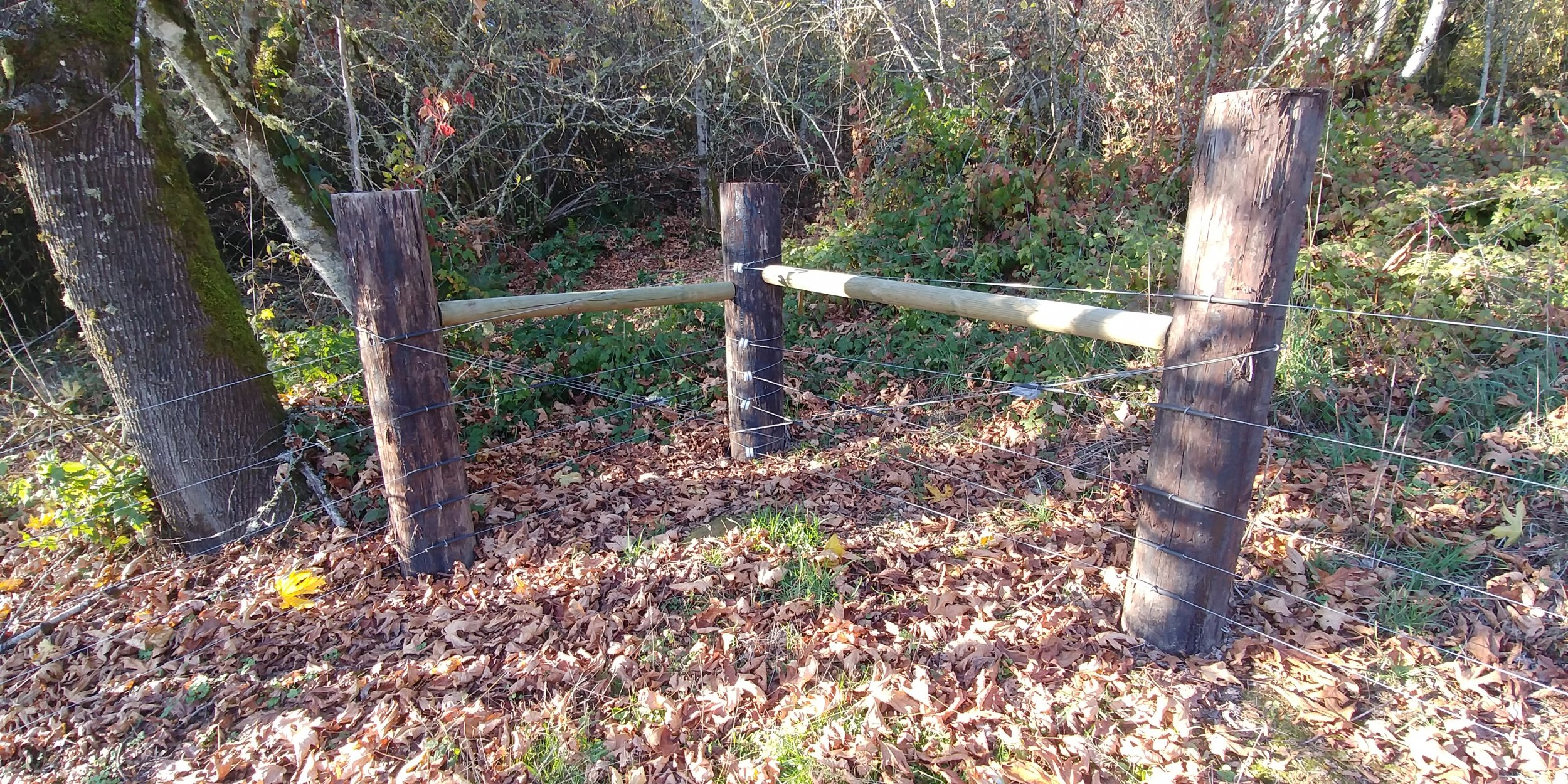

I was in a similar boat. I talked to my neighbor about trees on the property line and we both decided all should come down. I had an existing fence line I had to pull out first (actually 3 built on top of each other) After cutting the trees in the way and clearing the old fences I went with 5 strand hi-tensile fence. I found some fairly new telephone polls that were used for dock pilings for a year then removed. Those are the corner posts, as for the intermediate fence post I used mostly T posts then every 15-20 I would sink another wood post. I have goats on my side of the fence and they stay in the electric fence just fine. They do need a training area first, to show them not to mess with the fence.
