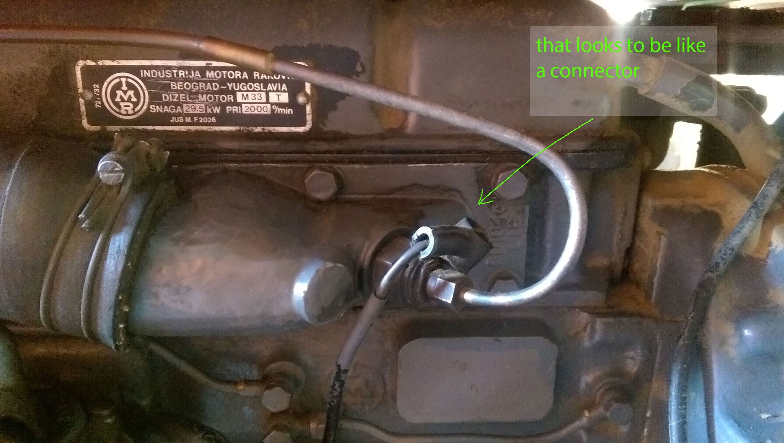

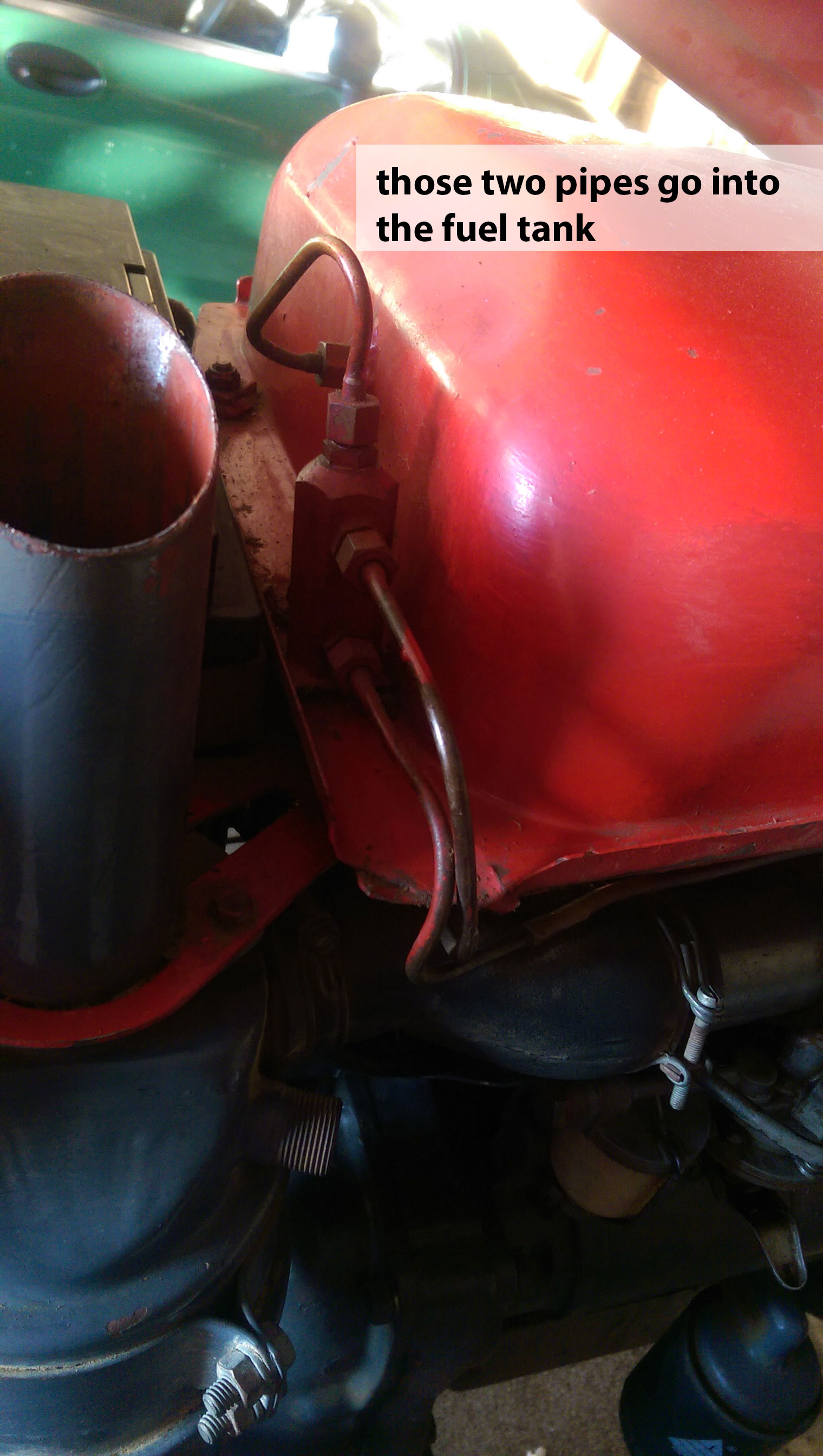

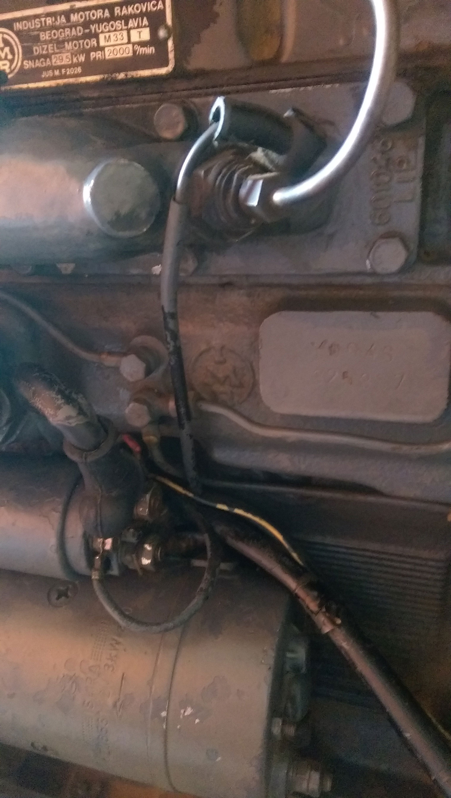

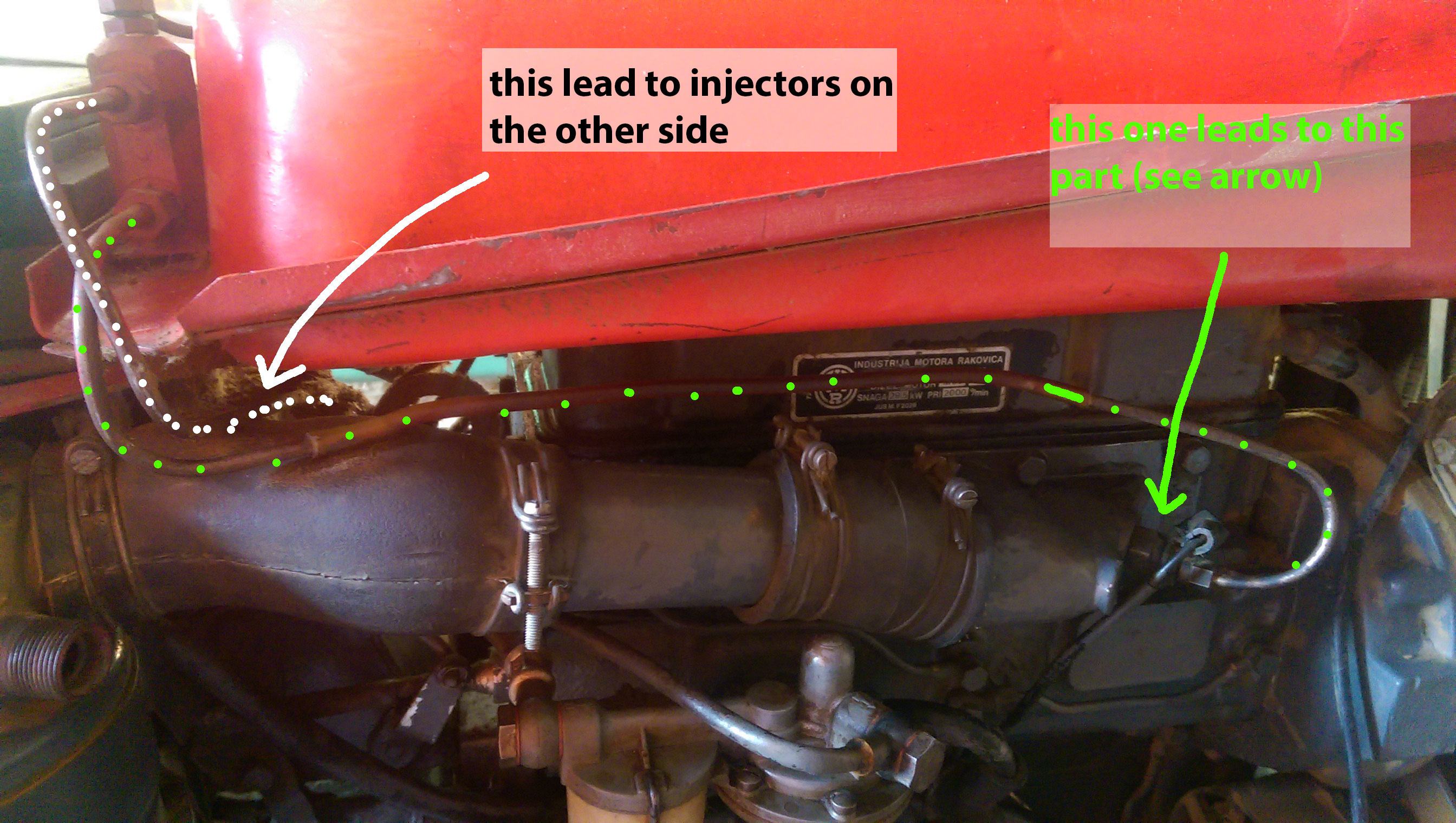

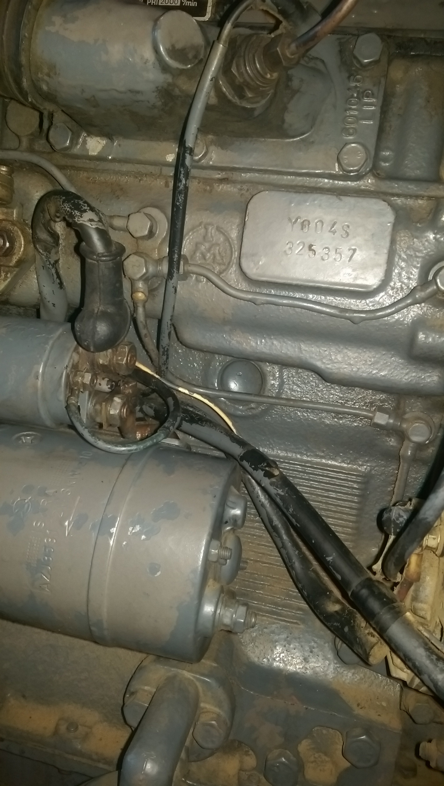

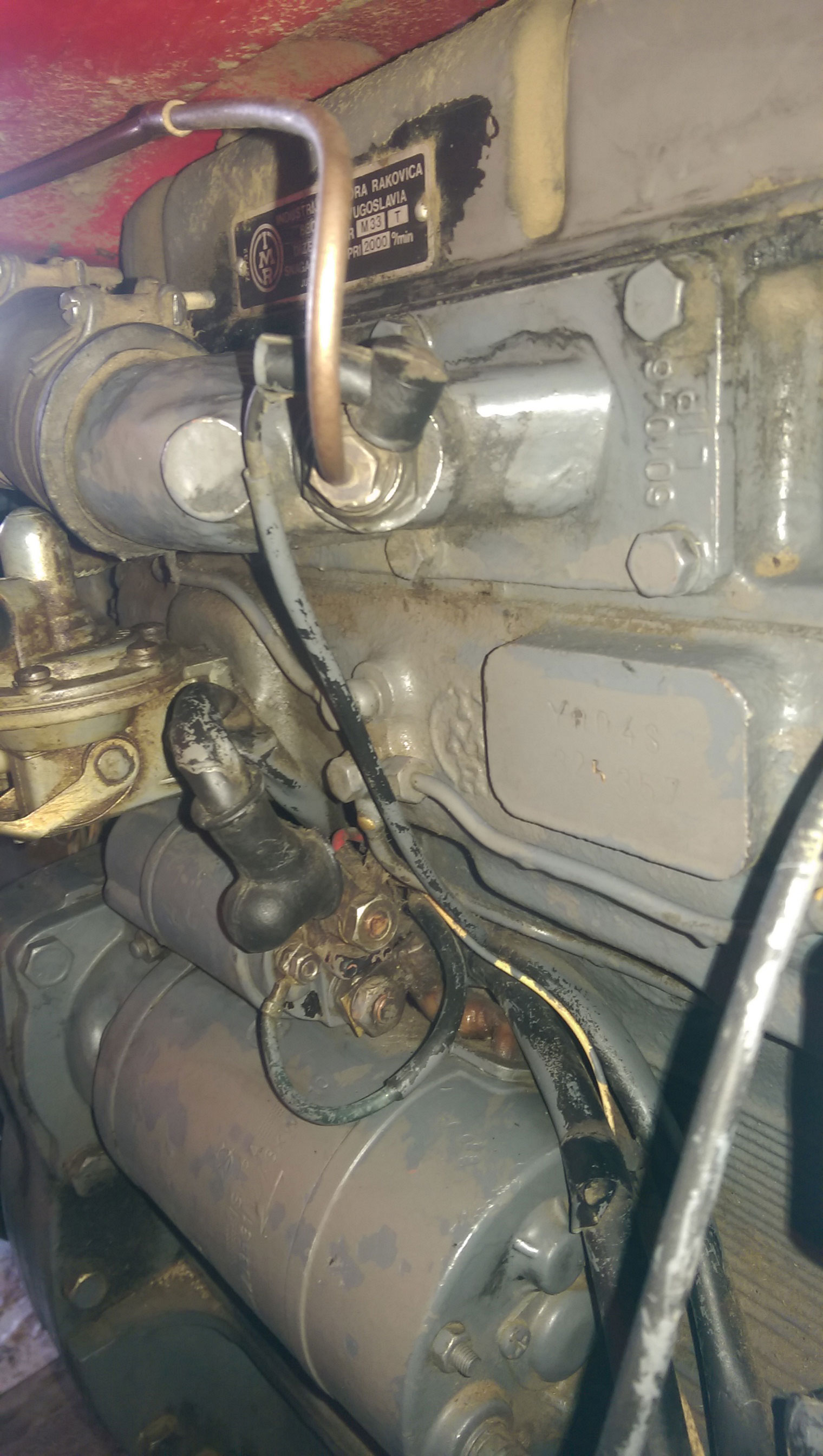

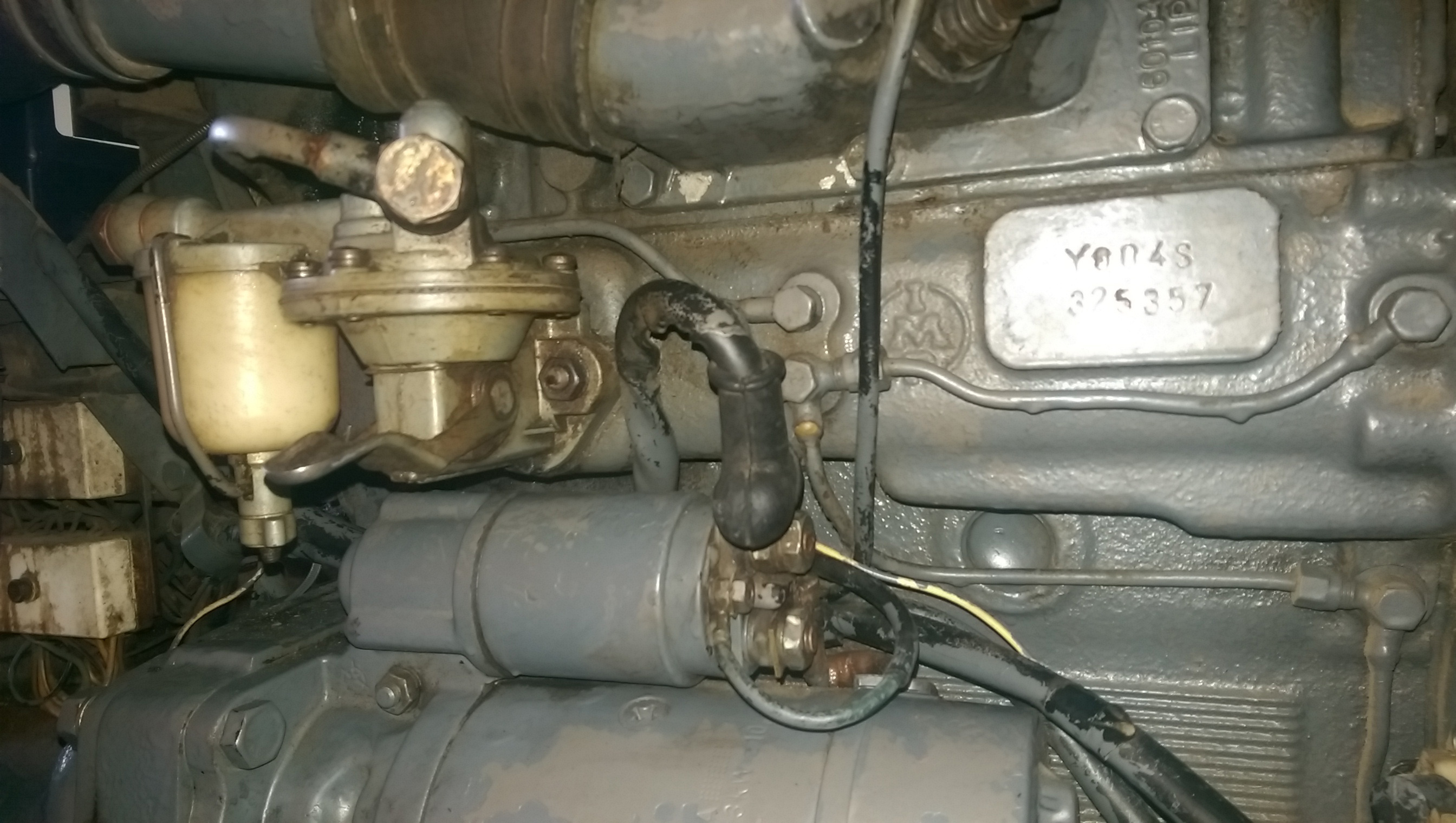

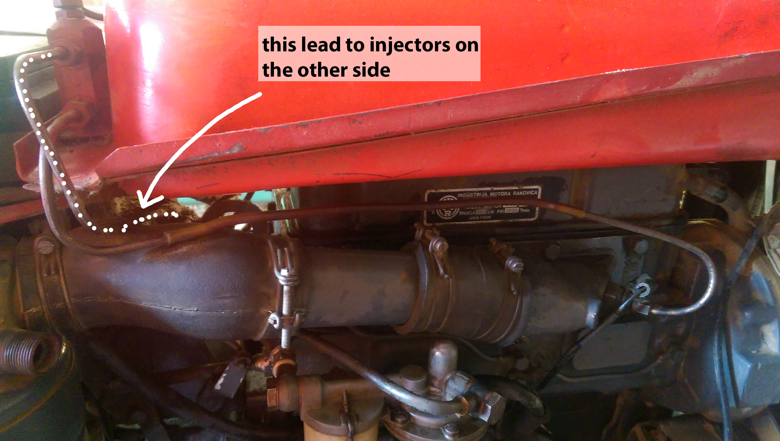

Update:
I wouldn't know what to unplug here. I mean, I would need more precise information on what to try to unplug for that 'thermo start' thing. I provided new, better pictures.

   / Ferguson excessive smoking #34
Thermostart of flamestart, does it work? Putt the key in preheat and wait, after 15 - 30 seconds you will hear poff sound made when the diesel ignites.
Thermostart testi.mp4 - YouTube
   / Ferguson excessive smoking #35
The GREEN dotted line & wire is the thermostart plug.. it drips a small amount of fuel into THE INTAKE when activated w/ the key switch & burns, heating the air for easy starting..
WHAT happens is, the plug will leak & drip fuel even tho the key isn't engaged.. causing a lot of smoke.

Hello,
I am back here to report the final outcome. Looks like the injector have not been refurbished before.
Now the injectors have been sent to be refurbished and, after that it finally works fine. The guy working on injector renewing said they were in very poor condition, with clogged nozzles ..
So if anyone else will experience blue smoke, it may be improper combustion due to clogged injector nozzles or due to an injector leaking.
Thank you all
