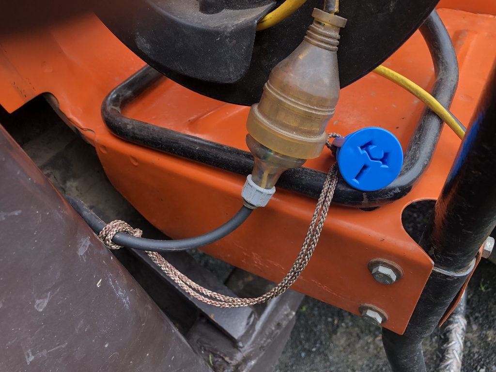

Installation.
OK, first things first, whilst you can simply cut a bit out of the heater hose and slip the unit in, that's not ideal. These little pumped heaters effectively function as a siphon, so they work best if you feed in water from as low as possible in your cooling system (bottom hose or a block drain) and feed it into a high point (upper heater hose or the thermostat housing). My FIAT is a ROPS tractor, so no cab, which means no AC and no heater... :-( (BTW anyone with a spare early FIAT 80 series cab that you want to sell - let me know...)
So the answer seemed easy enough, simply remove one of the M16 x 1.5 allen keyed bungs from the thermostat housing and weld a pipe nipple into my bottom hose pipe. Add a couple of elbows and Bob's your aunty (these days anyway). Best laid plans and all that, the bung was of course rusted in solid. Nothing I tried worked, good tools, EZI-OUTs, heat, drifting with a small chisel, nada. So out came the water pump and thermostat housing (one obscures the other). Anyway once on my bench, drilled close to thread minimum ID and tapped clean all was well. It did at least allow me to give my water pump a look over and grease job. Repaint everything, replacing a rotten pump inlet pipe at the same time, and reassemble. (1/2 day).
M16 x 1.5 is not a common thread for pipe adapters in OZ, and we use BSP for pipes here, not NPT as in the Americas (different I'm afraid). So eBay to the rescue and cheap M16 x 1.5 to 1/2" BSP adapter was sorted. Add in an extension nut and an elbow etc and voila, I have a top "heater" hose.

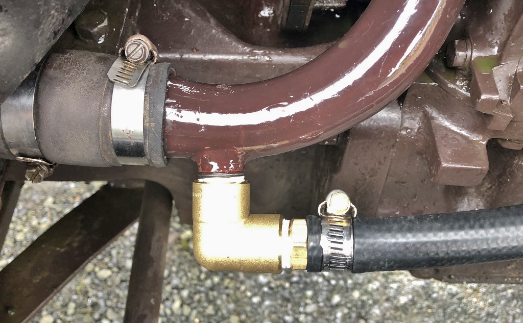

So that done on to the bottom hose pipe. As the pipe is mostly 36mm steel tube its not hard to simply buy a 1/2 BSP pipe nipple, cut to length, drill the hole and MIG it in place.
Add the required elbow and 5/8" (16mm) pipe barb and we have the bottom hose (inlet for the pump heater).

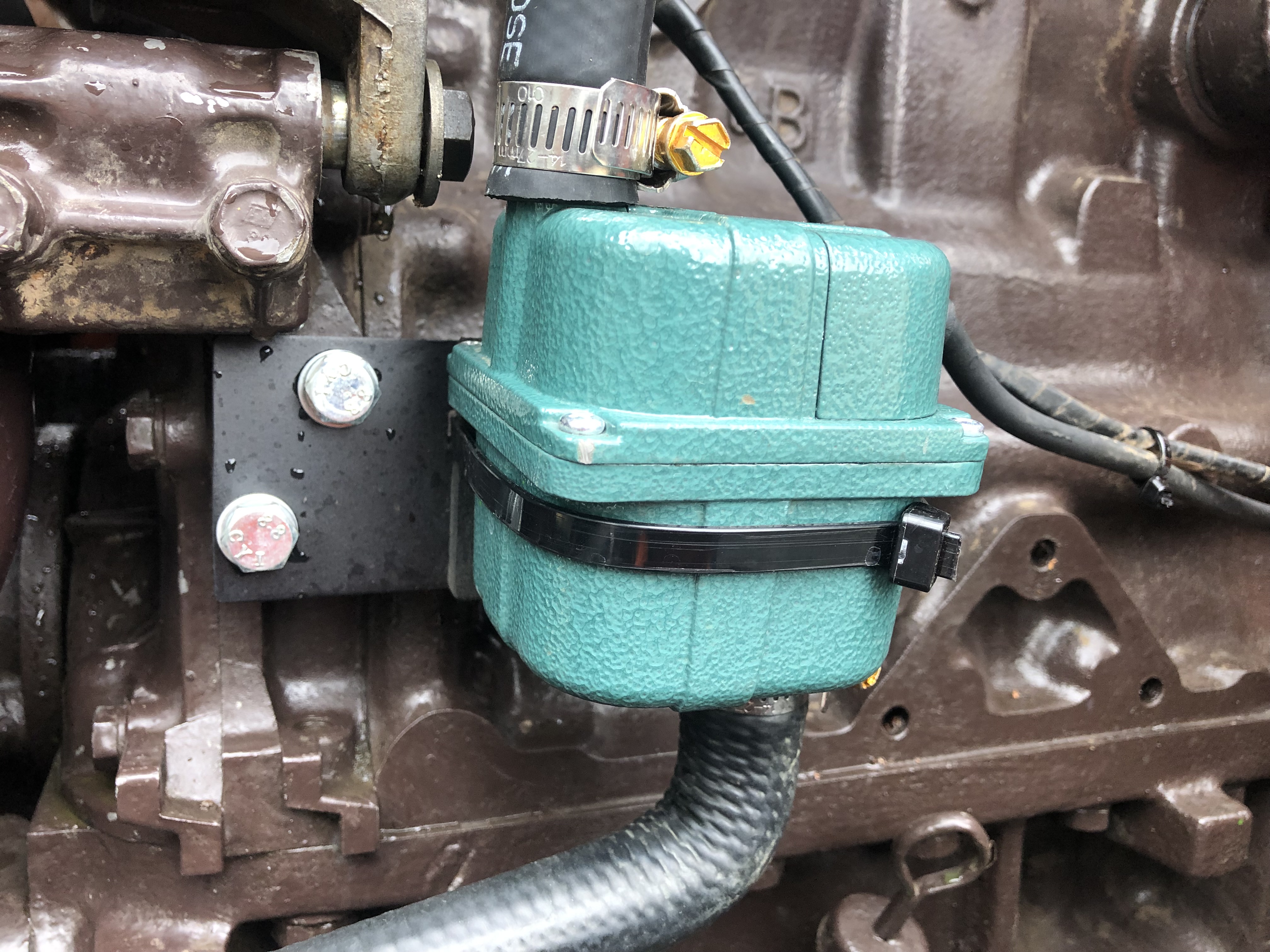

So onto mounting the unit itself...
The easiest place I could spot, was under the alternator where there are several M8 x 1.0 (fine) tapped holes. So I made a small steel bracket, slotted for a heavy duty zip tie (fast access), painted it and added some self adhesive 10mm high density sponge rubber. This rubber serving to isolate it from vibration a bit. This location allows minimal hose runs and allows the power lead to attach to the alternator harness naturally. The lead exits the engine bay just below the clutch pedal and a few zip ties ensure it stays thereabouts. A cheap outdoors type plastic power plug cap keeps the muck and moisture out when not in use.
So that's it, all done and working well. I did think about a more engineering type clamp for the unit, but this works well, its neat, strong and easy access.

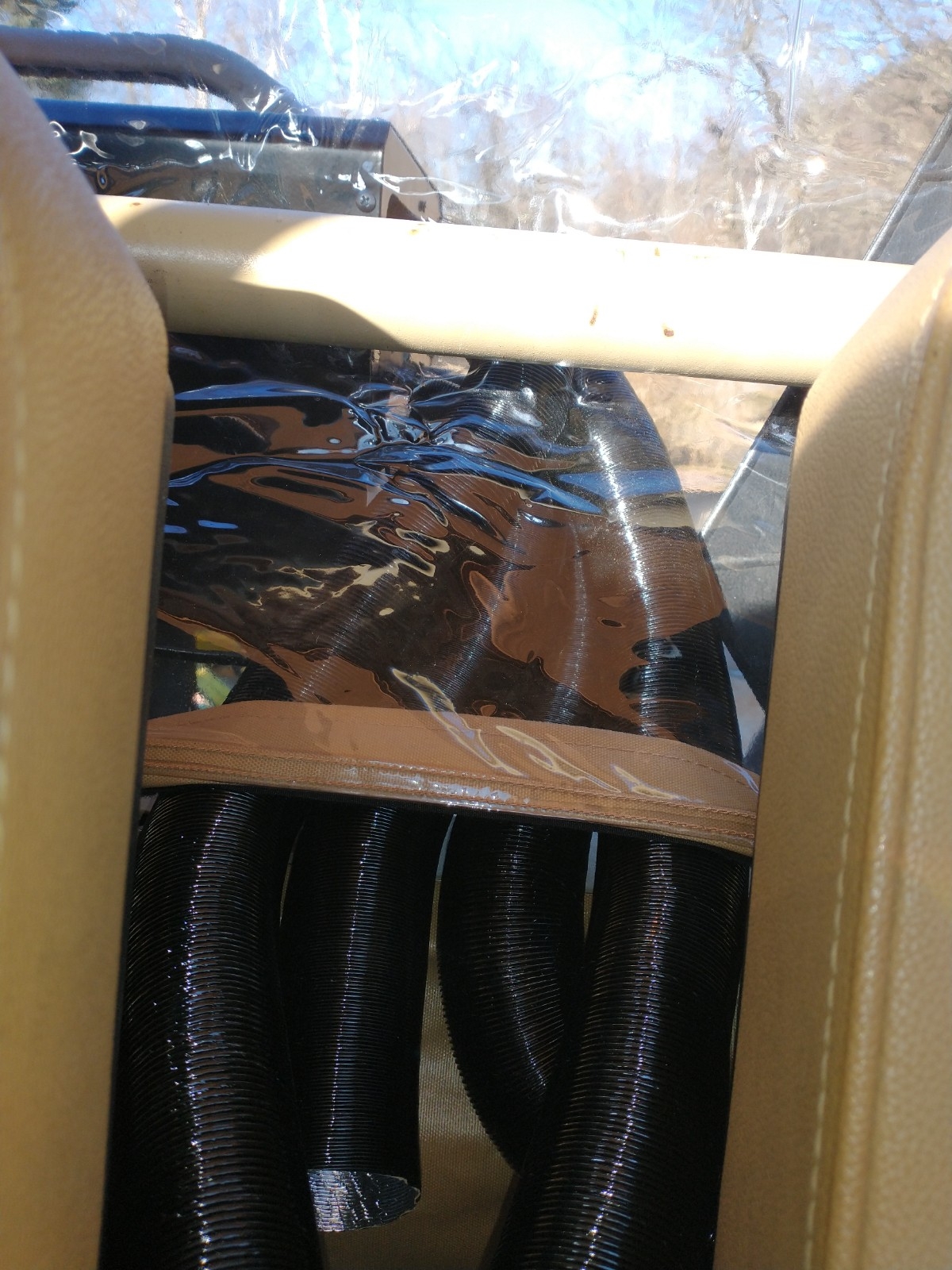

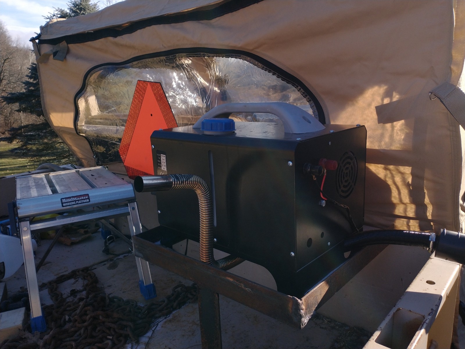

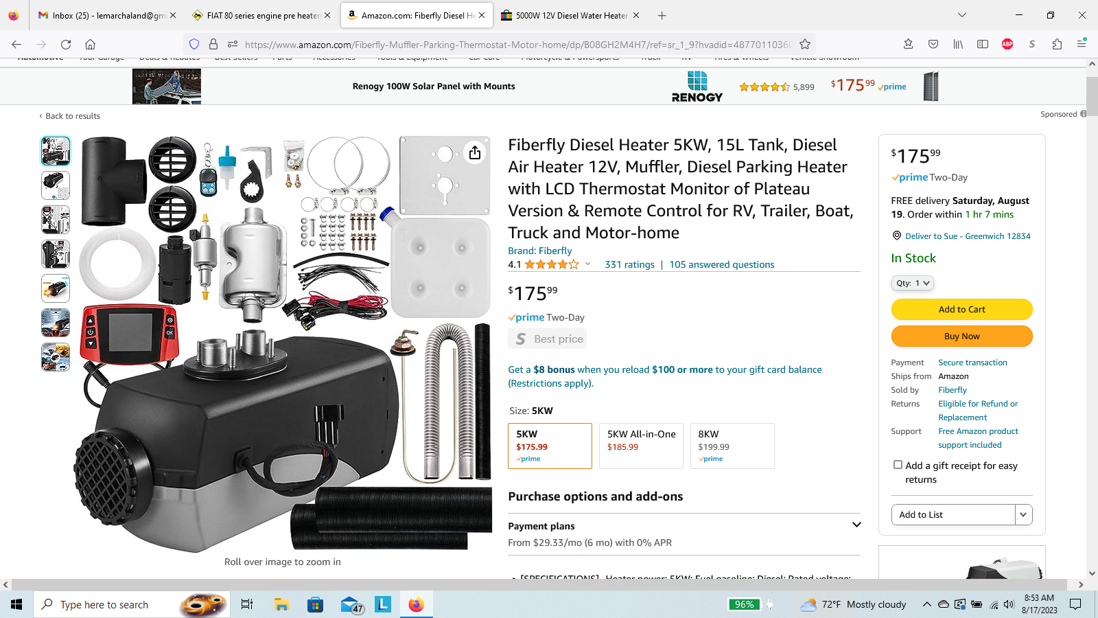

After using a chinese diesel to air heater this past winter in my utv,
I would be tempted to try their water heater types.
Haveing a stand alone hot water heater for preheating with no 120Vac needed
My air heater;

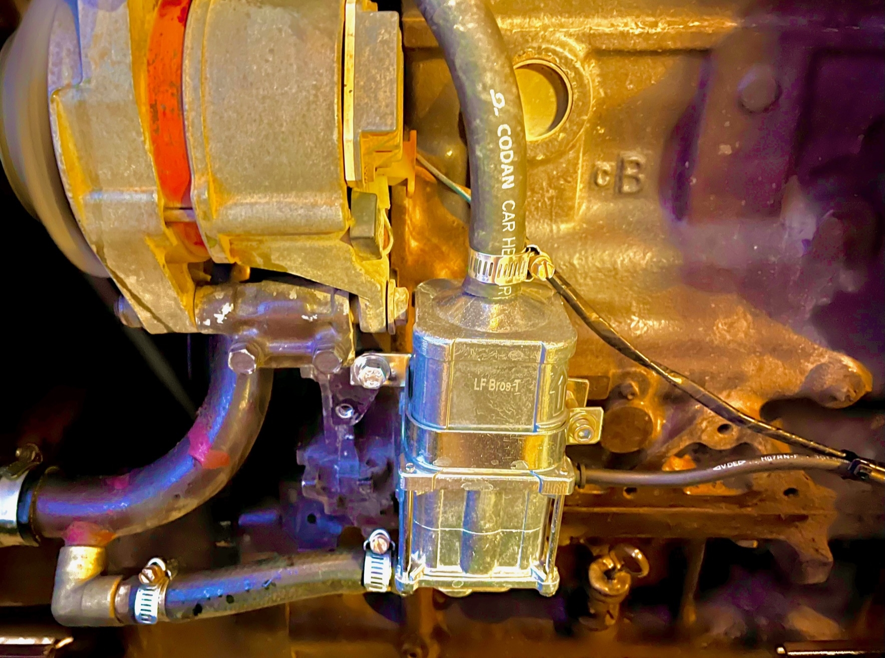

Finally received my new heater from eBay. 3KW this time. Still made in China (I think) and still covered in Russian writing. But a different design so here's hoping this one doesn't leak internally and short out like the last 2... Its an easier install as no elbow hose was required and its mounting bracket fits right up to an unused engine block thread.
