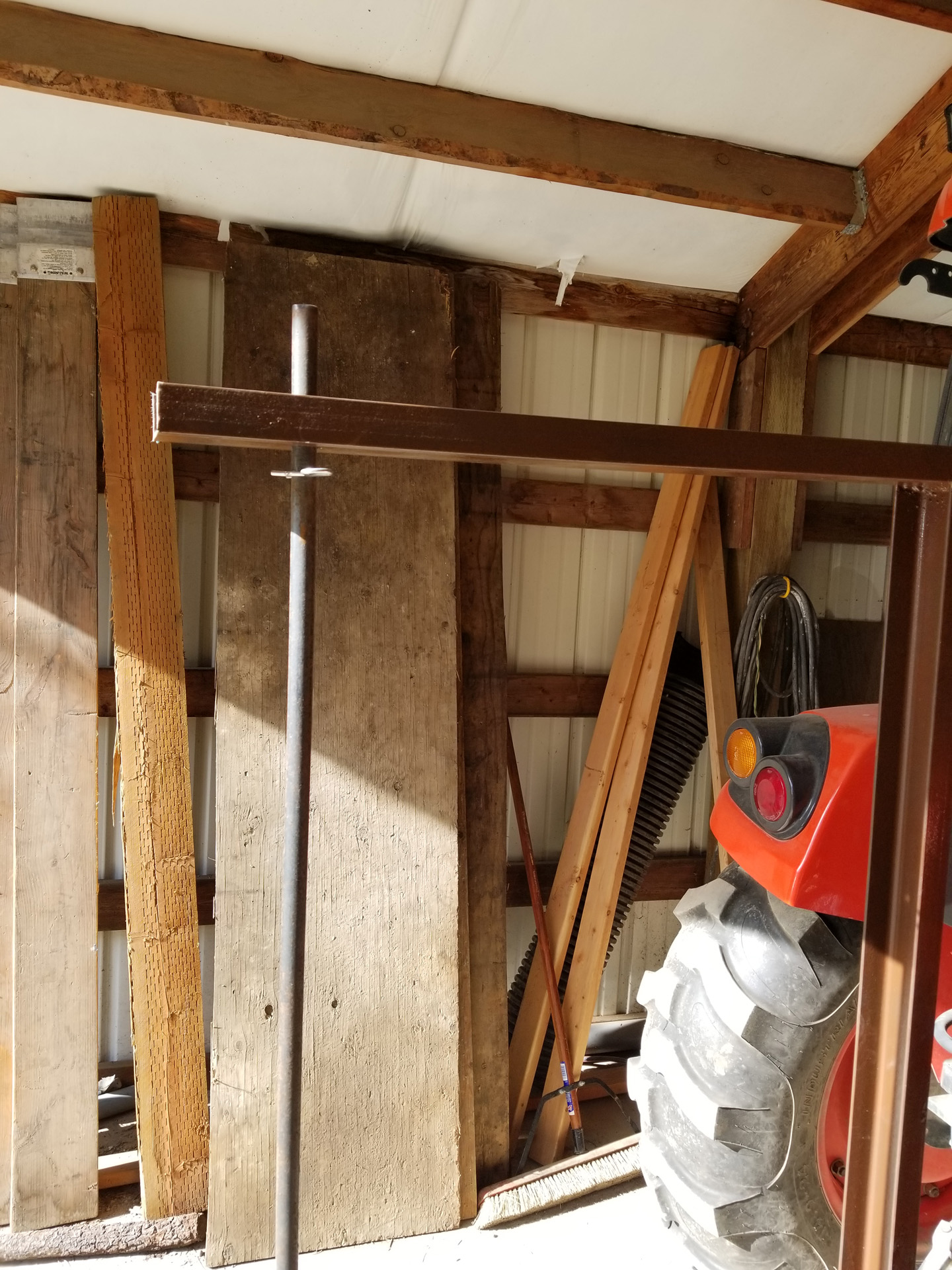

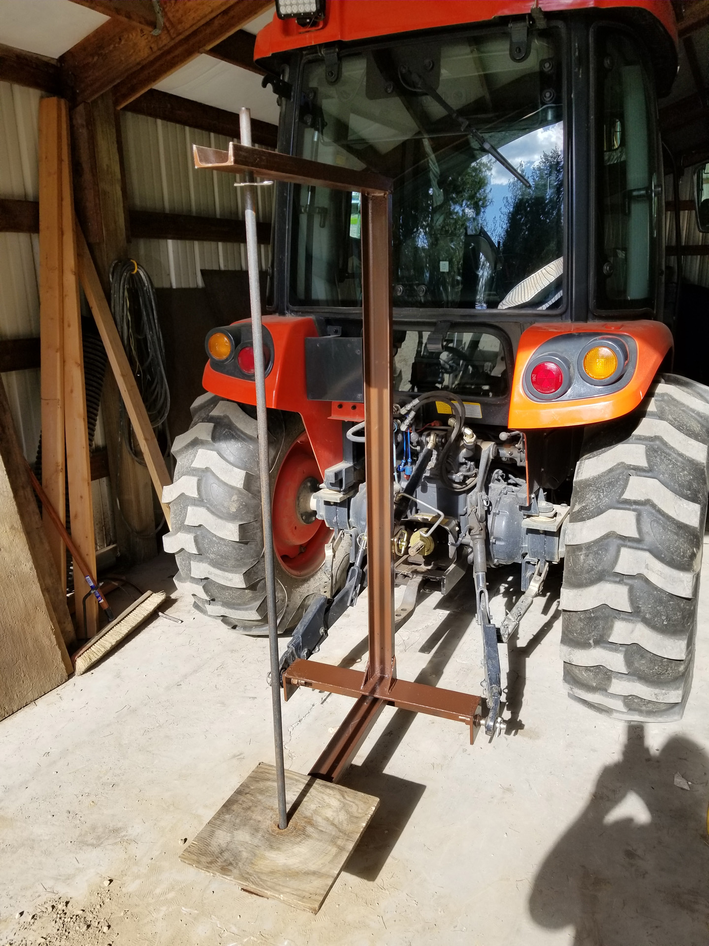

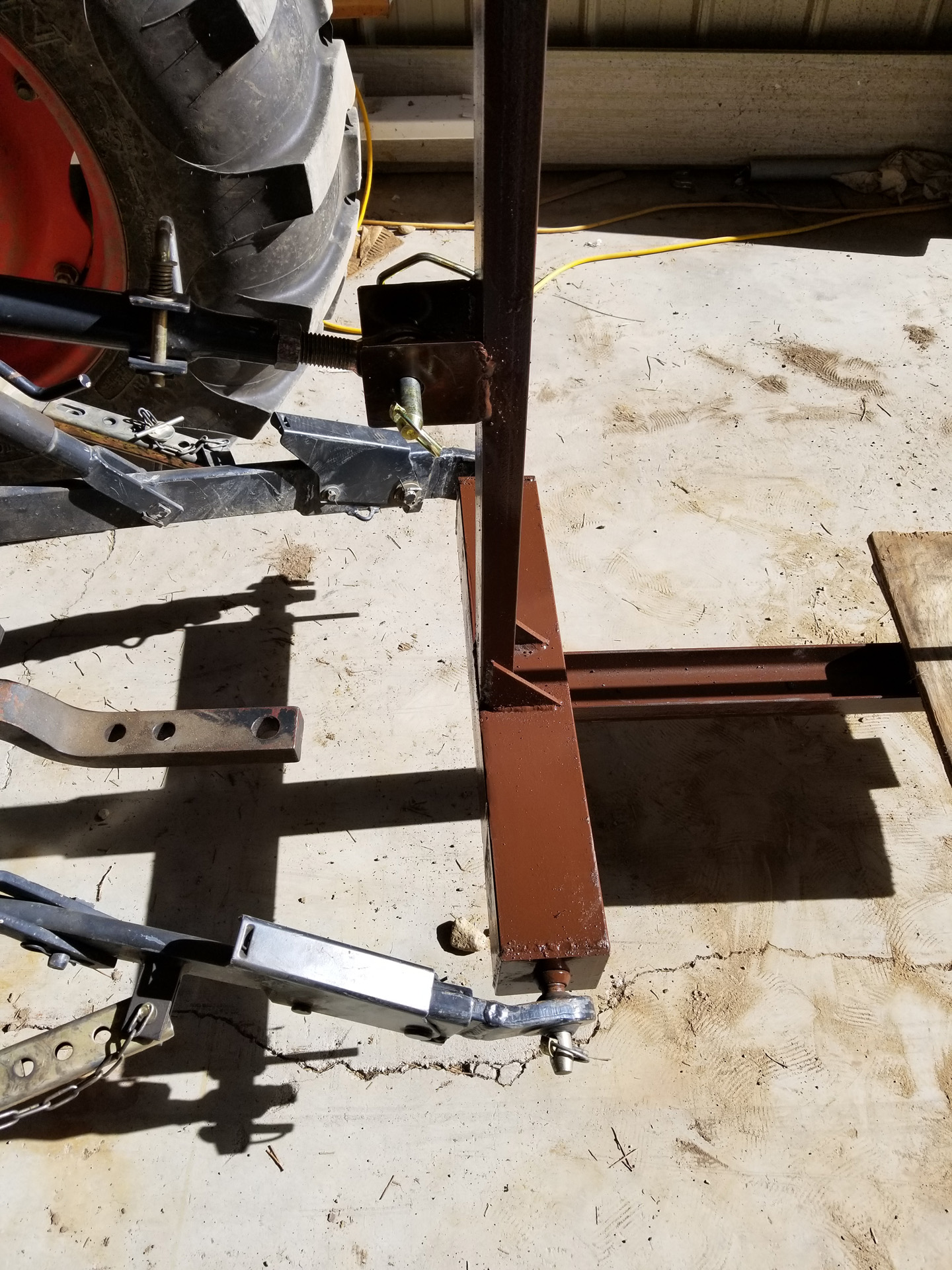

I was looking at a Field Fence unroller and stretcher unit for sale at tractor supply and another farm supply outfit locally. They were about $580.00 PLUS nearly $300 shipping fees. No way..
I decided to build my own from some scraps and a new piece of 1/4" x 3" steel channel. Total cost about $54.00 plus my time. I had most parts in stock from previous projects.
I'm not worrying about stretching the wire, as i have a clamp device that i hook to a chain from bucket to stretch wire. i only wanted a easier way to unroll 1,800 feet of horse non climb fencing than to roll on ground thru grass.
Haven't tried it yet, but should work fine. Ill post some pics of it in use later next week. 20190507_164413.jpg 20190507_164421.jpg 20190507_164431.jpg

I did the same thing, about 10 years ago. Back then, we had a local salvage dealer you could buy new steel drops for scrap price. I bought most of it for that project, but like you, a couple pieces were in the "left over from another project pile". Also had enough primer & paint left over from building fronts for my horse stalls to paint it. Total out of pocket for the new steel I bought was less than $18.00.I suppose if you would throw in gas & welding wire, and a couple other consumables, it was still less than $25.
It worked like a champ,and fence stood up, leaning against the posts. Did the stretching with oak 2 X 4's sandwiching the fence between them, and pulled it taught with one of those double dogged, 2 ton come-a-longs. That was the easy part, I'm just getting too old to wrestle those rolls of fence anymore. Fence came on a pallet, on end. Plate on the un-roller is about 1" shorter than the pallet, so they rolled right on.
