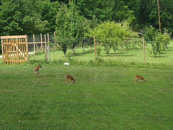

I used 8 foot game facing to deer-proof my orchard/garden area but the fencing I used doesn't keep out the raccoons and possums that have been rough on my fruit trees and grapes. It has kept the deer out, though, for the five years its been up. I think I have seen a game fencing product since that has smaller spacing along the bottom that might have been better. Right now I am planning to add some welded and woven wire that I have left over from other fencing projects along the bottom that is 1" by 2" and run a couple electric wires along the top of that to discourage climbing. I did have some success with just keeping my dog in the garden during the summer to chase off any critter that got in but she got old and ineffective and has since died.
