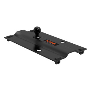

I just added another truck to serve mainly as the camper hauler (31' travel trailer). New truck is a 4wd, 2006 F350 Lariat crew cab long bed dually with 6.0 diesel (has 83k miles). My questions are there was a hole cut in the bed for a ball mount but the mount is gone. What is a good option for a hidden style hitch there? I don't own a gooseneck trailer currently but have use of 4 different trailers of various lengths.
2nd question is the truck has rails mounted for a fifth wheel hitch but no hitch came with the truck. The rails look like all my friends that have fifth wheels so are these universal? I have no plans to have a fifth wheel camper anytime soon but would like to know I can help my friends if ever needed as we go camping together often.
Yes, Your friends 5th wheel hitch should fit the rails, unless the rails are not the Industry standard.
You should inspect the mounting hardware, the under bed hardware and frame mounting brackets.
Thanks guys, I didn't know they make a gooseneck adapter for the rails. That would be perfect. Now I will just have to find a nice way to patch the hole in the bed.
The ball on a gooseneck adapter for the rails will likely be higher than the 4 different trailers are adjusted for, that you have the use of. This would only be a concern if the trailer has Torflex axles, as it needs to be level when hitched on and loaded.

Everyone is voting turnover style. And my vote would be the same if there wasnt the need for the 5'er, and already having the rails.
The biggest benefit of the underbody/turnover is not having rails in the bed. With wanting the 5'er, and already having the rails, you arent gaining the big benefit.
Agreed.
And really, oulling with an above bed gn is no problem if you adjust the drop on the trailer neck

Did you adjust the drop on the trailer neck? My 350 has a pop up ball, and the 450 has the gn adapter. Properly adjusted, I notice no difference till nearing max load, and that's because the 450 has air bag suspension, so it actually felt better even though on a gn adapter
