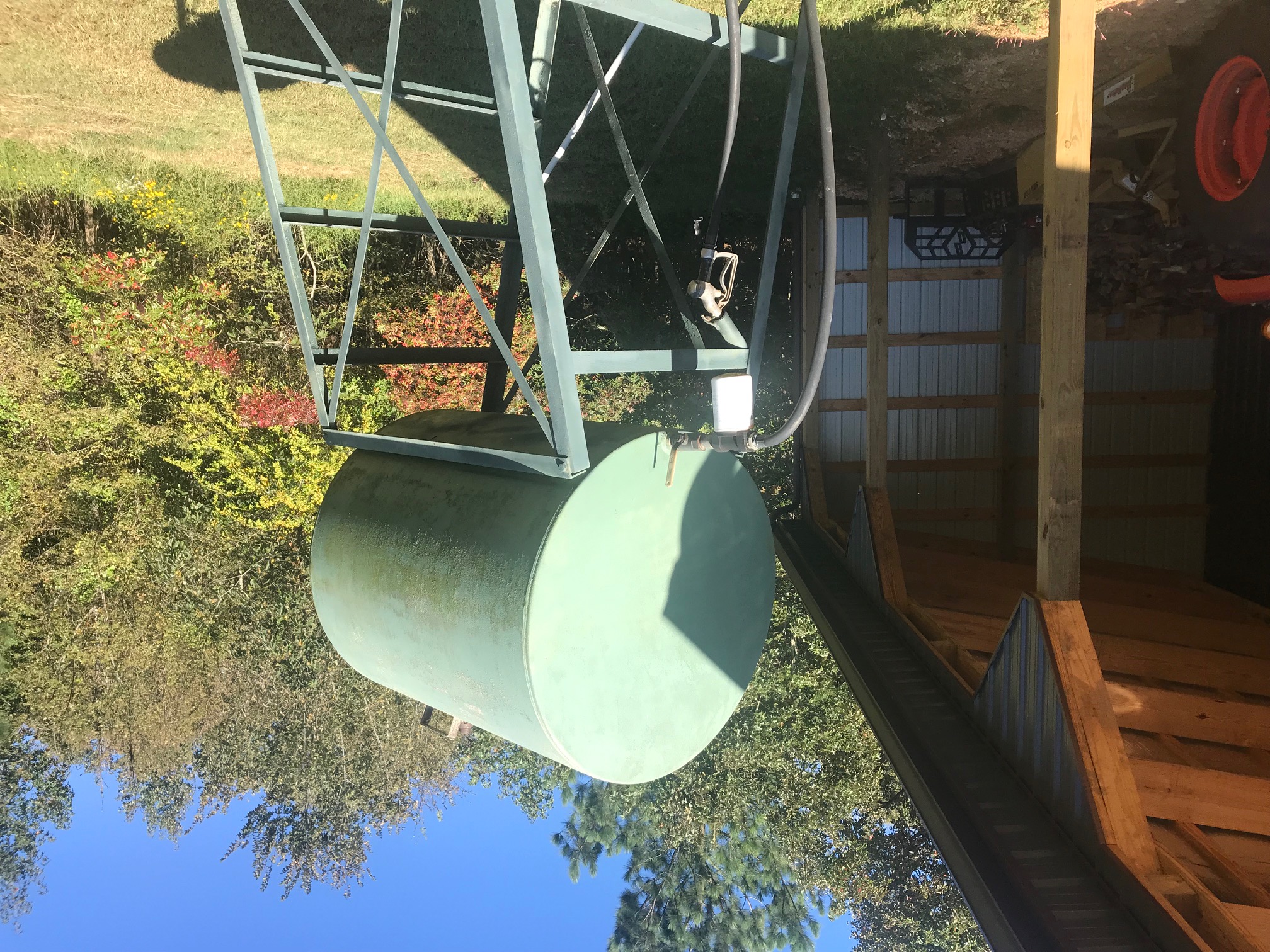

That is my plan
Blow air backwards into the tank so as to clear any debris that might block the strainer.
If that improves the situation for a while you would have confirmed the cause.
Next step would be a tank cleaning.
For that reason I always double filter my fuel when filling.
I fill from a holding tank that has a 10 micron filter on the outlet
   / Fighting what I think is a fuel issue #17
That is my plan
Bugs are good ones to block tank outlets. First, they may crawl up into your unfiltered nozzle opening and die there. Then, the next time you fill, you deposit Mr. bug right into your tank. That is why I at least shake out the nozzle before I insert it in the filler hole.
