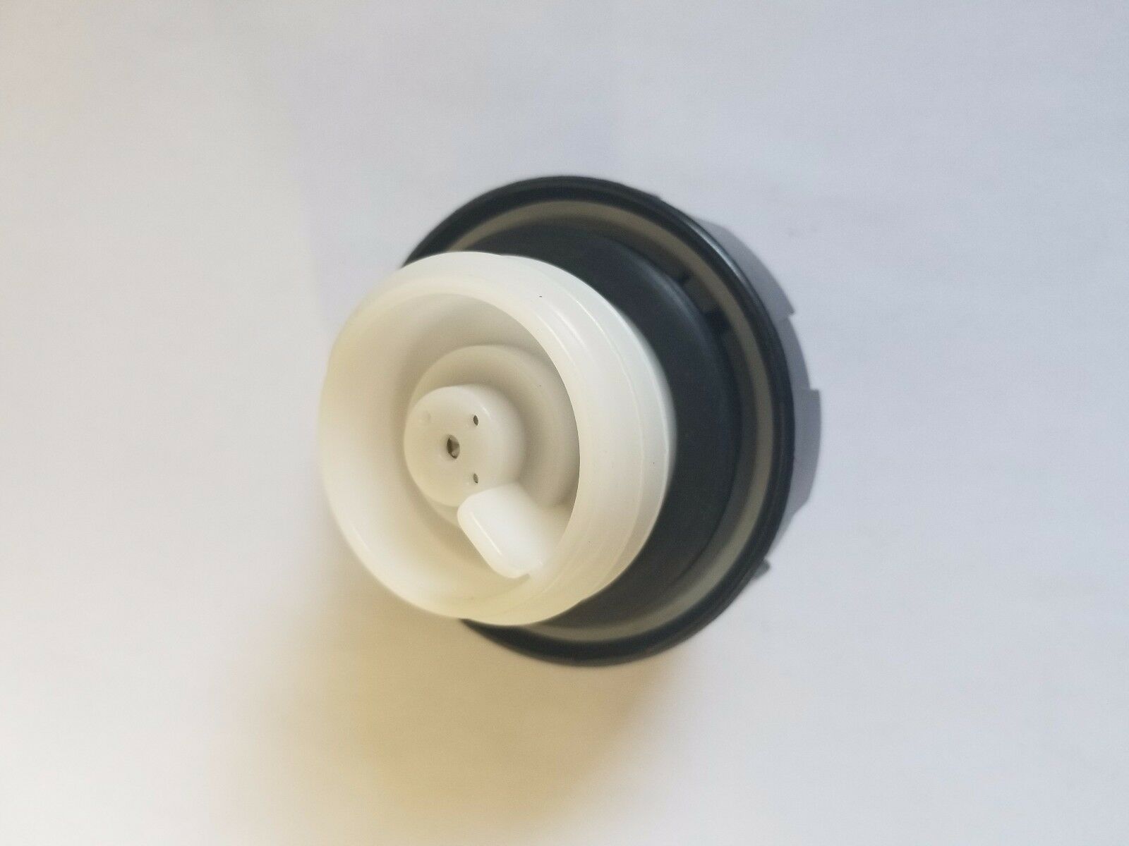

UPDATE: So I started to drain the tank this morning, had a fuel can underneath the tractor, pulled the line off the fuel pump and fuel started coming out at a nice steady stream. Over the next several minutes the stream of fuel started slowing until finally just a dribble. So I was like "hey, here is the issue, must be plugged". So I took off the fuel cap and as I started unscrewing it I hear a swoosh of air and the fuel immediately starts flowing full stream out of the fuel line and into the can. So to test that the cap indeed was not venting I screwed it back in and again after several minutes the fuel starts slowing down and after a bit it is a slow dribble again. So unscrew the cap and I hear "swoosh" and the fuel starts flowing again full force.
So, I am assuming my vented cap is not venting correctly. Anyway to clean these or is it just a new cap (probably best option) and does anyone know the part number?

Is your fuel cap vented or does your fuel tank have a vent hose?
It could be a plugged fuel tank vent line.
   / Fighting what I think is a fuel issue
#23
Looks like a vented cap, inside plastic has one large hole and 4 small holes around it.

Second Update: Been gone for awhile due to MIL passing away, but finally got back home and my new cap was here. Tried it out and still have an issue with losing power after 1/2 - 1 hour of use. So I drained the tank and flushed it out. Good fuel flow from tank. Took the fuel pump off and pulled the plate to inspect for stuck debris or a tear in the diaphragms. Everything looked OK, but now when I start it the problem is worse. With tractor sitting and just running the rpm's up to 2000 it starts to falter after about 20 seconds and then just dies. Give it a few seconds and starts right up. So I took the fuel line off where it goes into the fuel filter and cranked the engine, hardly anything came out. Is this a valid test to see if the fuel pump is pumping correctly??
Thanks
   / Fighting what I think is a fuel issue #27
That test tells you have little fuel flow. The pump could be fine and there is a restriction upstream. Take both air lines off and see if you can blow air into the outlet.

After flushing the tank I checked the fuel flow to the pump, it was fine. Checked it again when I saw the pump outlet flow was not good and still had good gravity feed flow from tank.
   / Fighting what I think is a fuel issue #30
I would say a new lift pump is in order. They don't seem to bad at about $60.
