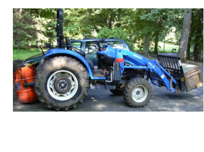

I do all three:
Tires loaded with washer fluid
EZ Weights with 400lbs plate
55Gal barrel filled with bluestone gravel
See attached picture: This is my rig for doing oak firewood on pallets. With about 1/2 cord of oak, you need ALL the weight!
Mark
