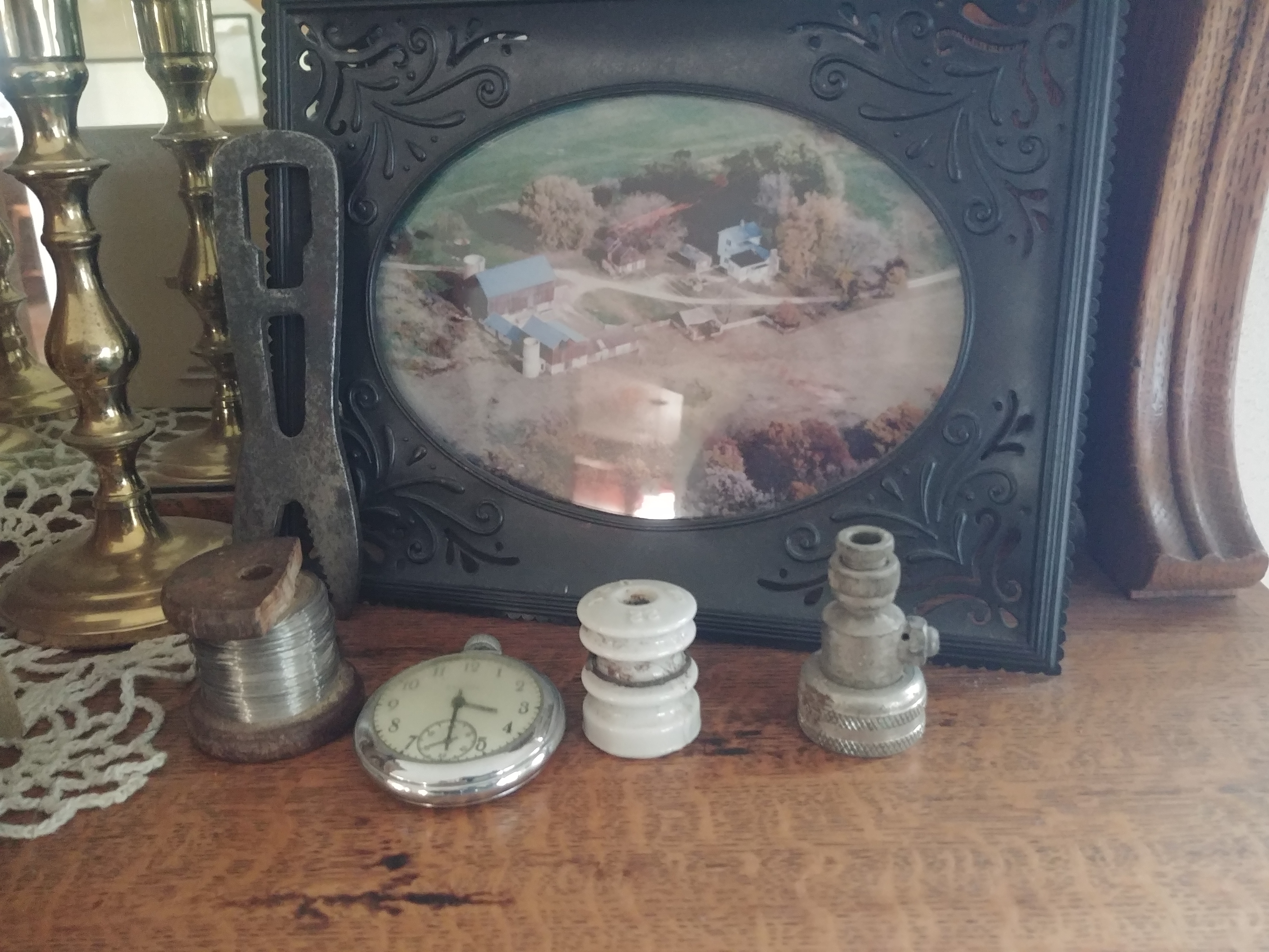

Filling tires with ballast must be as old as rubber tires. The fitting used to fill the Deere 1939A sits along with other tools of the trade.
