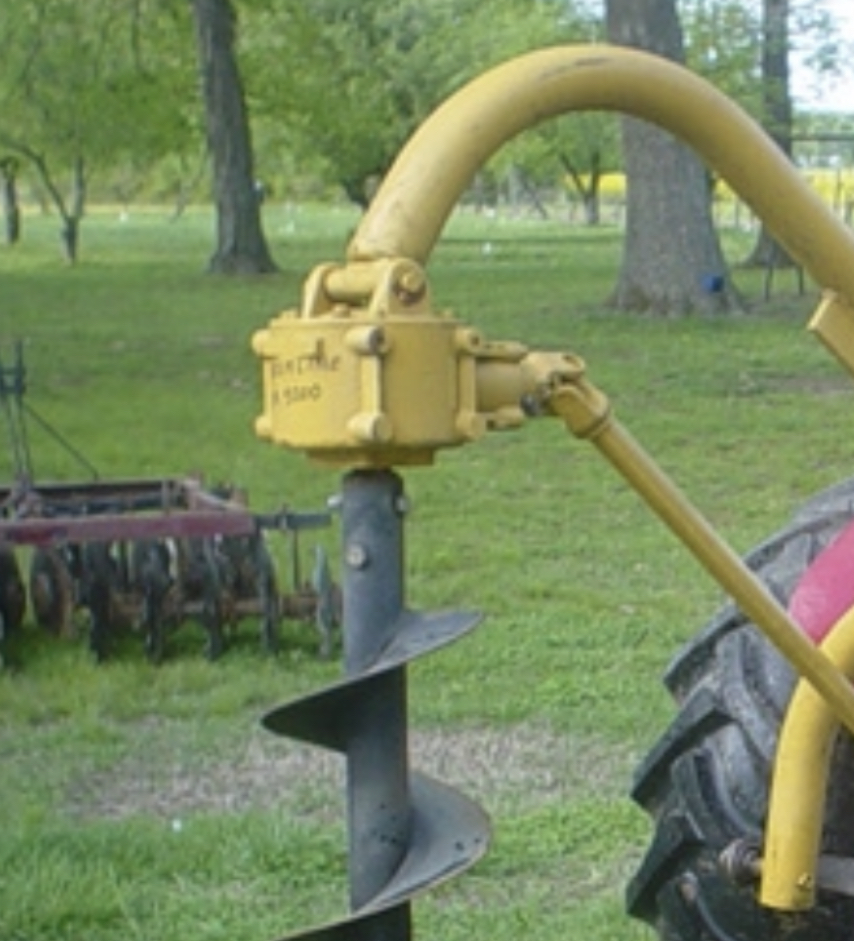

Do you have a picture of it?
I am envisioning something like this:
If it is similar why would you need to dismantle the gear box or take it to a machine shop to make it accept a larger bolt? Just put the auger on, stick it in the ground a little bit to stabilize it, remove the 7/16 bolt, run a 1/2 drill bit through both the auger and shank at the same time, then run a 9/16? then a 5/8? and so on however big you want to go. Taking 1/16 at a time should be pretty easy drilling with a hand drill.
If you want to go the carbon rod route they work good too I have used them but if you tore up the 7/16 bolts you had what is going to be different going forward?

My gearbox is pumpkin-shaped. I hadn't thought of stabilizing the shaft by drilling the auger into the ground--Duh!, but that should work. If I could gradually increase the hole size to 3/4" , I could use cat 1 top link pins which are everywhere around my little farm.
