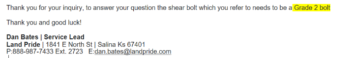

I spent hours trying to verify I had the correct pins when I bought it. the manual specified the following (I have the 15 series):
So the Drive shaft (auger) bolt was straight forward. Grade 5, 1/4x1" bolt. I attach it using a nylock nut
The Drive line was a mystery to me. Here is the bolt head that came out of it when it sheared last year:
I am thinking that since it was painted black (same color as the drive shaft, it was probably original. While the blower was bought used, it was only used for one season on a paved driveway.
I could not for the life of me find a Grade 6.8, and C1.6.6 is a specification that I had never heard of. I did some internet searches and talked to buddies and came up dry. I went to my Kubota deal (a Land Pride reseller) and they could not tell me definitively what the bolt grade was, and they did not have any in stock.
My friend reached out to the dealer via email, and got the following reply:
So grade 2 is what I am using.
