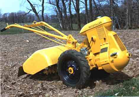

They remind me of the time I was rebuilding the Edison-Spidorf magneto on my old Rototiller brand 2 cycle rototiller. The mag was as large or larger than you would expect to find on a full size tractor. The tiller had a huge spark plug that would fire even when it was totally oiled up. I think it ran a 20-1 mixture.
I didn't realize that there was a spring loaded cam in the mag to allow it to generate a spark at very low cranking speeds. I tried to twist the shaft to set the points and it felt like it was bound up. :confused::confused:
I put a lot of extra force on it and I got it to move. When it did it snapped over center and gave me a jolt like I have never before experienced. I had a small garage at the time and I am sure I bounced off all 4 walls and possibly the loft before I could even utter a sound.
I put the mag back on the tiller and never touched it again....:cool:
