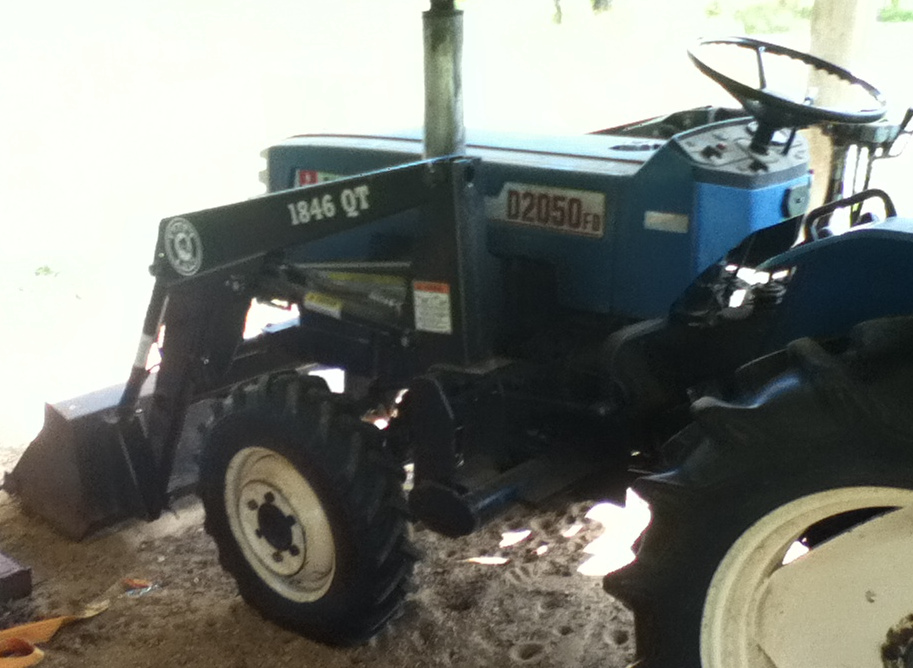

Is your tractor designated correctly?
tractordata.com shows "NO RESULTS" FOR Mitsubishi FD2020.
We cannot make useful recommendations without knowing what implements your tractor is capable of pulling.

Well spotted, its actually a FD2050...at least that's what it says on the tractor...it's gray market...but that doesn't appear on tractordata.com either...
