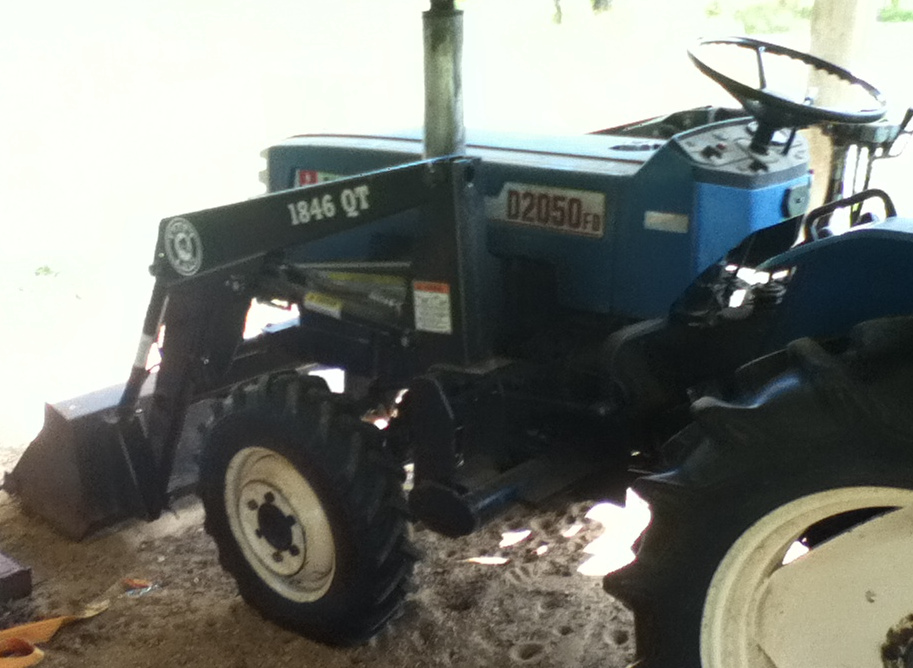

Well spotted, its actually a FD2050...at least that's what it says on the tractor...it's gray market...but that doesn't appear on tractordata.com either...
According to T-B-N archive posts FD2050 is approximately equivalent to a Kubota 'B' series or a John Deere 790.
Does it have 4-WD? FEL, which affects 4-WD traction?
T-B-N ARCHIVE: Google
With 4-WD it should pull a 54" wide or 60" wide Box Blade, nothing wider. Your tractor likely has turnbuckle Lower Link stabilizers rather than solid Lower Link stabilizers. This means tractor will have to cross holes before Box Blade can be raised to allow dirt to deposit in holes. NO PUSHING WITH THE BOX BLADE.
