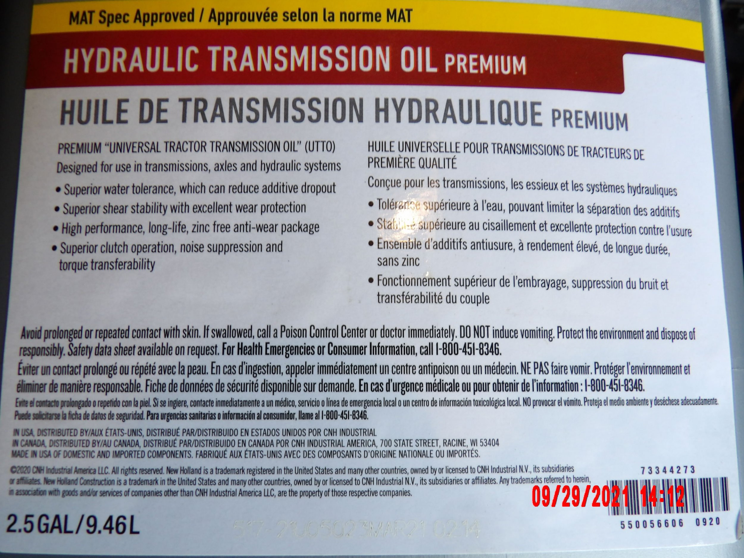

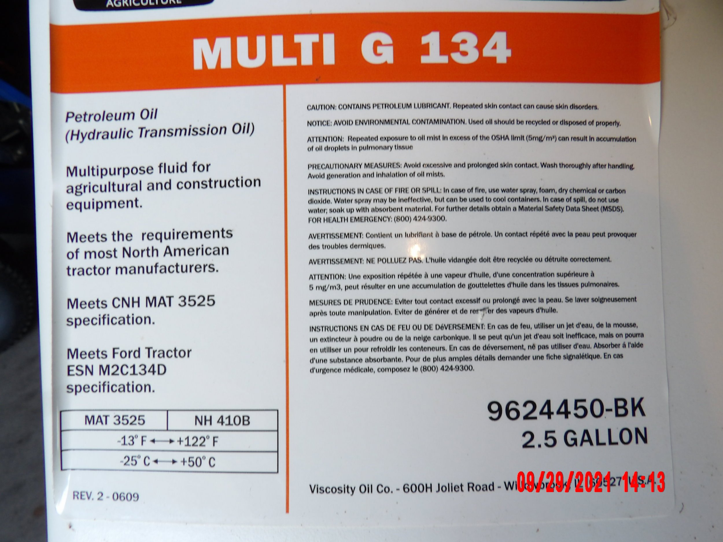

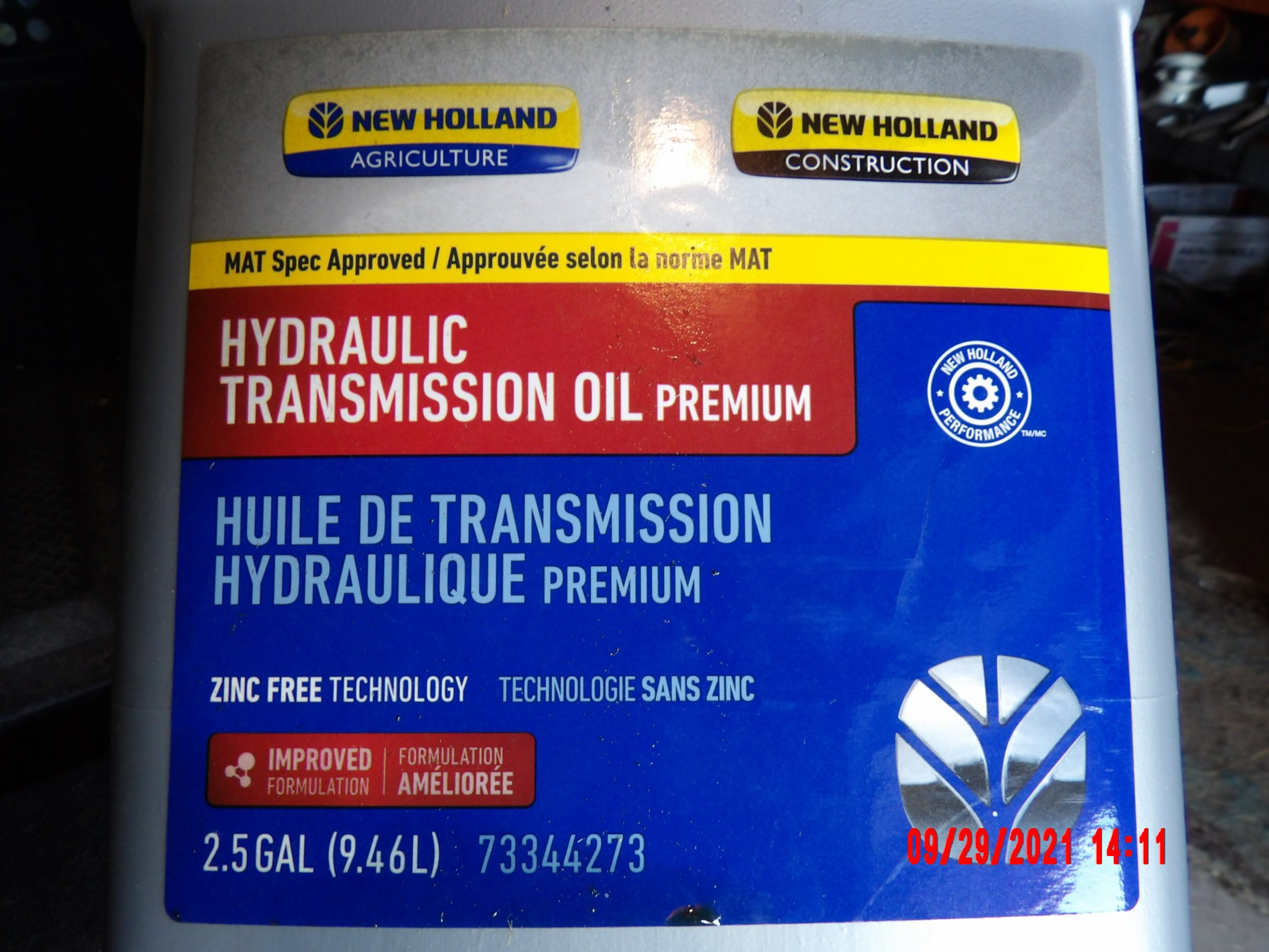

There are 2 filters for the T1510. One is smaller called the Hydro filter and the second is larger and called the hydraulic filter. Your dealer should have the larger in stock as it is used by numerous NH's. The smaller may be an order item. There have been different part numbers assigned to each and your parts person should be able to sort it out.
As far as fluid, I changed the fluid in my TC 33D last month and needed about 8 gallons. He did not have an adequate supply of 134 and sold the newer NH fluid as a replacement. See below photos. Used the newer fluid and noted a slight improvement in cold response and less tranny whine.

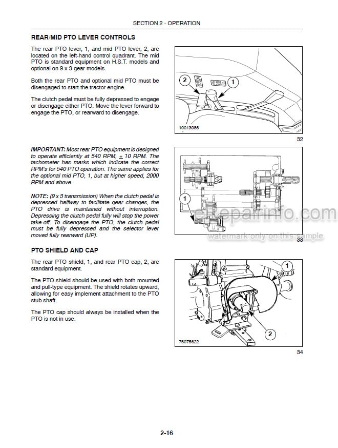

/ Filter and Fluid Change #6
Op Manual on eBay: Holland T1510 Tractor Operator Manual 87711641 for sale online | eBay
or download:
And Service Manual on eBay: New Holland T1510,T1520 Tractor Service Repair Manual 754133509151 | eBay
or download:
*Use the download sites at your own risk and I suggest using privacy.com or paypal if you do.

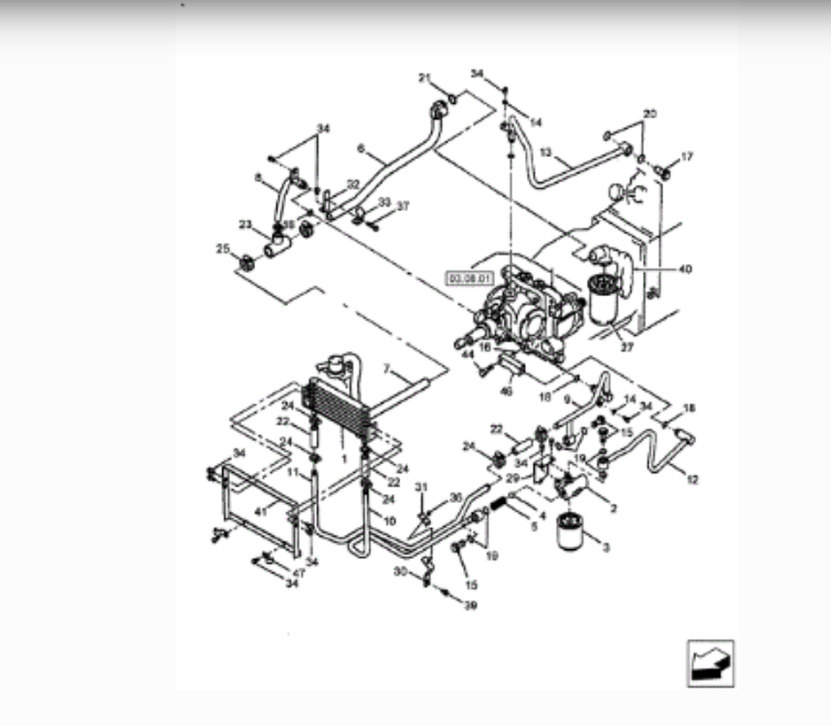

I looked everywhere on this T1510 and all I found was the filter that’s under the seat behind the right rear tire and the oil filter on the right side of the engine. Took some pics.
I think this is what I have #4. Hydraulic oil filter.

Also. it calls for 134 fluid but can't find any local. I did find some THF 1000 Chevron which they told me will work in the tractor. Can any of you confirm this?
Chevron THF synthetic fluid is what I use in my big tractors. It exceeds all manufacturers specs. It ain't cheap but quality never is.
#13
Thanks. NH 134 is almost $100 per 5 gallon container and I can get Chevron THF 1000 for $70. Just wanted to make sure it was compatible with what NH recommends.
