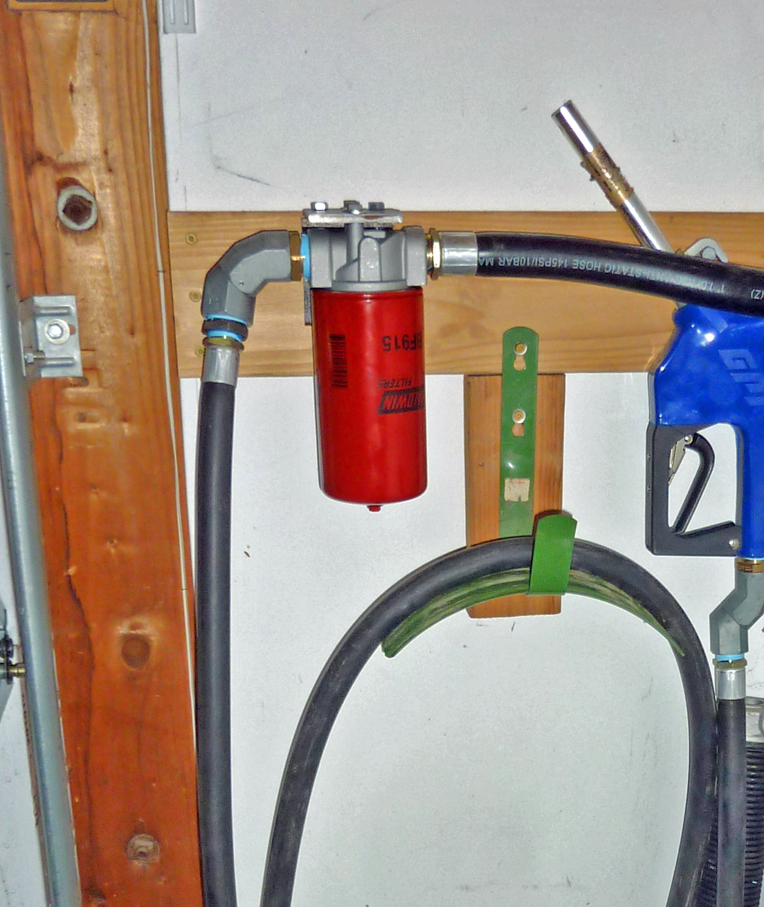

Looks good but I have an electric pump with hoses.... I guess it could be hard plumbed in (y) and a filter added like you show. OR maybe I should just break down and buy the rotary pump. Argh
I'd stay with the electric.
Not much needed.
Nipples and maybe a reducing bushing or 2
I would go with a filter housing for 1" filters.
I have a few 3/4" filters, but have trouble finding the 3/4 npt filters now and am switching to 1".
   / Filter for diesel storage tank #22
You are correct. I assumed 15gpm was too high a flow to filter down to 2u. CimTek seems to make a 2u water absorbing filter that can handle 25gpm. I'm going to check if the filter height will fit where I need it.
I run with a 5 - 30 micron filter first and then into the 2 micron and then to the hose.
Seems to let the 2 micron last a very long time.
I'm switching to 1" filters because I have trouble finding the 3/4" filters anymore.
The filters are the same other than the threaded hole.

Which unit are you recommending? Do you have a link? Thank you
   / Filter for diesel storage tank #24
This is where I order from.
Scroll down to see the filters.
I would get 1" filter and housing as I've had trouble finding what I want in the 3/4"

I use a 10 micron water blocking filter on my transfer tank. It's a Goldenrod spin on and head available at TSC or Amazon.
The headache that the water blocking filter saves more than offsets the cost.
   / Filter for diesel storage tank #26
That's why I start with that and finish with a 2 micron

I also worry about water separation with my fueling rig:
I've been burn heating oil as well for over 30 years though and have never had a problem. I have the suction pipe mounted 6" above the bottom of a 1000 gal tank and as a precaution, never draw fuel immediately after a delivery. I open the drain valve on the tank bottom a couple of times a year to check and have never seen any water.
I know I could get a bad batch of fuel at some point though so I may modify the rig to add a water separator. I like the Goldenrod but it has no mounting holes to attach it to a wall. I'd have to weld a couple of plates to 1" pipe nipples to mount it. I know this product is available but the filter is also the anchor point for the filler hose and it doesn't look strong enough to handle the strain:

I do believe water separation and particulate filtering are important, more so with common rail high pressure fuel systems.
I was also not too keen on the very small water separator / strainer on my tractor, so I replaced it with a Racor 2 micron water separating filter. Generally a 2u filter should be secondary in a system, but so far the 2u filter is doing well. I installed a vacuum gauge to closely monitor the filter, and worst case I can swap the canister with a 10u element.
