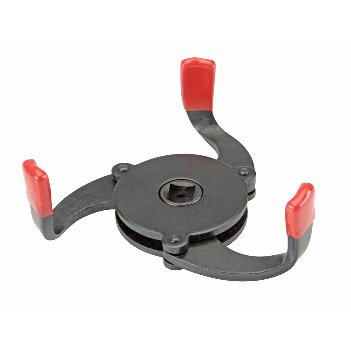

I have always had good luck getting hard to remove filters off with this version.

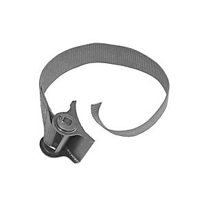

Foe what it's worth, this is what the too I tried looks like. I've tried it 2x now and it's failed both times only resulting in a crushed filter.
CTA Strap-Type Oil Filter Wrench | Tire Details | Pep Boys

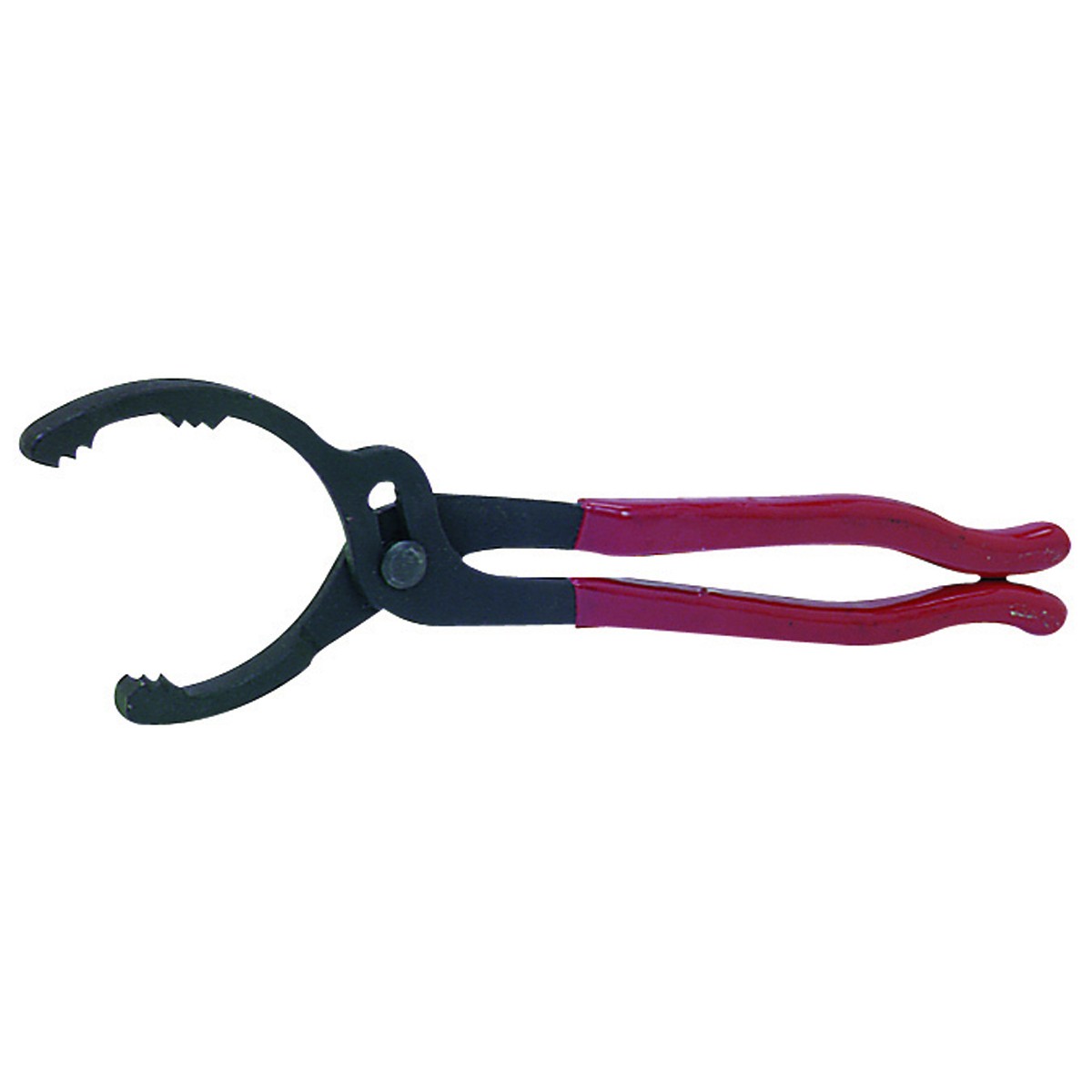

I wouldn't waste my money on that strap. Likelyhood of getting it into position to use on most oil filters is pretty slim and getting that strap to hold would be another issue. A chain type strap wrench or the HF oil filter pliers works or even the band type although I did bend my band type handle taking off one of my hydraulic filters. It did release but only have crunching the handle.

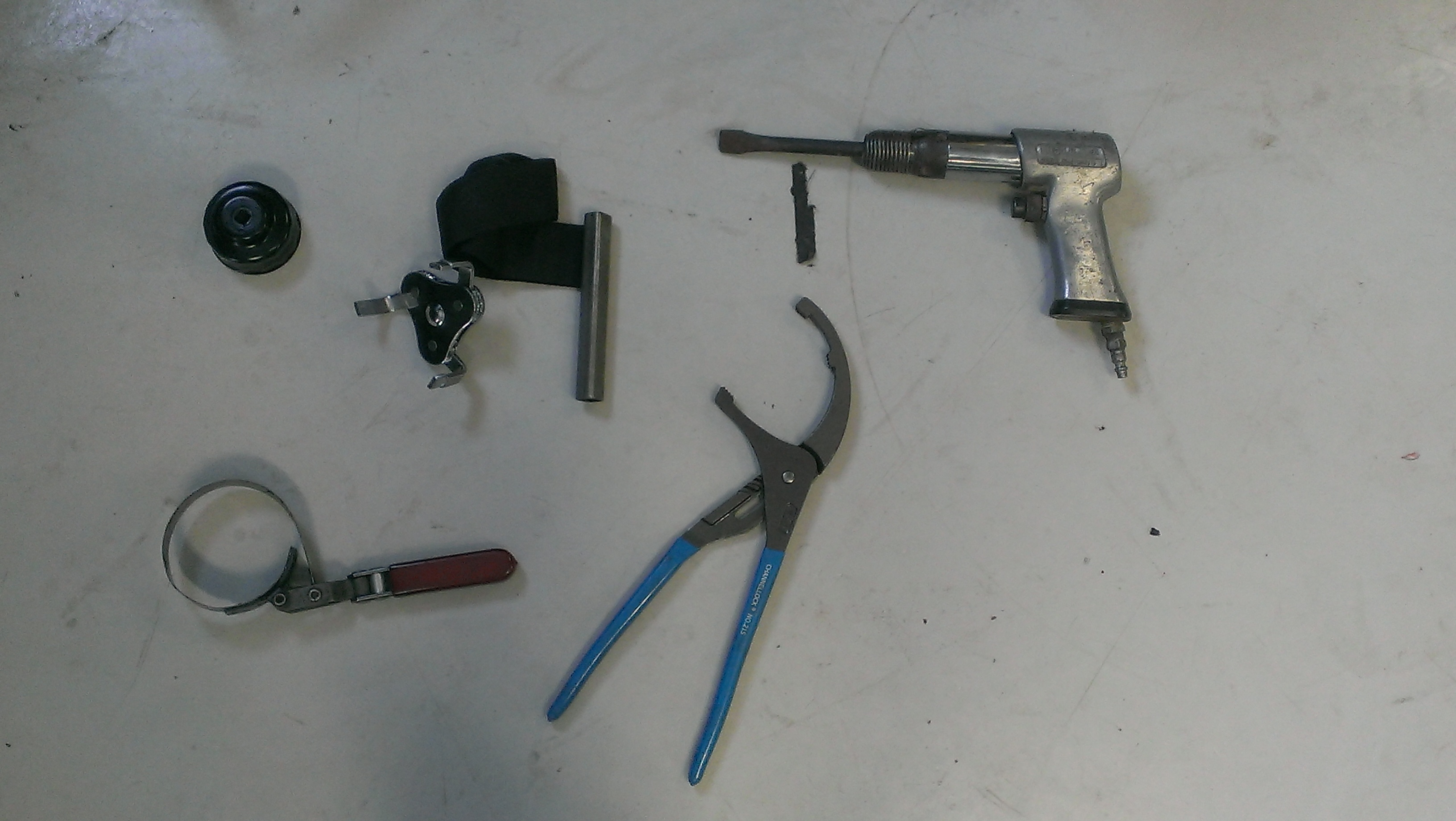

/ Filter removal without a gorilla #30

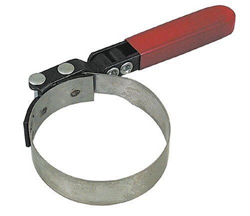

Never had much luck with the screw driver through the filter. If it is stuck enough that you have to jam a screw driver through it most of the time you will destroy the filter before it comes off. The chain wrench works, but it collapses the filter half the time and you need a lot of room to swing it. The pic has what i could find in the tool box. I have a band wrench similar to the band wrench with the handle for really larger filters, but a 1/2 in extension fits in it and you can use a 1/2 inch breaker bar, that works the best. Can't seam to find it, chances are the kids got it. Don't you hate that:yell: The impact is there for when you destroy it with the screw driver and have to knock it around to remove it. The small black socket is slick fits right over the filter, can snug up the filter slips off before it get to tight. Not going to help now. The silver one with the fingers works well on the smaller filters

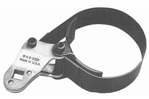

Found a pic, they are not cheap. They work the best.
The one I have is wider for the large hydraulic and truck oil filters. Just asked the kid he knows nothing about it.

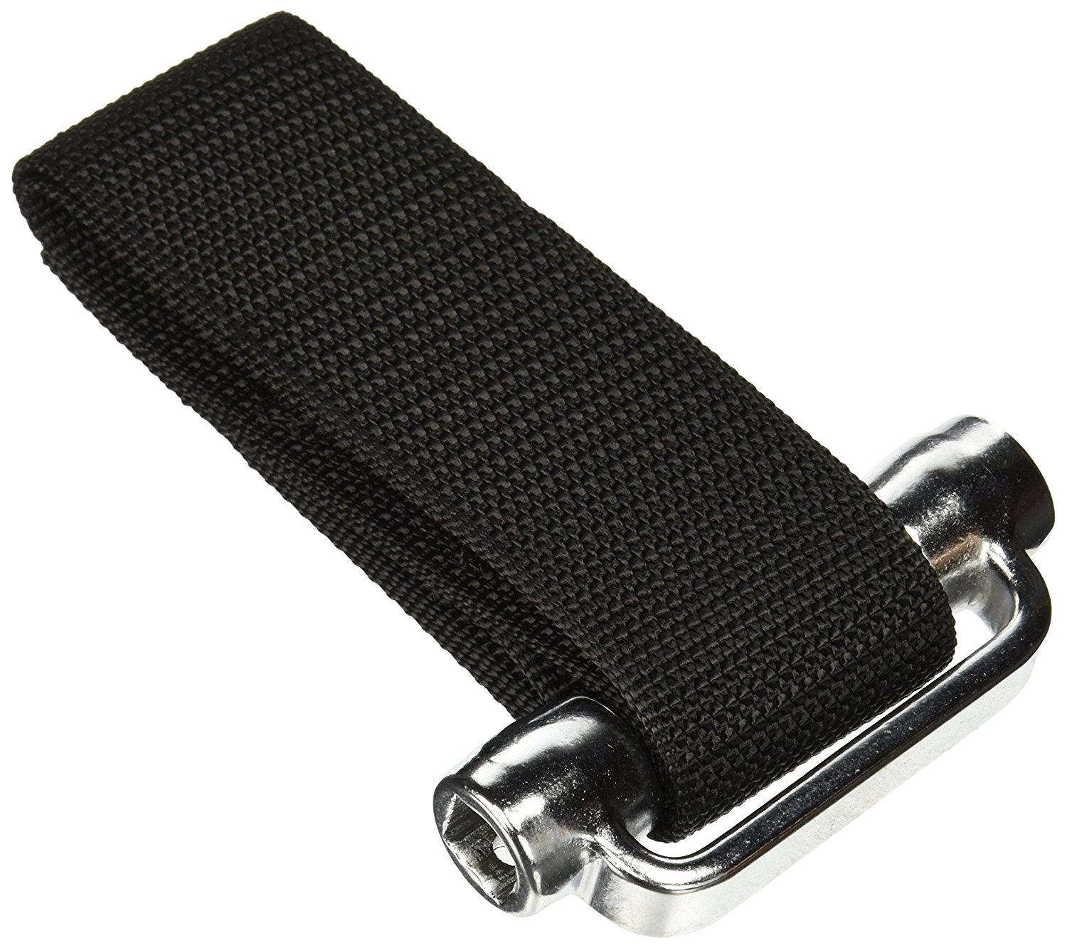

I was going to change my filters this evening when I ran into a somewhat expected snag. NH hires gorillas to install their filters! I assume the oil filter wasn't lubricated and is locked in place. I tried my Orielly filter strap wrench (connects to a 1/2" wrench) but only got a few degrees of rotation before having clearance issues. I don't have a filter socket, but after using a strap, I'm pretty sure it's too buggered up for that. I know about pliers but have heard they can destroy the filter potentially before completely removed. Any suggestions?
