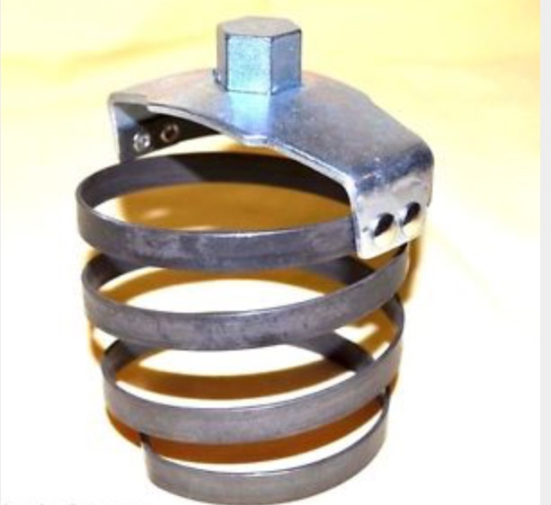

Here is another style that works real good if you have room to use them.
   / Filter removal without a gorilla #33
That spring-coil version looks like a great idea. I've never seen one until just now. And it can be used for removal only, not for filter install - which is a good thing.
