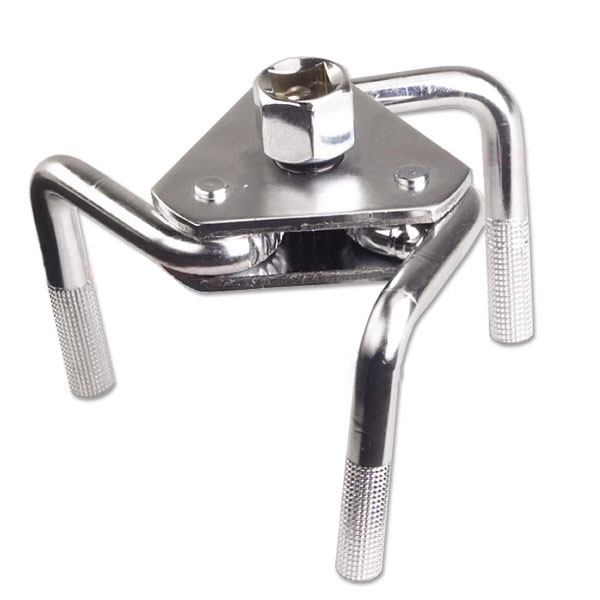

Their is a cam acting clamp that locks on to the oil filter from the botom. It is all steel, turned with a half inch drive ratchit. I can't remember were I got it, but I had to get it when I was in your situation. It has never failed. Some times I have to use a pice of pipe on the ratchit, it's on so tight, but it comes off.
I think you mean one of these..
I had a bought the black one at a local store, but it didnt tighten down enough for a quite small filter.. I borrowed (and later bought on ebay) the silver one that will go just a little smaller because the 'fingers' are thicker. The silver filter was made by OTC prod #4568
brian
brian
I got one of these about like the black one
works great on my BX filters.
Only complaint is they aren't bi directional.
