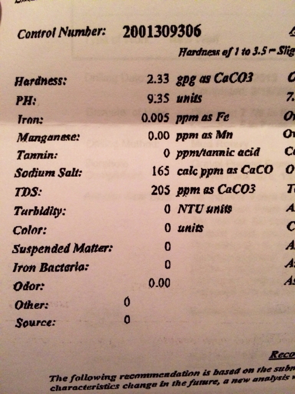

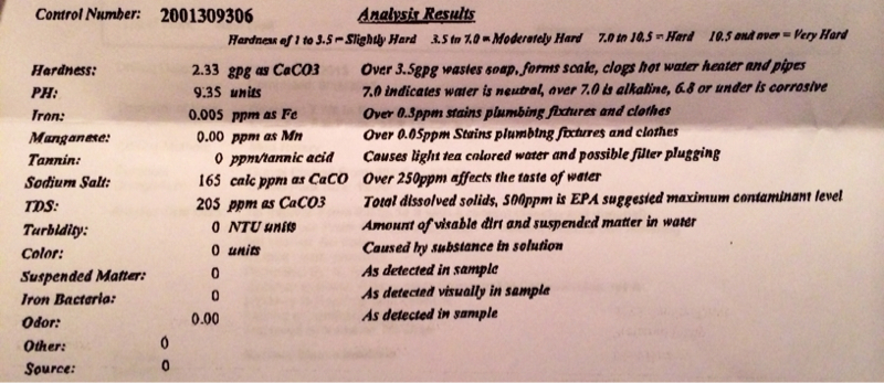

Just got the water report in the mail from our driller. Looks very good.
I don't think we will need much filtration of any kind at all, thank goodness!
Hope you can read these pics okay from my phone.

Looks like the water is up in the Basic Range (Alkaline) the hardness shows some dissolved material in it so may end up with some scale maybe a bit of slippery/slimy feeling. Might could use of some of the 20 Mule Team Borax soap for cleaning clothing.
Rest looks pretty good...
Mark
