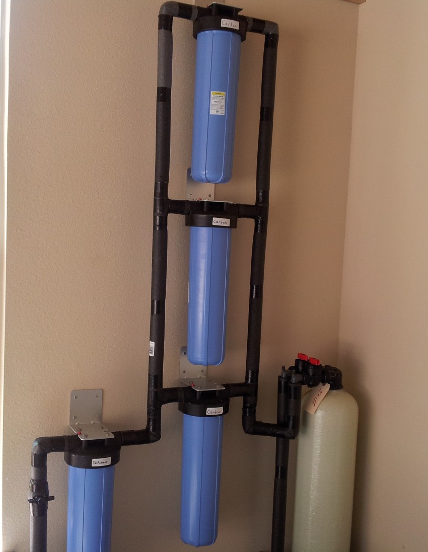

We recently had a deep well drilled here in East Texas for our new home. It's drilled 700 feet deep and I think the pump is hung around 580'? I could be wrong there, I don't remember.
My well guy says I don't need to filter any of the water for sediment or contaminants, but he's also a classic East Texas "good ole' boy", ha!
The biggest concern I have when considering filtration is water flow. Our pump will do 15gpm feed from a 1.25" line into our 1" line at the house.
I have looked at the Aquasana Rhino system, as it seems to have all the parts I've been thinking we would need:
- Sediment filtration
- Contaminant filtration (carbon and copper-zinc filters)
- UV filtration
I've tasted the water and it's VERY good and clean. I'm waiting to get back the testing report from the well driller to see the report.
What do any of you use out there to filter a deep well, while still keeping good flow?
Thanks
I soften for but do not filter mine.. I dont have 'hard' water per say, but do have iron and iron bacteria (leaves the rust stains if not ran through the softener)
But, if the test comes back good, I would think the most you would need to do is a standard string-wound 'sediment' filter. No need to UV bugs that arent there :) Instead of using one large filter, I would split the line into 2 parallel ones and one use 2. You can run 2 of the standard 12gpm slightly smaller ones together, or better, 2 24gpm ones that are more than your flow rate and alternate. That way you can bypass one while changing filters and not have to shut off the water.
Heres a 4 filter system with 3 in parallel..
Thanks! This was the basic set up that I have had in mind - a parallel system for the sediment filters.

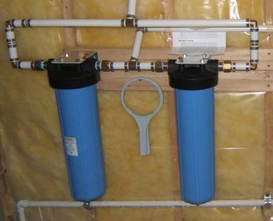

I use 5 micron string-wound filters for iron sediment. It is a simple in-out water flow. I change the filter about every 3 months. The whole filter unit costs around $40, the replacement elements run about $4-$6 each.
I don't notice any problem with flow which I think depends more on the pump than the depth of the well--assuming you have the correct pump for the well depth, adding a simple filter won't change much.
I would recommending the Big Blue canister with 10" x 4" filters.. I had the smaller filters and IF you have issues they clog up faster
I found that H2o Splash is a great place for housings and filters. I am currently using the 'washable' filters they sell.
