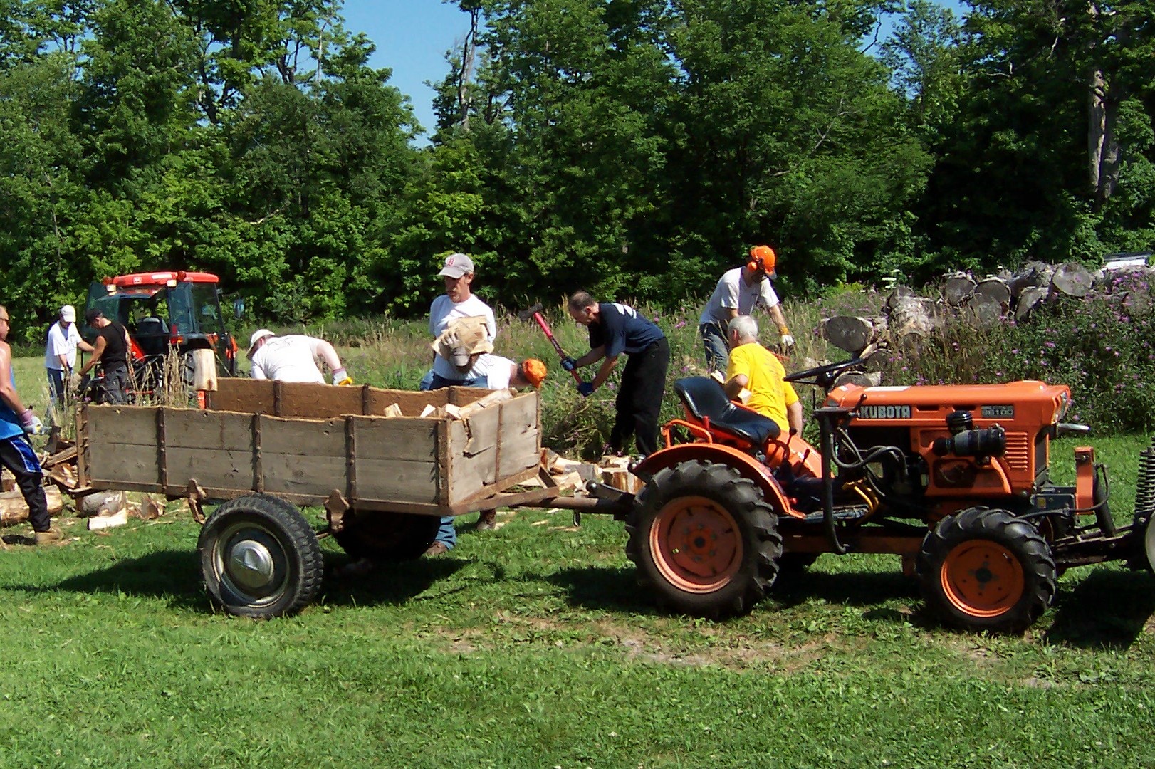

What a great little tractor. I bought a B6100 a few years ago and am amazed at what it will do. I'm sure you'll really happy with yours. Good luck.

If the mower deck will allow, you may want to widen the rear tire track width. Since you don't have a ROPS, the added stability would be comforting.

Notice how in rpraymond's picture above the rear hubs are turned around too. My manual doesn't mention it but mine are like that and I think it gets you a slightly wider stance.

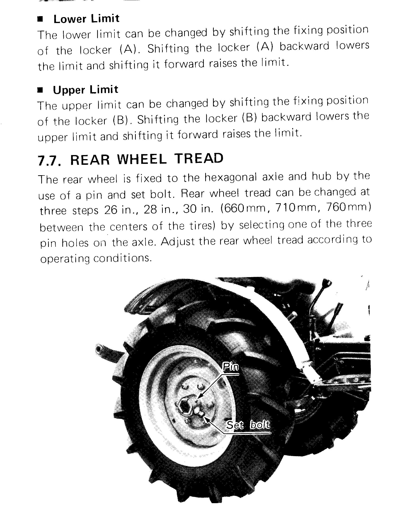

Here is the only info in the owners manual about rear wheel adjustment. If you would like any other info from the manual let me know. If it is too hard to read I'll try again.

Thanks for page form the manual.
I have the 3 holes in line on the axle and 1 hole that is rotated. The hole is between the furthest outside hole and 2nd from the outside. With the wheels flipped, this hole keeps the end of the axle almost flush with the end of the hub. Should I be using this hole or sticking with the 3 standard holes?
Maybe it doesn't matter. I just didn't want to do something unsafe.
