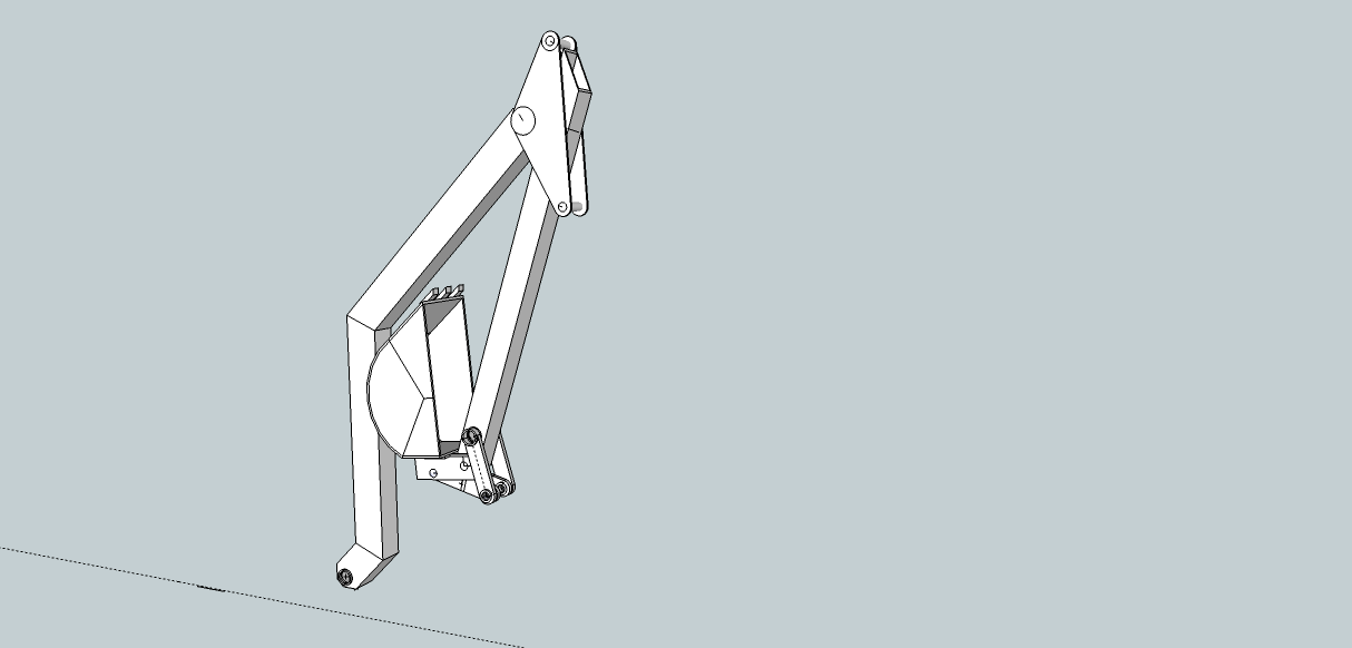

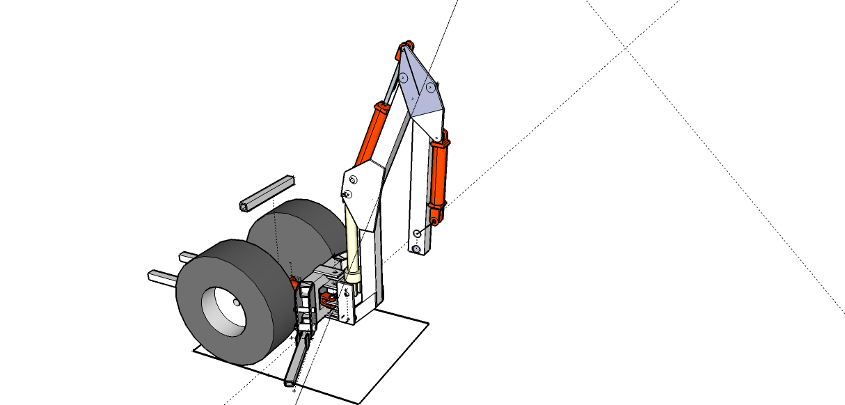

If I were on some kind of timeline to get the backhoe done or if I had nothing else to do without having the right drill bit, it might be more frustrating. The funny part to me is that it is VERY obvious that no 1" drill bit could fit in that box that's marked as a 1" bit. I'm pretty sure they'll tell me to keep the 9/16". If they want to send a shipping label, though, they're entitled to get it back.
jd2305cd said:
Got a sketch of what you going for, just curious....
I have several unfinished sketches. Everytime I get a new part or a new idea, I start the sketch over. Here are 2D shots of the two that I'm working from. There are many flaws in the design still that I'm well aware of, but anyone feel free to chime in with suggestions. I got to the point where I need to start building so I can sort out the issues in real space.
We had a very helpful discussion last year as I was in the early stages of designing...
http://www.tractorbynet.com/forums/build-yourself/138284-backhoe-design-ideas.html
