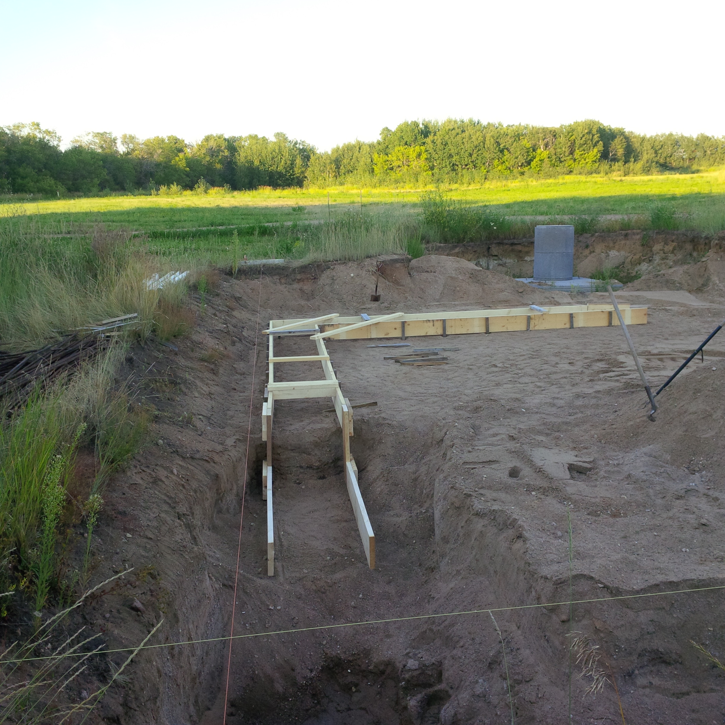

Hello to all,

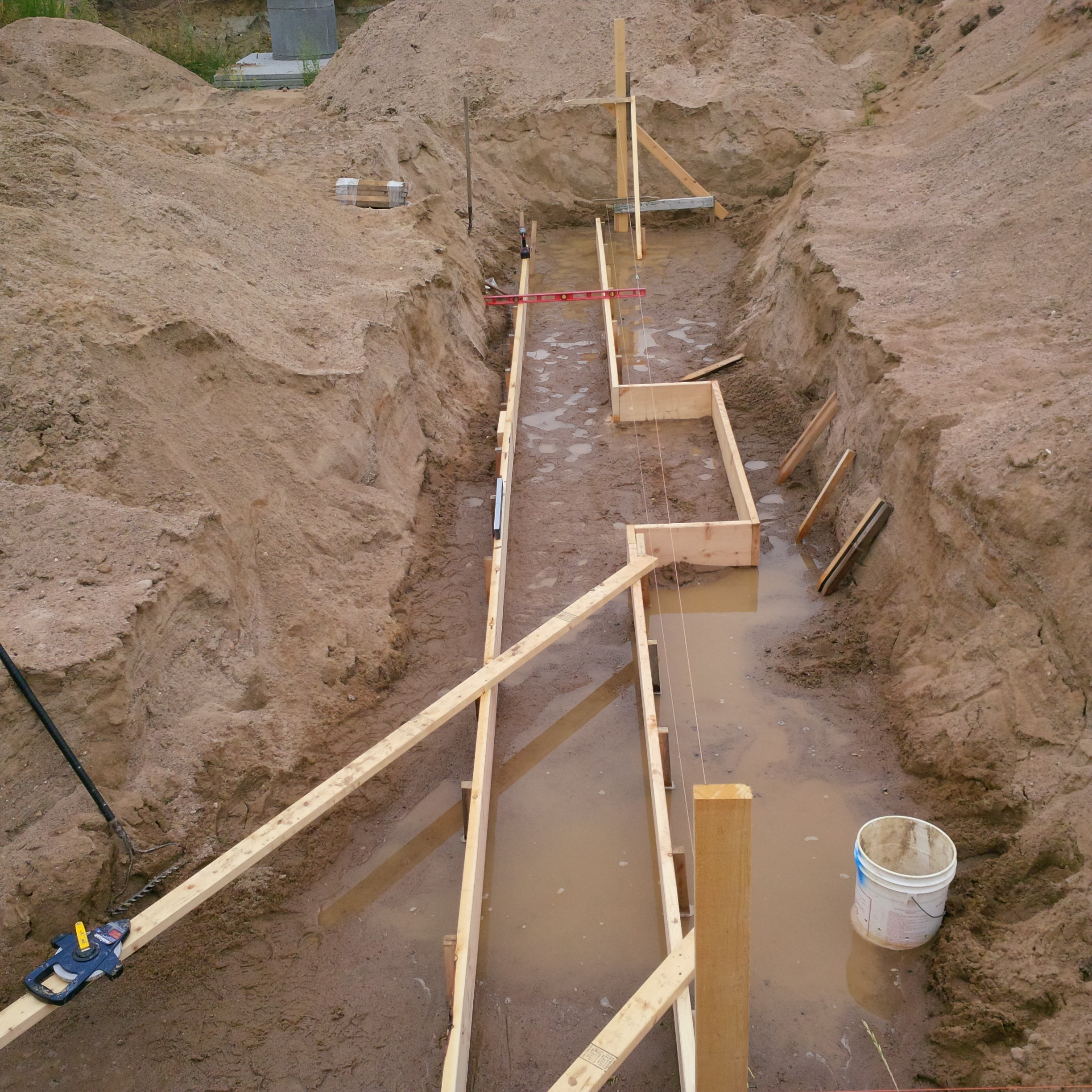

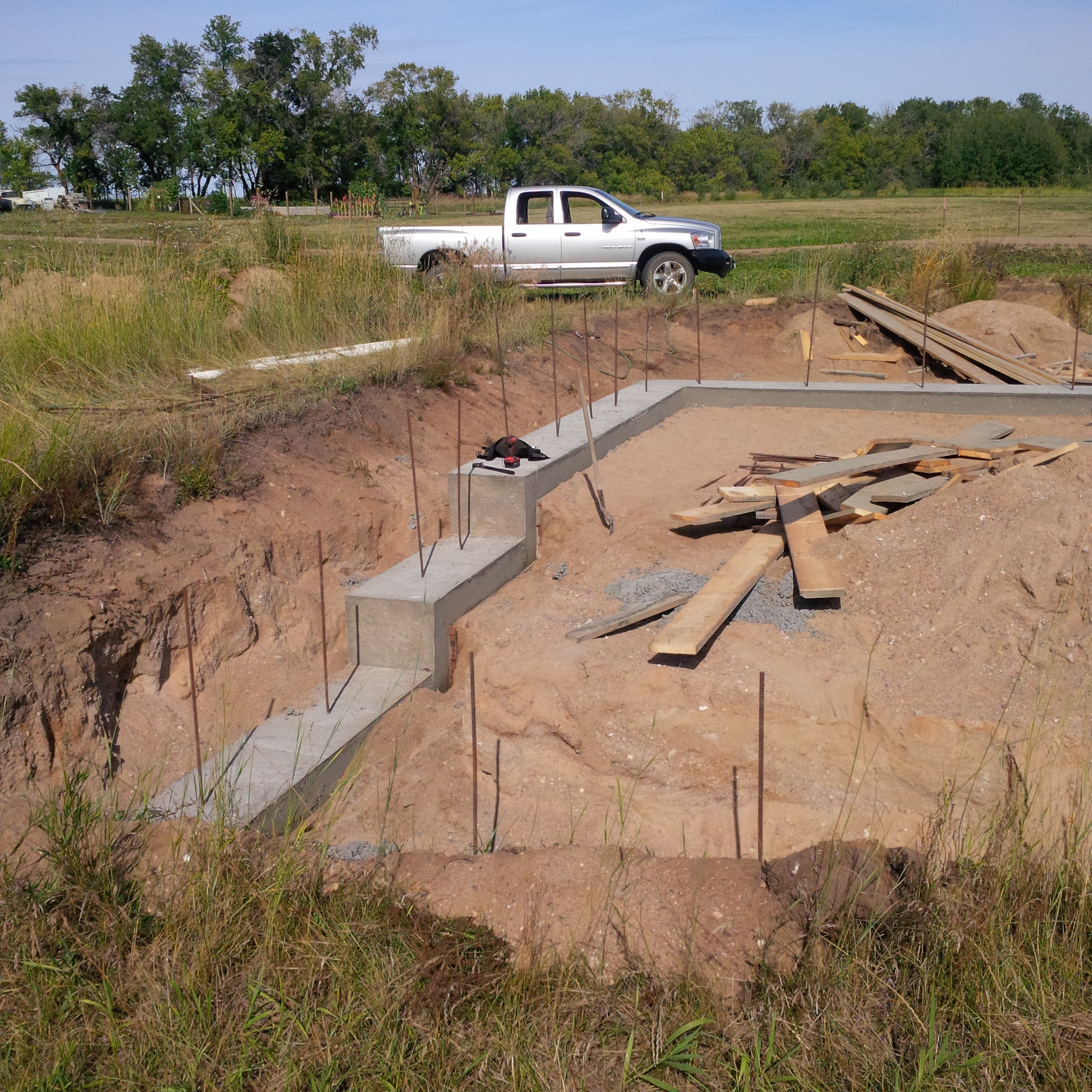

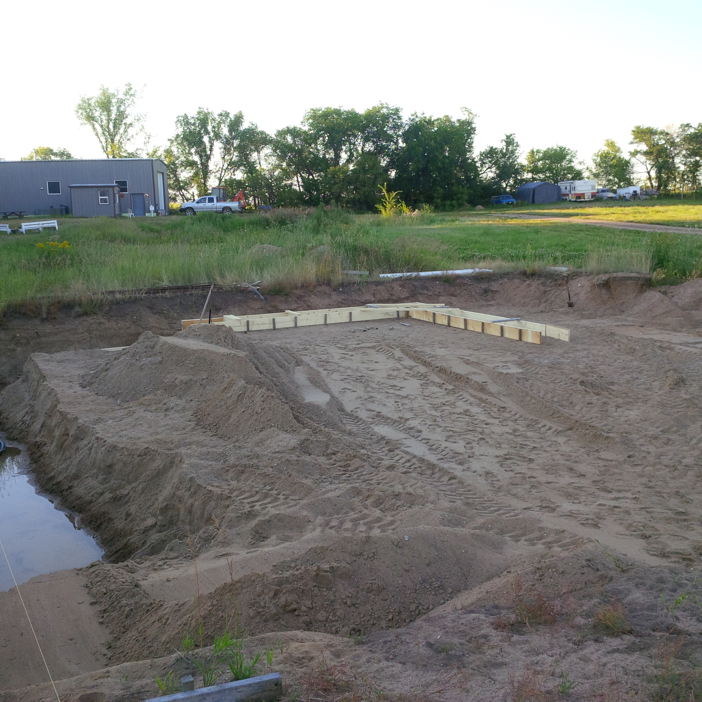

It's been a while since I've visited here, as the summer has been busy. I've finally started on the house construction, and it has been a one man build, so it takes a while. In mid July, I put the footing forms in and poured the concrete. Then came the frost walls for the walkout basement, another few weeks in. The build is completely ICF 8" block from footing to roof, and to date I am at the top of the basement walls. My building supplier brought the entire house of block in one shot, three truckloads of Nudura block. I have only taken two week off from work to do this, so its been mostly weekend and evenings so far. With the winter season coming, I can only hope I have enough time left to get things closed in. I will post some pics a little later showing the progression.

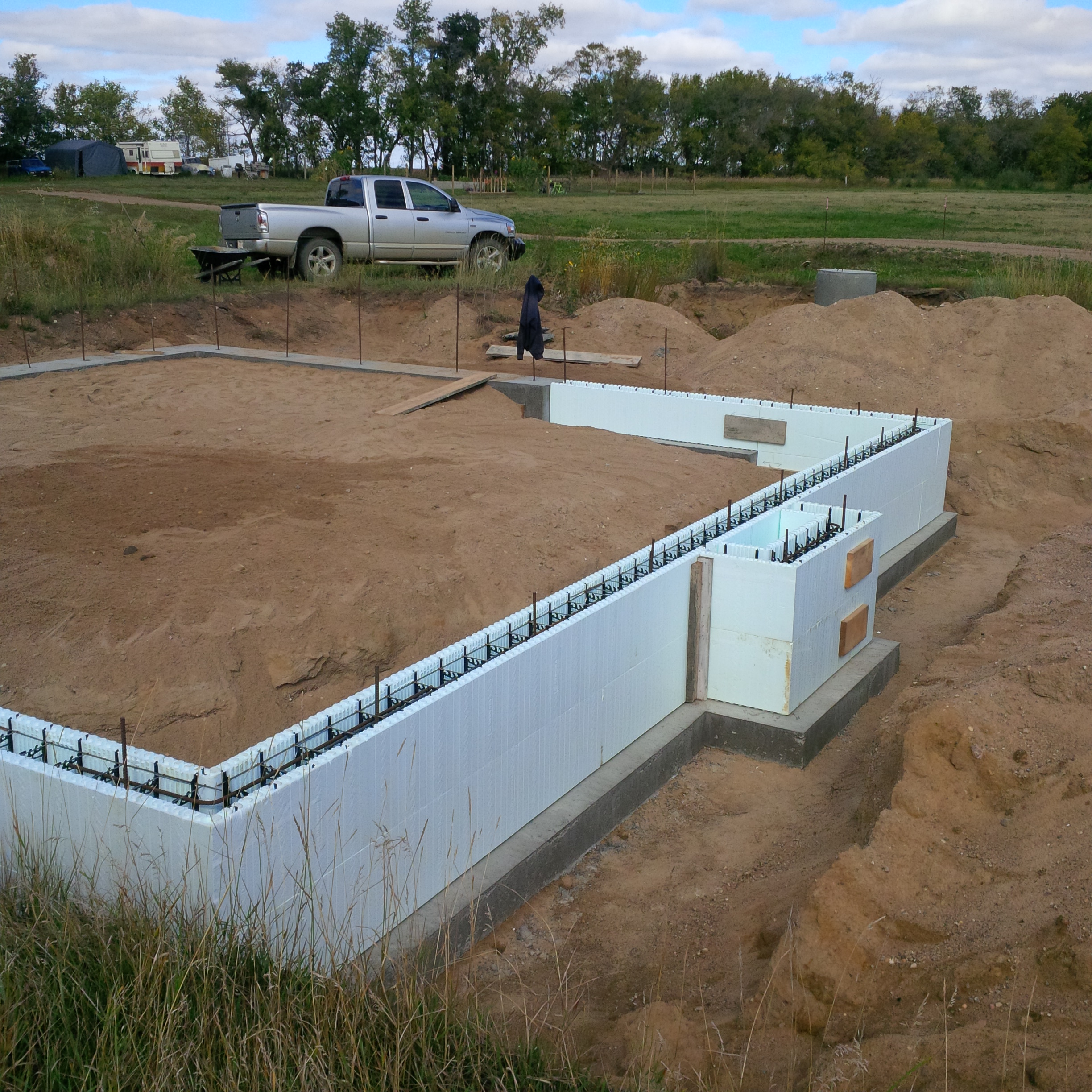

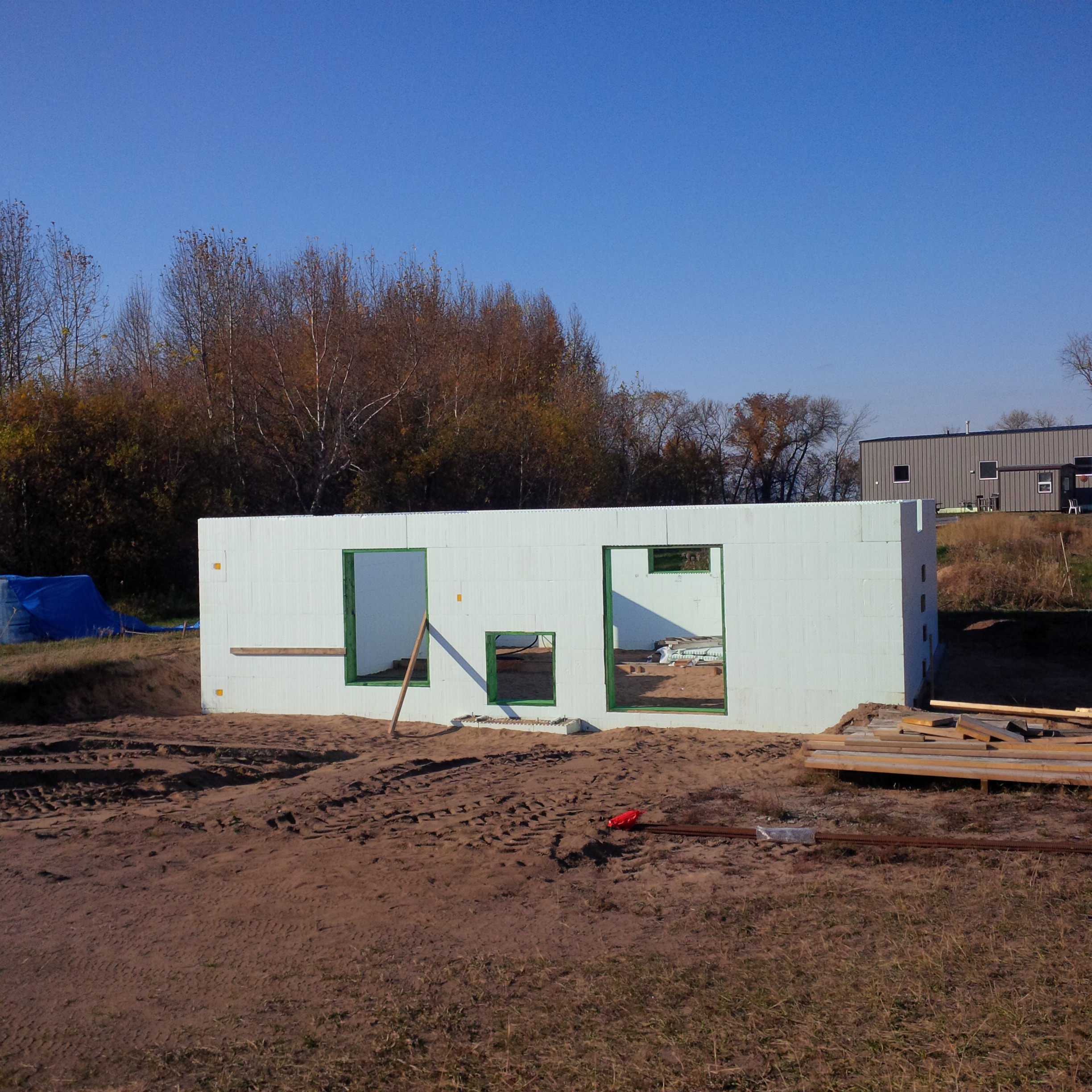

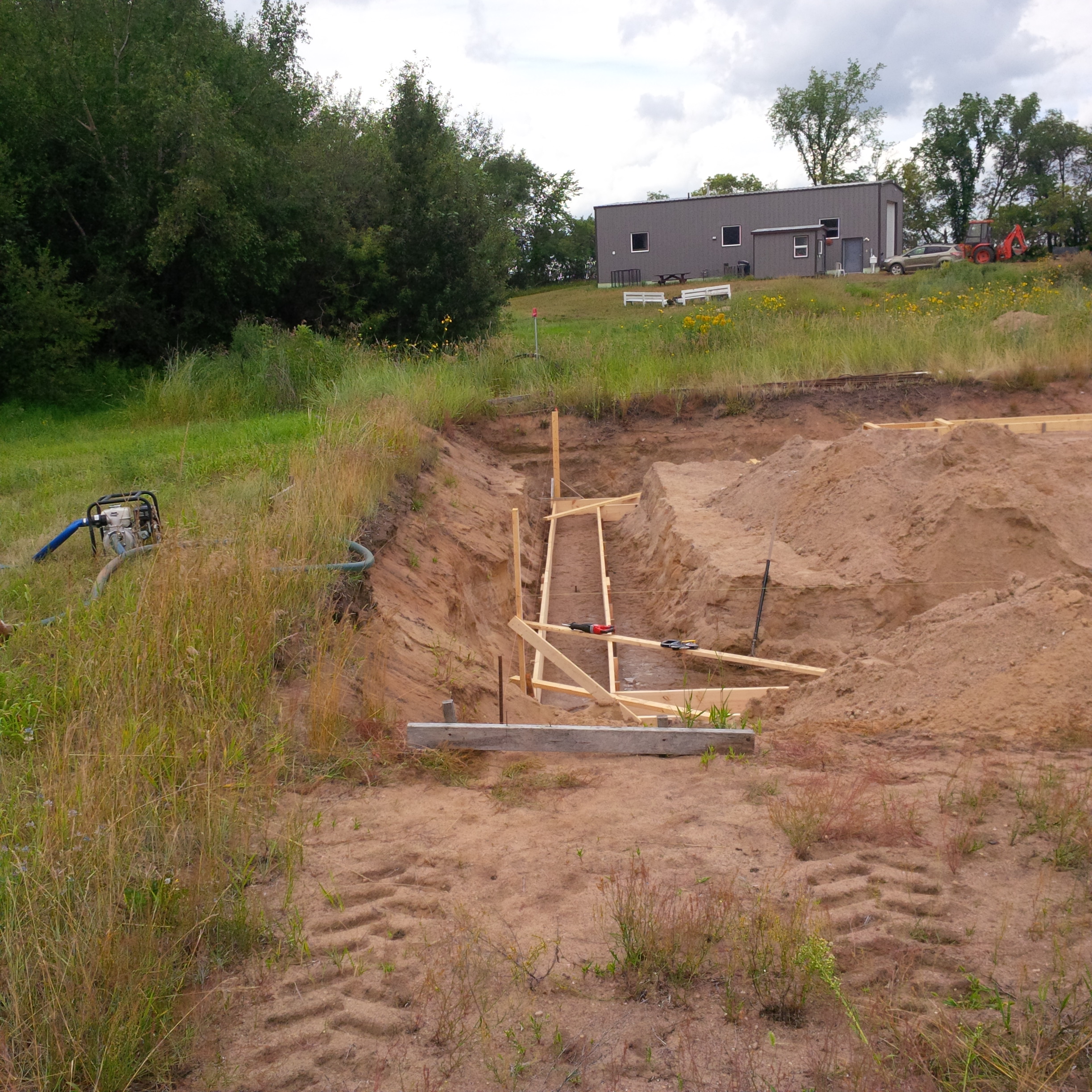

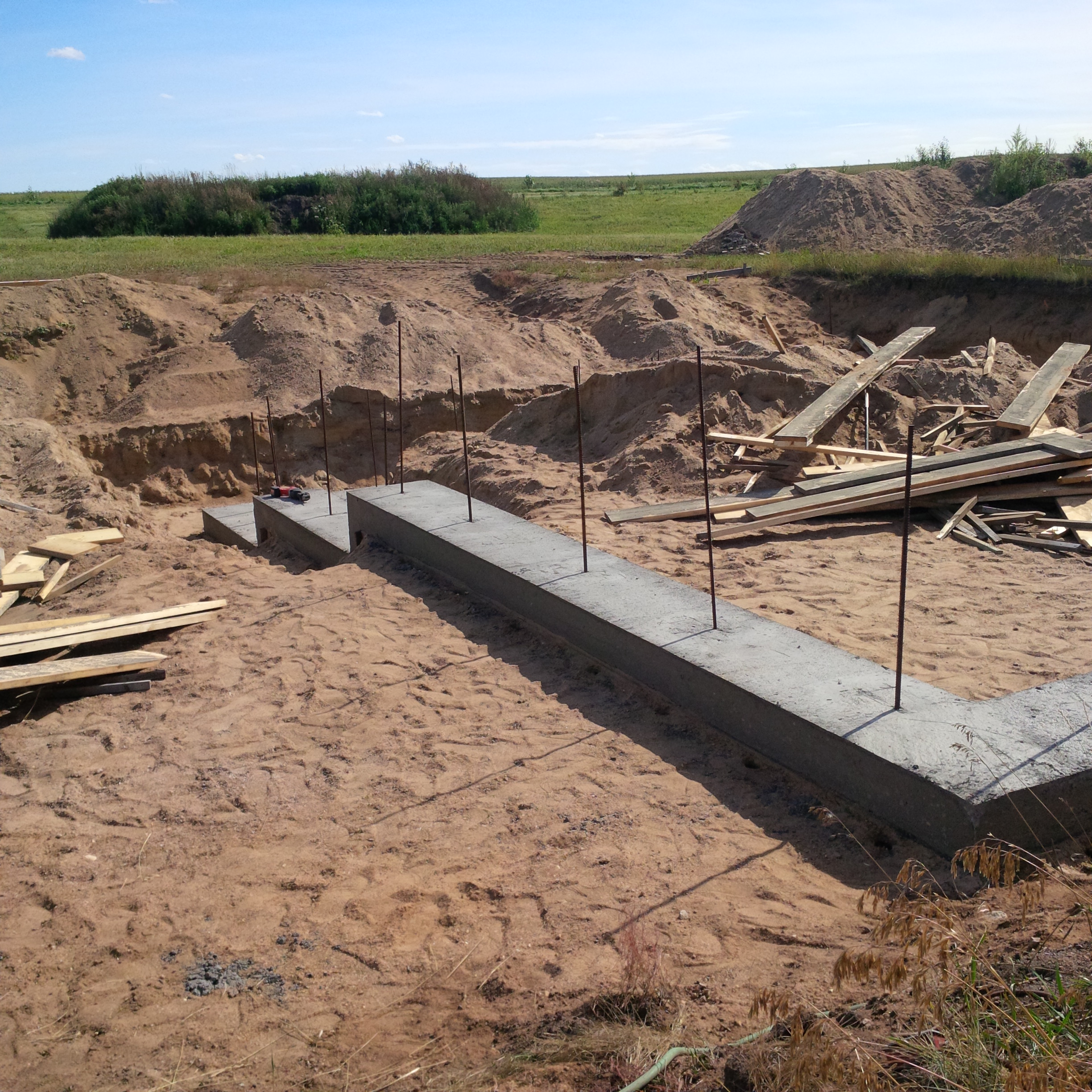

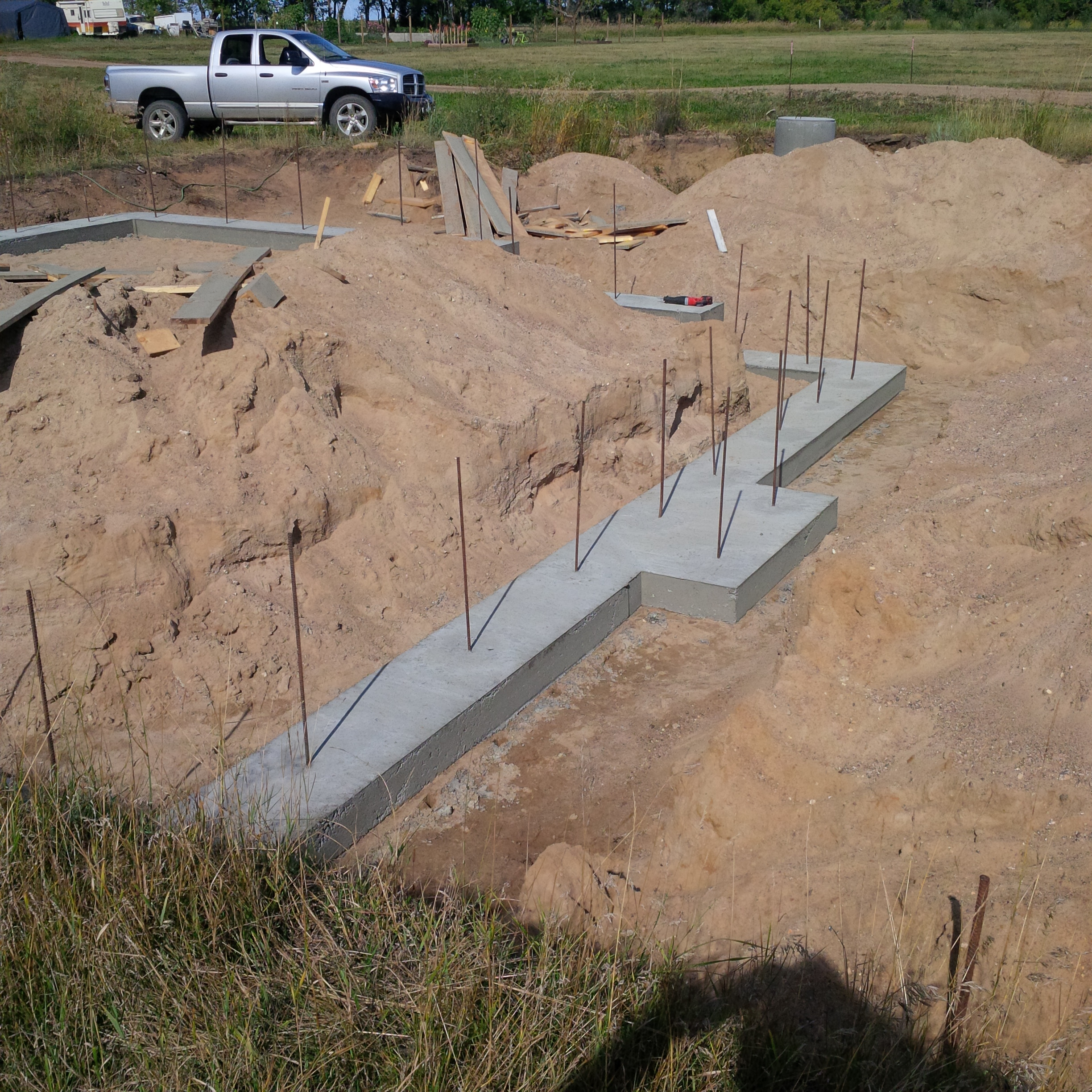

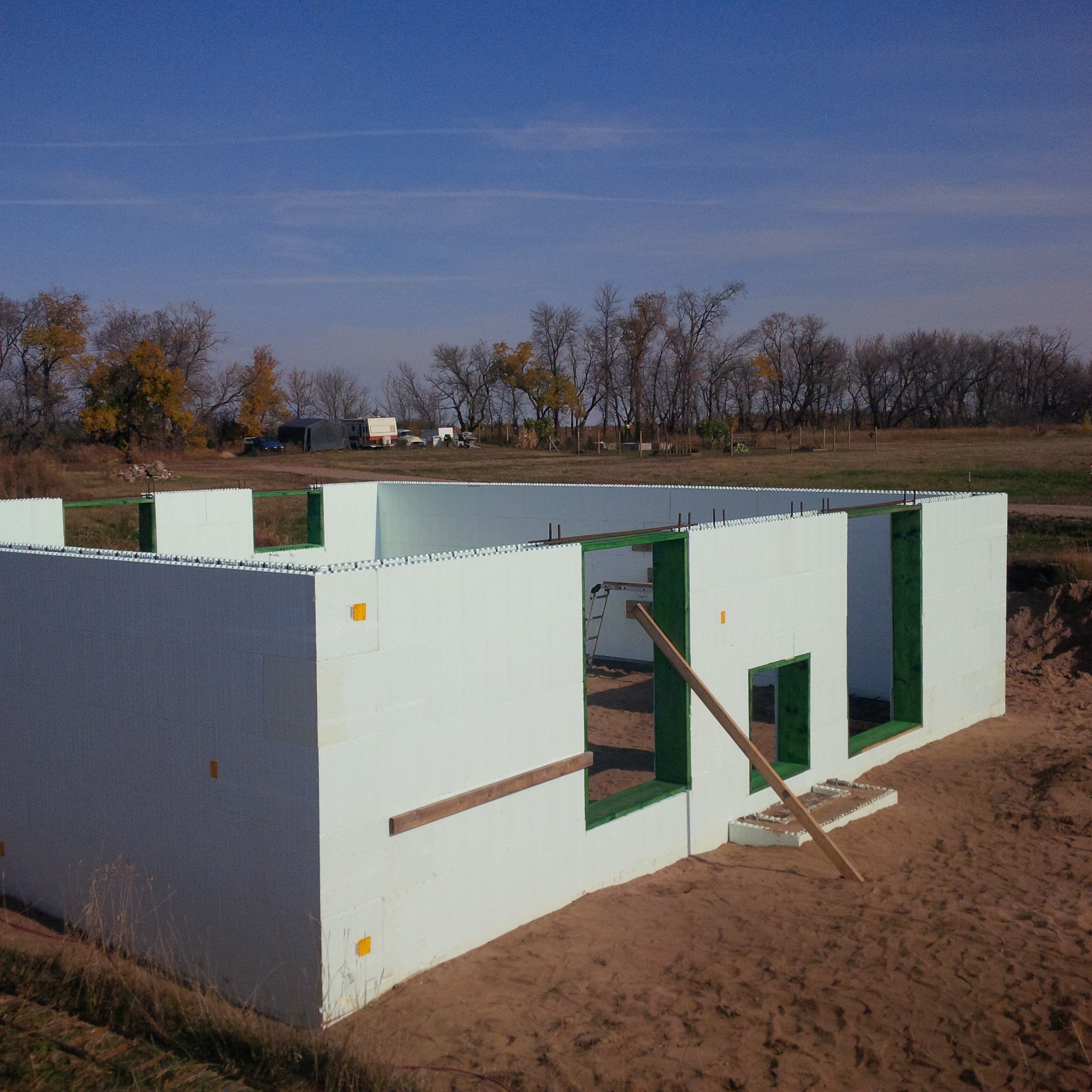

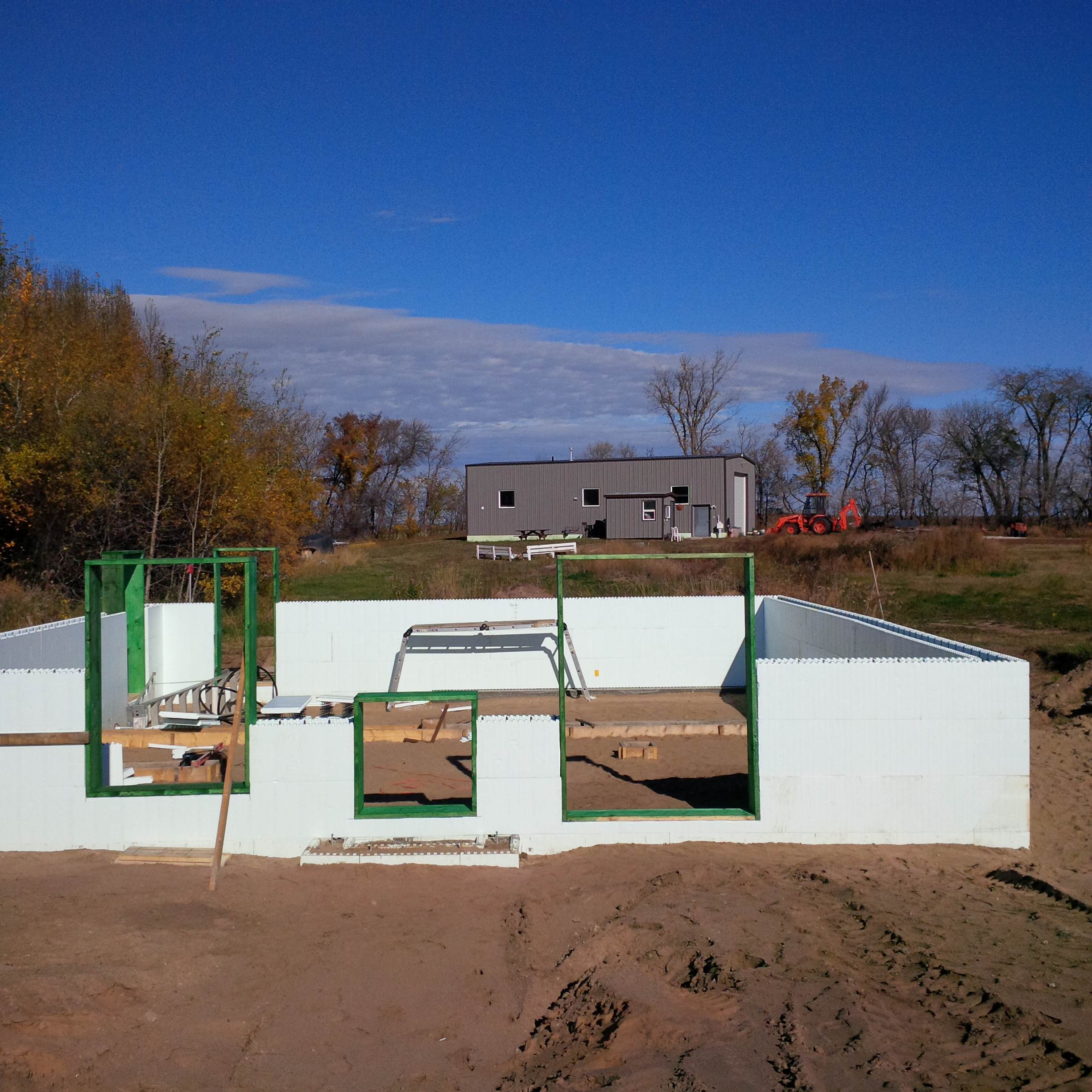

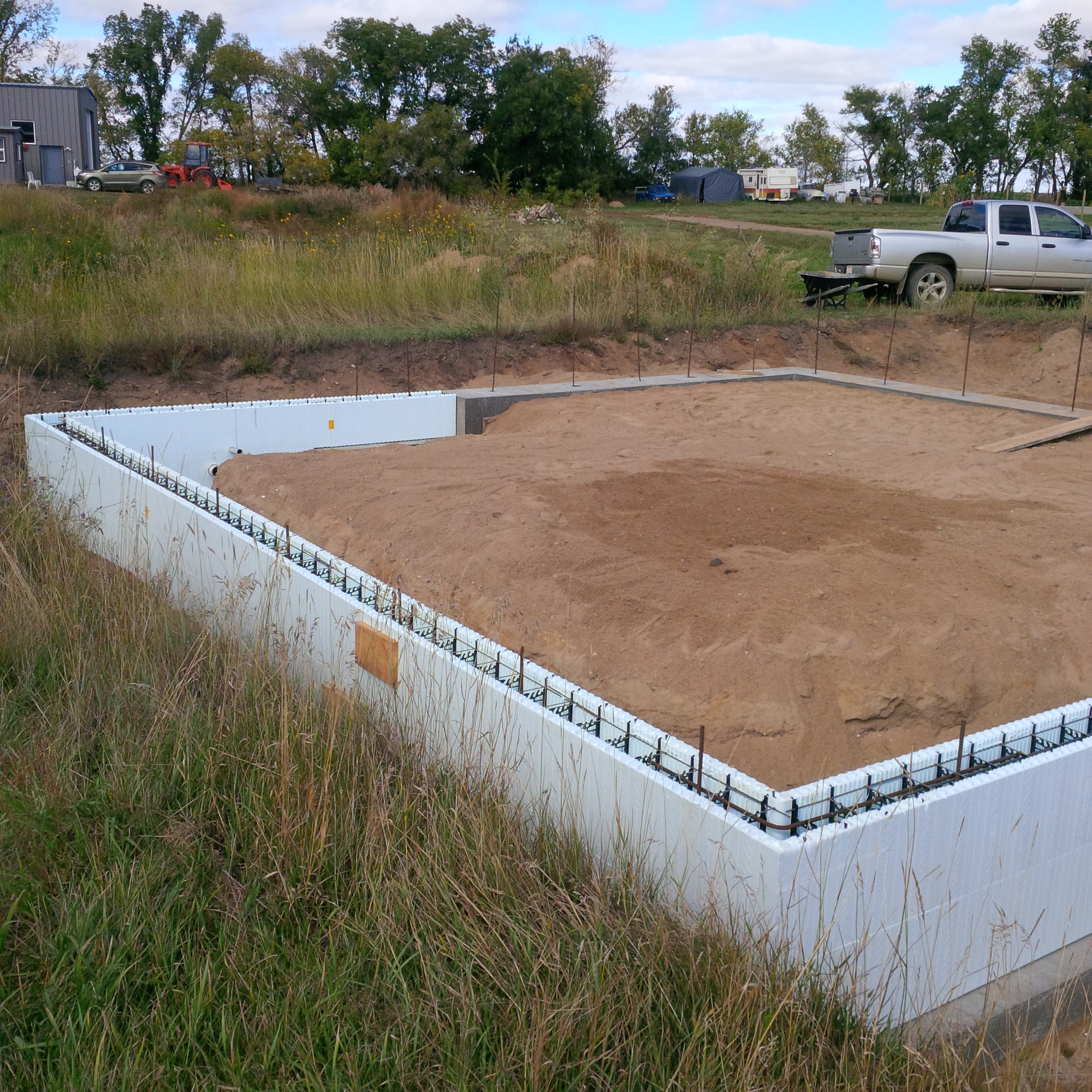

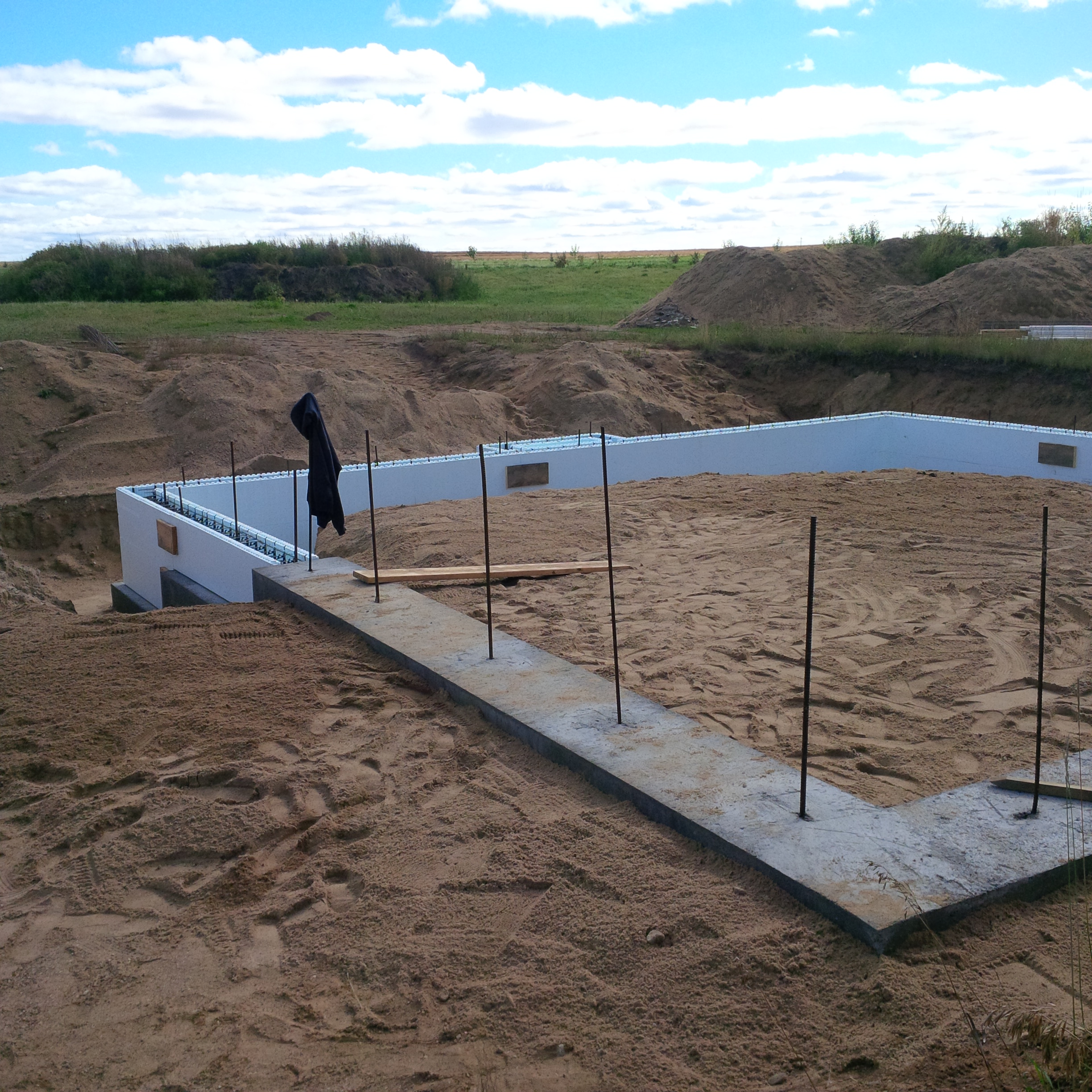

Here's a few pics to start this off right! Enjoy!

I'm guessing the snow last night may have put a damper on your construction plans for the weekend? :(

what is the white block?

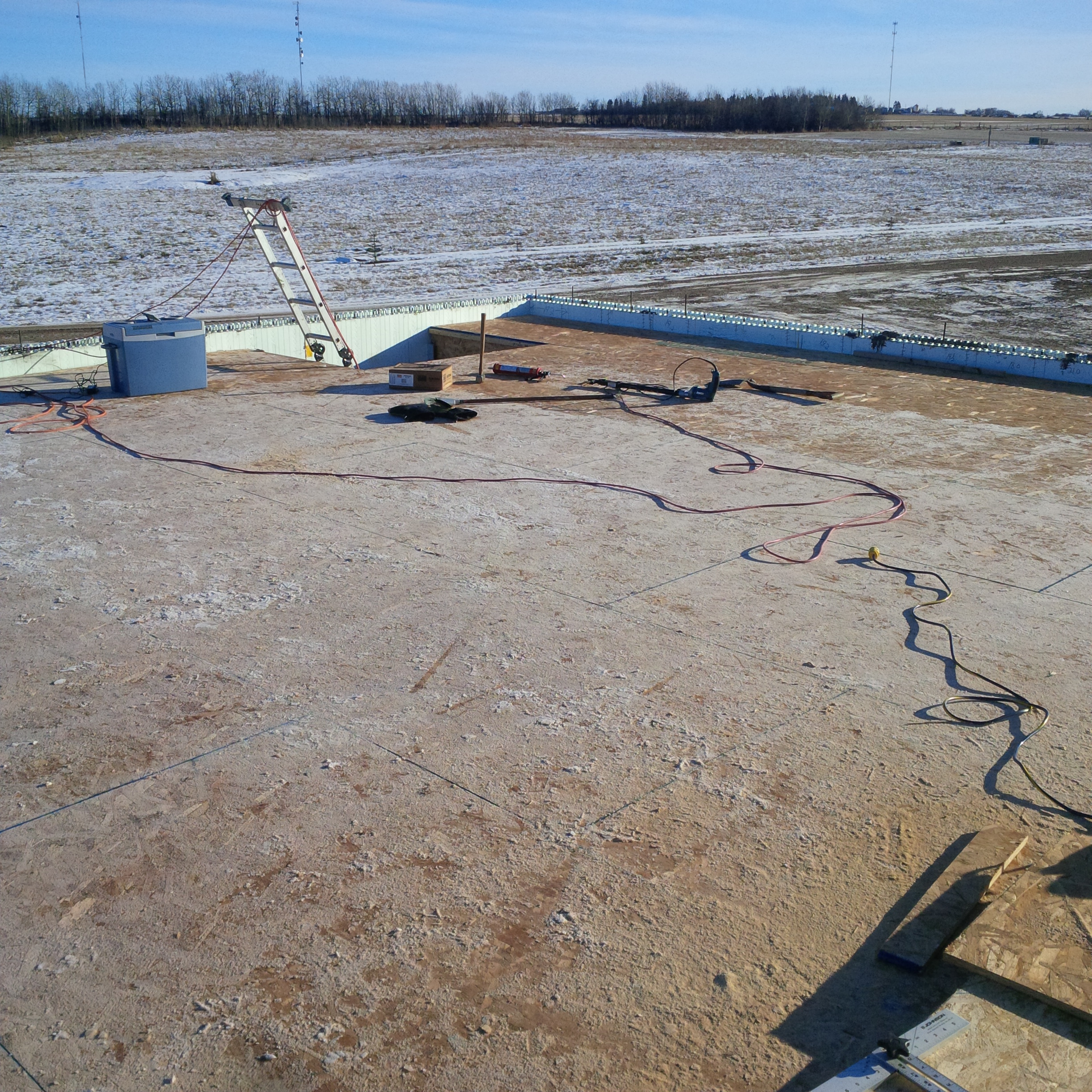

Sorry for the delay all, been super busy, but back on the job again. Finally poured the basement walls on Wednesday afternoon, 2 degrees Celsius, 3 plus hours to pour 37.5 yds concrete.
Lessons learned; If you think your braced it enough, brace some more. My vibrator man found the two weak spots around the bucks, and blew out two wall connections. there will be a little fixing to do, but not a deal breaker. Prior to this, I set the beams last week with the help of a telehandler (rented for $800/ day). Took me 4 hours solo on and off the machine to get them set in place and braced up. Lots of running back and forth, but my helper didn't show. this weekend will consist of taking down the wall braces, and cleaning the residue from the pour. If time allows, I may set some floor joists. I got held up for 2 weeks waiting for the joist hangers to show up, but worth the wait, no ledger to install, just insert through the ICF block and pour the concrete. They were a bit pricy though, $1k for enough hangers to do main floor, loft, and wrap around deck on 3 sides. As for pricing, so far I'm in for about 45K including, permits, plans, septic tank, and elec panel, concrete so far is included in that figure. I'm guessing I have saved almost that much in labour cost.

I'll post some pics, but it was caught early and shouldn't be too bad of a fix. My concrete guy says he can cut out the foam block, and the grind out some concrete and replace the foam. I rented the form supports from my bldg. supply, they aren't visible in the pics, cause I hadn't installed them at that point.

Ok, I looked at your pictures more, and I have questions...
Why concrete footings on ground level, but then dig out and use ICF well below grade for some of it? I believe I see a stand for a chimney, also ICF... ?? Why not just use footings for that section?
Perhaps I don't get what I'm looking at?? Is the level that's completed in the first pictures the basement, or is the "basement" currently full of sand?
Also, I was under the impression that you were not supposed to fill directly against the ICF blocks, but it appears you have done just that... ??
   / Finally building the house
#15
1stDeuce, in answer to your questions, what you see is a frost wall that is below grade because the basement has a walkout on two sides. Back fill against the frost wall is below the basement floor, therefore does not require waterproofing. The chimney chase could have been just a footer, but it is on the walkout side so I raised it the same as the frost wall. Hope this clears things up a bit.
Currently I am putting the subfloor down after spending last weekend setting the joists. I will post more pics soon.

Now for some updated pics....blowout in cold room.jpgBlocks removed so I can set the beam.jpgrear view of cold room.jpgthe worst blowout.jpgtop two corner blocks lifted a bit.jpg
#18
more...
#19
some more pics...setting joists after the pour has cured.jpgsubfloor on and temp railing in place.jpg
   / Finally building the house #20
I didn't expect two stories of concrete forms!!! This is gonna be something to see come together. Thanks for the pics!!!
