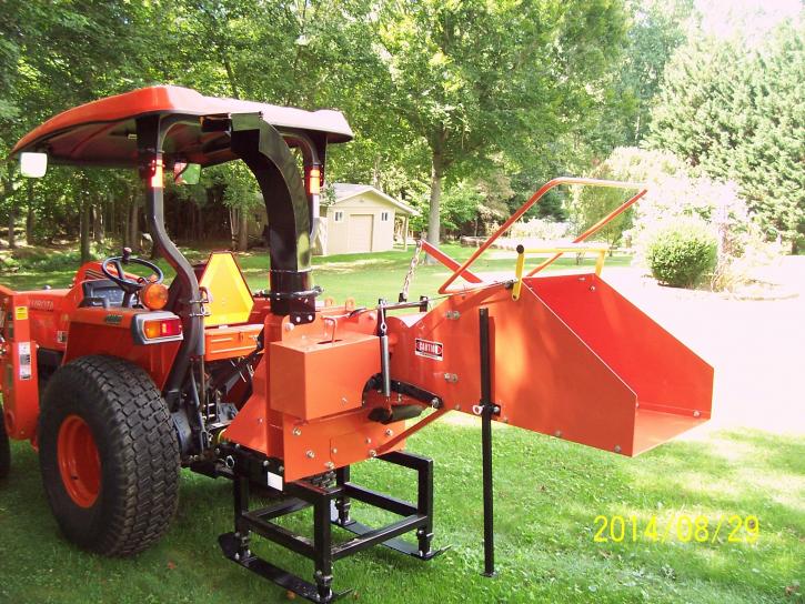

100_8277.jpg?????I don't know if this an add on or factory. I didn't post a question on ott, the first and last time I did I got scolded for not being a dues paying member! lt190b

Yours is a hydraulic drive. His is mechanical drive like my Jimna. I guess I could add a hydraulic motor to mine and run it from the tractor, I have 3 sets of outlets on the tractor, but I don't see any point. My gearbox drive works fine.

The hydraulics run off the PTO, no lines to the tractor at all. The reservoir is in the stand. You can see it in the left side picture. About 7 gallons.

I understand the WM is self contained. What I meant was I could use the tractor hydraulics (21.5 gpm@2100 psi to power an orbital hydraulic motor if I needed one. I don't. The mechanical infeed is just fine.
Don't want to get fancy for a thousand bucks anyway.

5030, its orange tractor talk. By the way, now I see that the chipper in the picture I posted from ott is a mechanical drive, that explains the box cover and no oil tank under the chipper. Boy do I feel like a DA. lt190b
