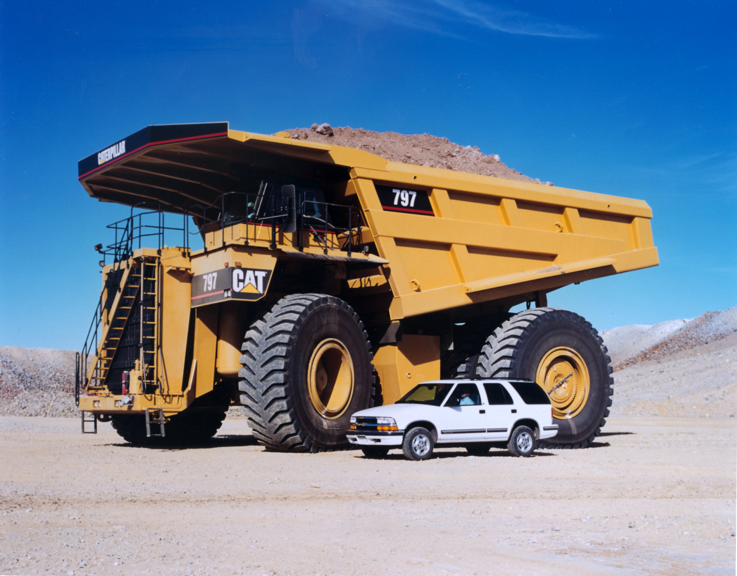

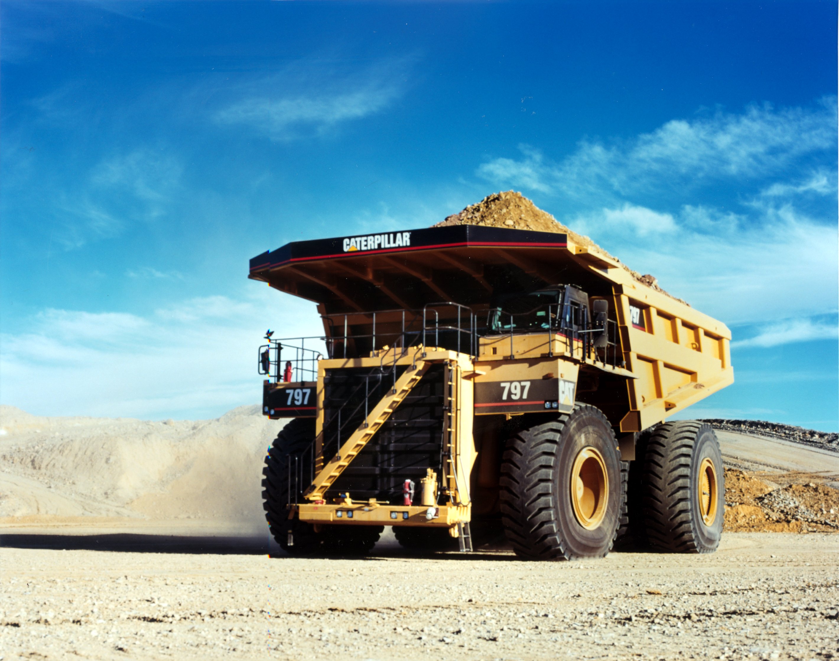

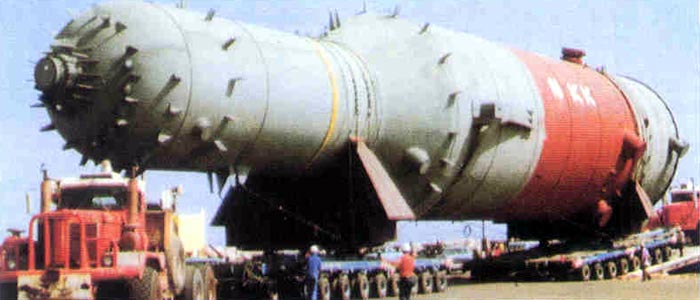

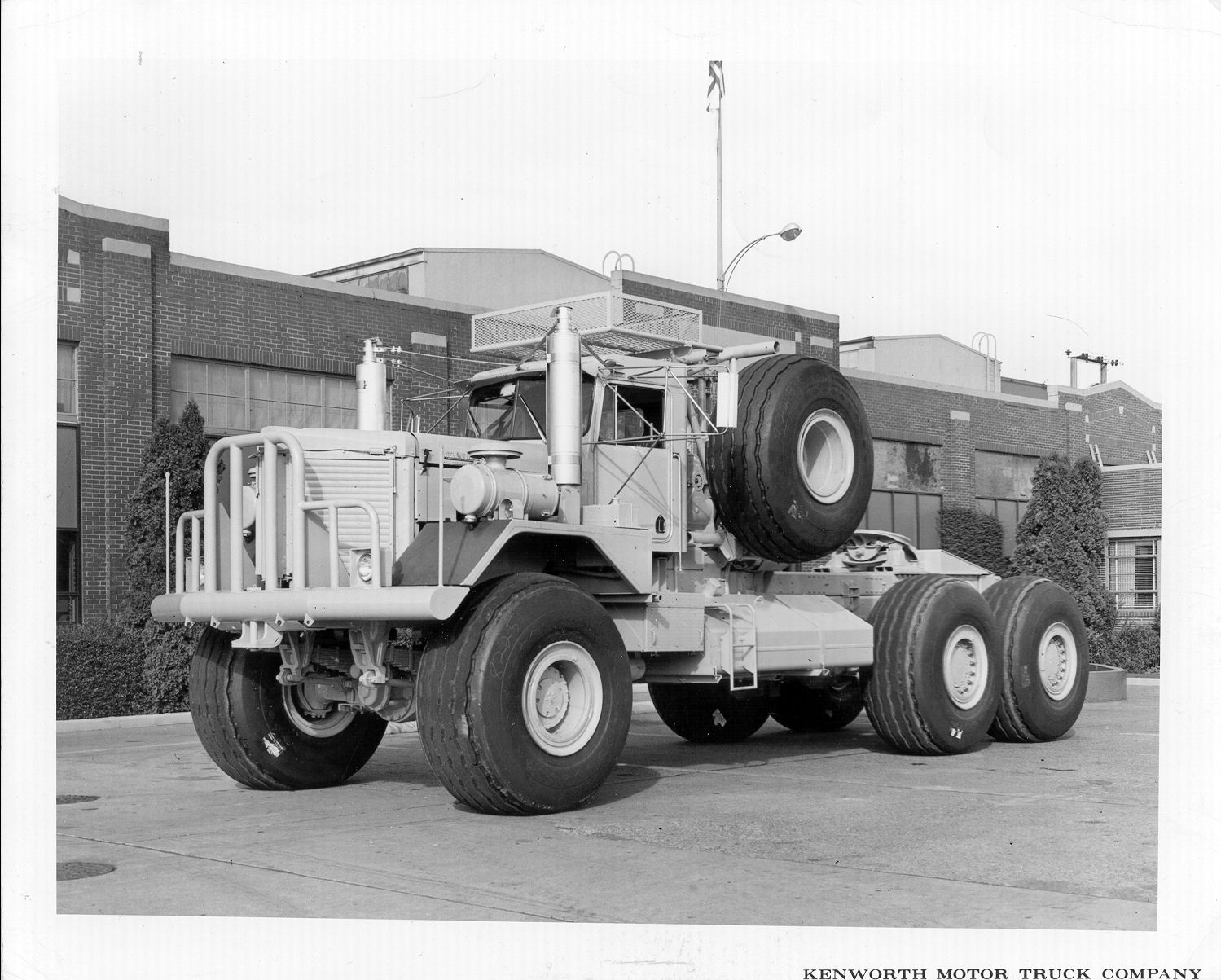

Now...this is a REAL truck...
You guys just have toys...
Now that's my idea of a REAL truck. Thanks for posting the pic, and I'll add a few of my own.
