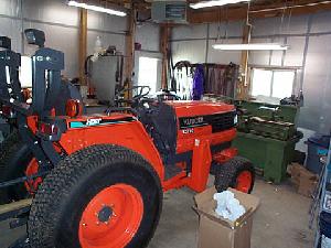

RaT:
I had a little problem with my old L3710 which had no cab, but a ROPS. The ROPS would rattle at a certain engine rpm. it just so happened that the rpm was the sweet spot for power. I added fiber washers between the outer bar and the moveable bar and that cured the problem.
