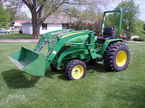

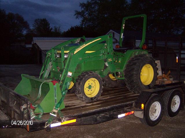

I've only had my 790 for a week! But like it very well for my purpose, loader, mowing & blade work mostly. Headed for the farm today for another round with the 5' Woods finish mower. As for the box blade, I have a 5' 3-pt blade I intend to make a BB out of. First, I need to make a boom for the loader. ~~ grnspot110
