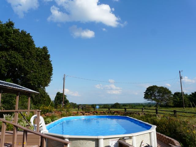

We enjoyed our pool and I don't regret putting it in. I had heard about the saltwater set up and after hearing your story wish I had put on in.
