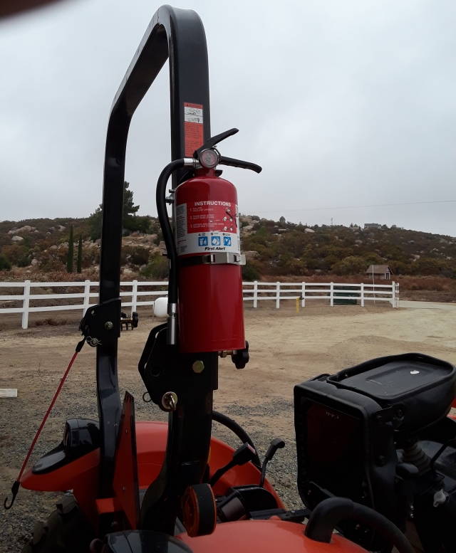

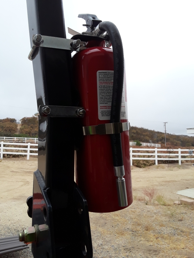

I've been meaning to attach a fire extinguisher to the tractor for a long time. Finally remembered to buy the clamps while at the hardware store.
Here's hoping I never need it! :)

My only suggestion is to cut up an old/cheap 'stubbie holder' (koozie?) made from foam neoprene... use strips of it as an anti-vibration barrier between the U-bolts and the ROPS.
Everything that I've added to my tractor (fire-extinguisher, light bar, side mirror) has incorporated a vibration dampening barrier of some sort.

I have a similar extinguisher mounted in a similar manner.
One caution though!
The type extinguisher shown, with the plastic valve and handle, is the big box store type, and is notorious for breaking when you need it.
If you leave your tractor out in the sun/weather at all, the plastic will deteriorate quite rapidly.
I took all the plastic valve extinguishers I owned to the dump (I had 6), and replaced them with metal valve/handle types.
The metal valve/handle extinguishers are more expensive, but when you NEED an extinguisher, you NEED an extinguisher that you KNOW will work!
Take note: Places of business DO NOT have plastic top extinguishers!
Extinguishers sold with plastic valves/handles are homeowner garbage, made to sell for a cheap price.

I'm pretty sure his has a metal handle.
