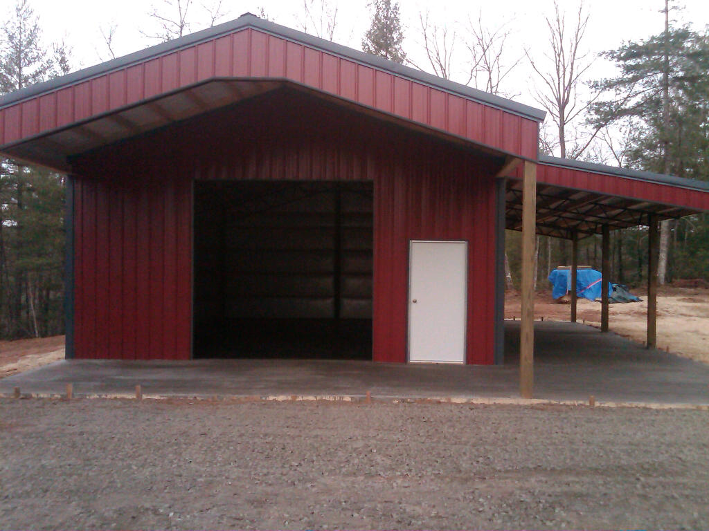

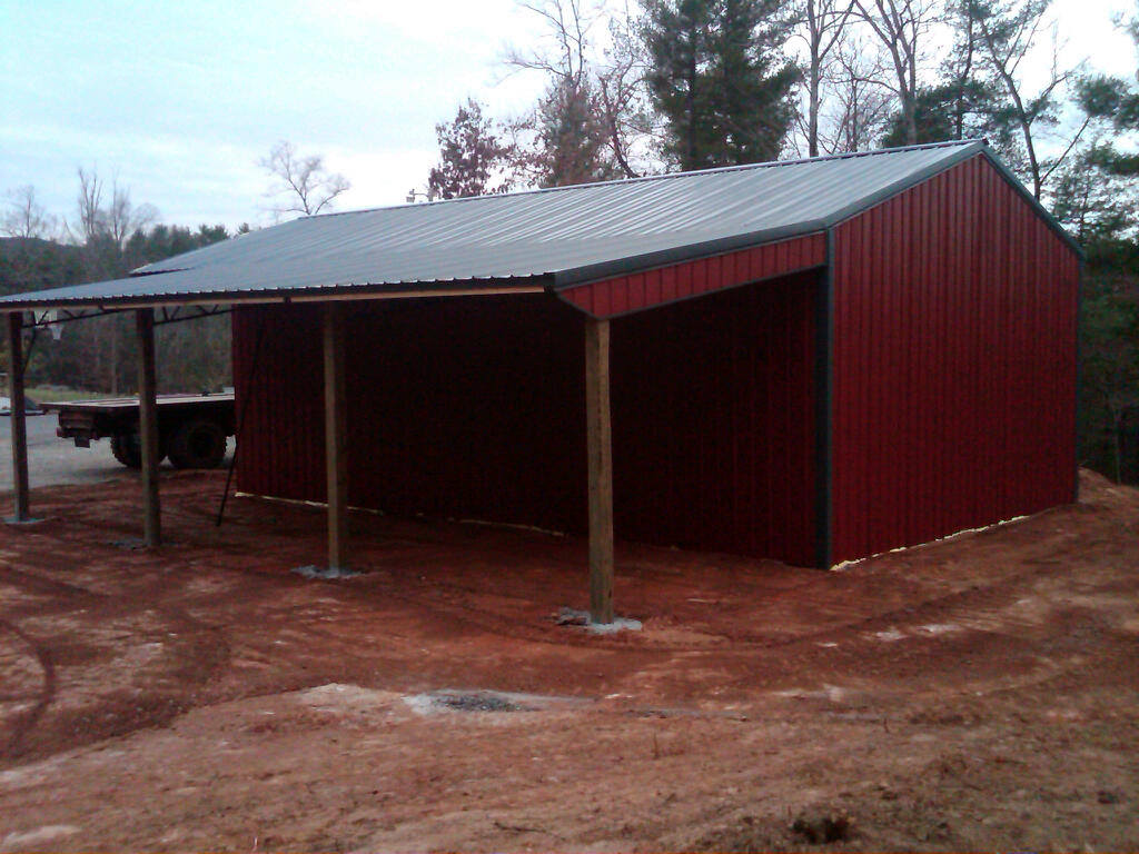

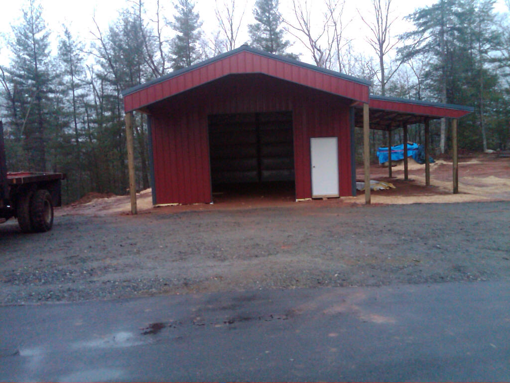

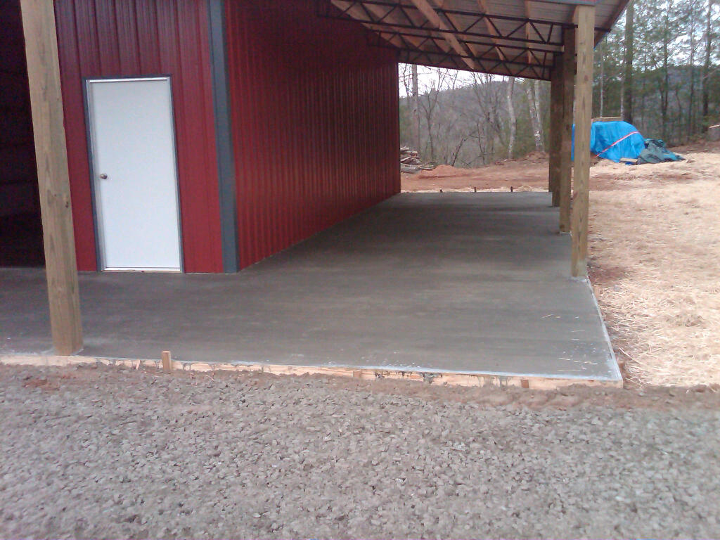

David, your Western NC climate is a lot like mine here in NW SC. Do you think that it will be feasible for you to be comfortable in the shop without HVAC for now?
If not, have you decided a route yet?
Any condensation issues as of yet?
Last question for now- do you have any regrets? Door size, windows, overall size, etc...
/ Finally My Pole Barn/Workshop Has Started
#42
I plan to start electrical as soon as planting is complete. I do not think I will add AC but my wife did suggest a large ceiling fan which I think is a great idea.
No condensation yet, I left the door open for 7+ days to allow air to circulate. I have had it closed for the past 5 days with temps ranging from 35* morning to 76* afternoon. I open the large door when I get home from work and have not seen any condensation. The humidity is higher but no condensation on anything. The builder told me to leave the door open for a week or two because of this and I told him I had already planned to do that.
Regrets, not really, I thought about putting a window in the top gable end for air circulation and will do this on the back side as soon as I get the loft built. I had thought about putting a garage door in the back but I don't think I would use it that much and I wanted to put the loft in the back.
I will extend the building sometime in the future and put a man door in the back to access the extension which will be an open shed for equipment or possibly enclose it.
I am leaning towards the open shed extension and enclosing the lean to in the future.
David

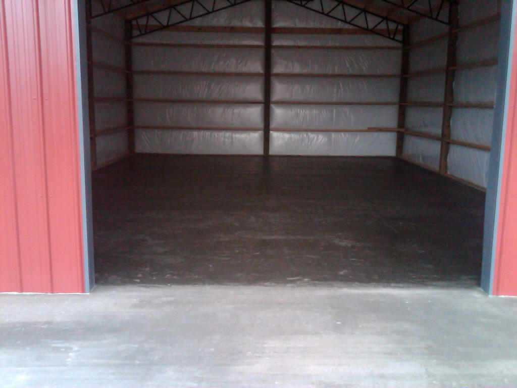

Thanks for the reply's.
Started putting the osb on last week then had to stop to lay plastic for planting. Hopefully can get back on it this weekend. I decided to attache the osb with screws so if I ever need to remove a piece it would be easier.

David, are you going to place OSB on the ceiling portion as well? I don't know if you stated earlier, but what kind of venting do you have?
/ Finally My Pole Barn/Workshop Has Started #52

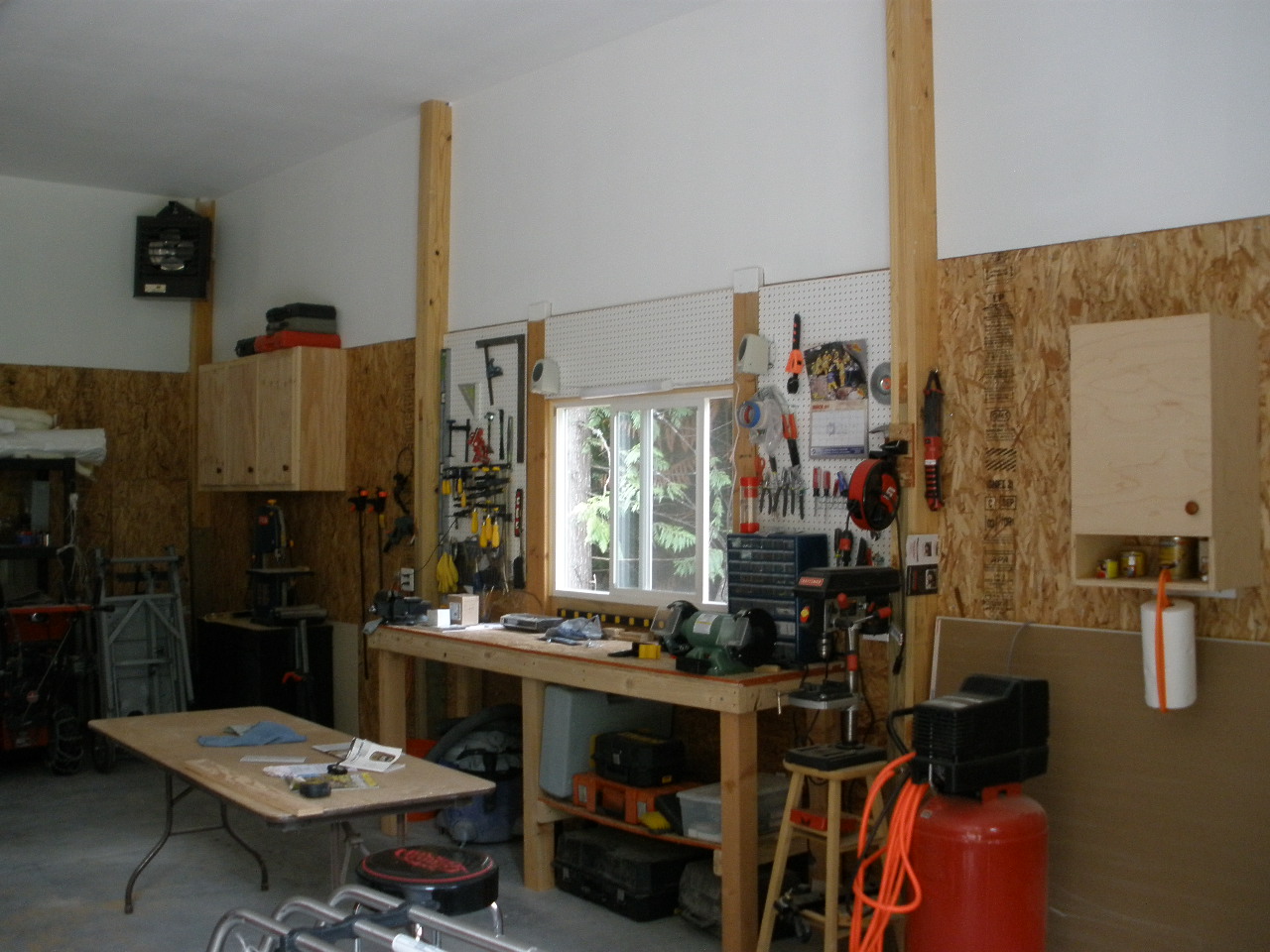

I also used screws to attach my osb panels, I have had no issues after almost 6 years. The builder left behind enough insulation that I doubled it up behind the panels. I cut it to fit between the 2x4 girts which were installed flat. I like your storage on the side, I wish I had done that originally. My front apron was poured separate from the floor and not pinned so it does heave in the winter when the ground freezes. Well live and learn!
I installed joists in the ceiling and dry walled the ceiling and upper 4 feet of the walls, then added blown in insulation. With electric heaters it is very comfy when working in the winter and even though we regularly get in the 90's it is comfortable in the summer.
#53
OB, not sure if I will do the ceiling but if I do I will use a light weight luan type panel. No venting but may put a window in the top of the gable end once I get the loft built.
