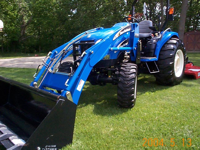

And another /forums/images/graemlins/smile.gif /forums/images/graemlins/grin.gif /forums/images/graemlins/ooo.gif

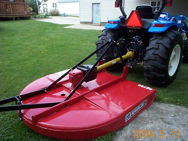

From the back with the Squealer! /forums/images/graemlins/grin.gif

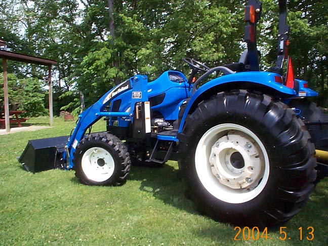

Another side shot.

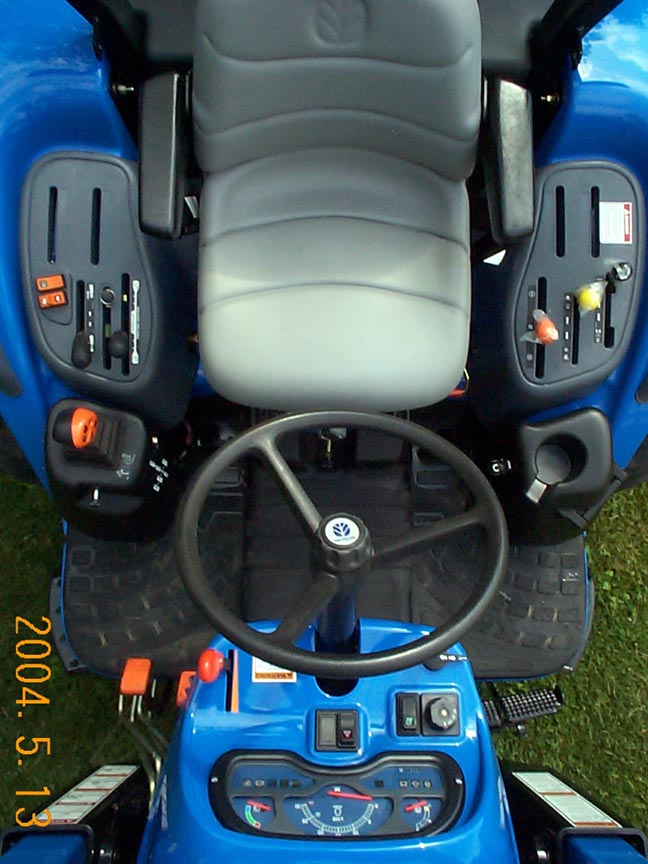

And the last one for now! /forums/images/graemlins/smile.gif
   / Finally ordered my TC45DA #85
OK - I give up....
How did you get the overhead view...? /forums/images/graemlins/confused.gif /forums/images/graemlins/shocked.gif /forums/images/graemlins/crazy.gif
Mark
PS Pretty schweeetttt!
#86
I stood on the top of the loader arms where they mount to the tractor. Dad always told me I had a little monkey in me. /forums/images/graemlins/shocked.gif /forums/images/graemlins/shocked.gif /forums/images/graemlins/shocked.gif /forums/images/graemlins/shocked.gif eeeeee!

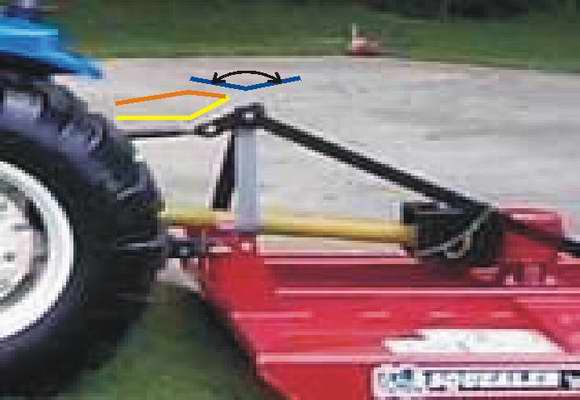

   / Finally ordered my TC45DA #90
Greg, your tractor looks great! /forums/images/graemlins/cool.gif /forums/images/graemlins/cool.gif /forums/images/graemlins/cool.gif
I know you can't wait to get some seat time on Sunday. /forums/images/graemlins/smile.gif
One thing I noticed from your picture that's a "pet peeve" of mine. It's the toplink float attachement they put on so many rotary cutters that needs just a couple of more engineering steps to correct a geometry issue. I've attached a close-up of the area in the attachment that shows what I'm talking about.
Yellow line: This is the problem. The float is over-center and in this position, when the tailwheel goes over a bump, the float linkage has nowhere to go. If you disconnect the toplink and extend it, you can put it over-center to the high side, but there's nothing to keep the toplink from ending up in this position the next time you lift the cutter with the 3PH. Gravity is your enemy here. /forums/images/graemlins/frown.gif
Orange and Blue lines: The orange line is my preferred minimum angle the toplink to float adapter would ever be allowed to achieve. With this limit, it would have the float range shown by the blue line and perform just as I want. /forums/images/graemlins/cool.gif /forums/images/graemlins/smile.gif
I just think there should be a stop welded on the float adapter so it will not go over-center and lock in the down position. Does anyone else share my frustration with this piece? /forums/images/graemlins/confused.gif I'm open to ideas if anyone has a good suggestion. In the meantime, I used a length of chain and and made a flexible limiter on my cutter. It allows just the movement shown by the blue line and works for me. Why these cutters can't have that engineered into this piece is puzzling to me. /forums/images/graemlins/frown.gif ...but lot's of things puzzle me. /forums/images/graemlins/blush.gif
