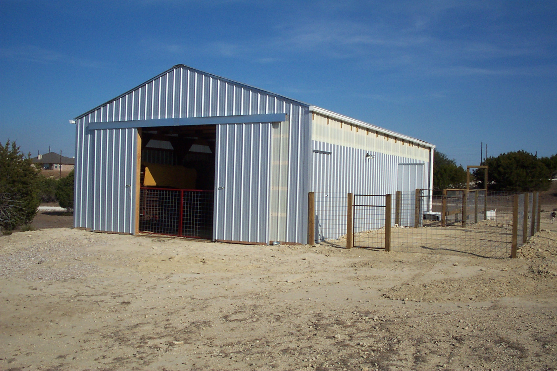

I got the metal from these folks for my barn as well. No OSB used. Fastened directly to the purlins. No sagging.
Second to Eddie's recommendation of being careful in the AM with the dew on the roof.

Thanks guys. Perhaps I should take the opportunity to clarify that my inquiry to the manufacturer was to get their recommendations if I chose to go with decking. Should I use lattes or nail directly on top of underlayment, what type of underlayment did they recommend, etc, etc.
Also...when I do get around to installing the roof panels, I will be nailing through the decking and directly into the purlins. The OSB does not have the holding power to do the job alone.
