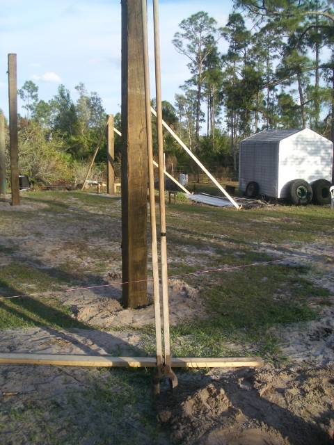

Here's a shot of the posts - they're monsters.

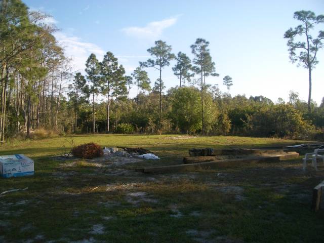

Here's a view of the site looking northeast. The pad was created a couple of years ago when I dug a pond to improve drainage and build a road around the back of the house to the barn site. The house is about 100' to the right in this picture.
You can barely make out the corner stakes I jabbed in the ground to see how it was going to fit the pad. I'll have to fill in a bit on three corners, and take out a couple of pine trees on the left side so that I can drive around the back of the barn.
Also looks like I'm going to have to move the burn pile.

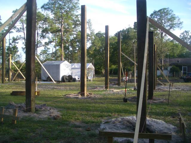

Half of the poles up!
Here I've finished setting half of the big-honking-*** poles; mostly in the right place and level. The tall ones weigh at least 500 pounds. They're set 4' in the ground.
It was a challenge getting the chain around them in just the right spot so that the FEL could lift them vertical. Once everything was balanced I could drive over to the hole. One tall post had to be chained close to the center in order to clear the ground. Turned out to be top-heavy and it flipped right over! I got off and spun it back like a big airplane prop, and had my son hold it down while I guided it in with the tractor. That was fun...
Once the post was in the hole, I'd heave and slam it into one side of the hole or the other to scoot the base toward or away from the string. There was a lot of grunting during this part of the operation. I no longer feel guilty about skipping the gym.

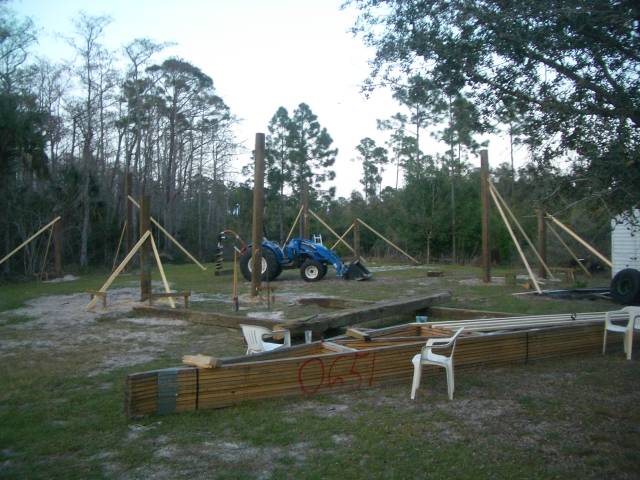

I set the last of the poles but ran out of 2x4 bracing. Will have to make a run to town.
I read the threads here about poles and concrete with great interest. So many different approaches and opinions on that subject. I chose not to use any concrete in the holes. Our sandy soils stay sopping wet a good portion of the year and I've had bad luck with concrete against wood of any kind. I'll tamp them well when the tops are tied together - I'm confident they're not going anywhere. I'll also wrap the posts with felt before I pour the floor around them.
The metal shed in the background normally just stores junk. I ran an extension cord to it and set the compressor and all my tools in there for the project. Sure beats hauling everything back and forth from the house.
The tarp canopy is covering my swamp buggy. I'll be glad to finally have her stored under proper shelter when this is finally done.
