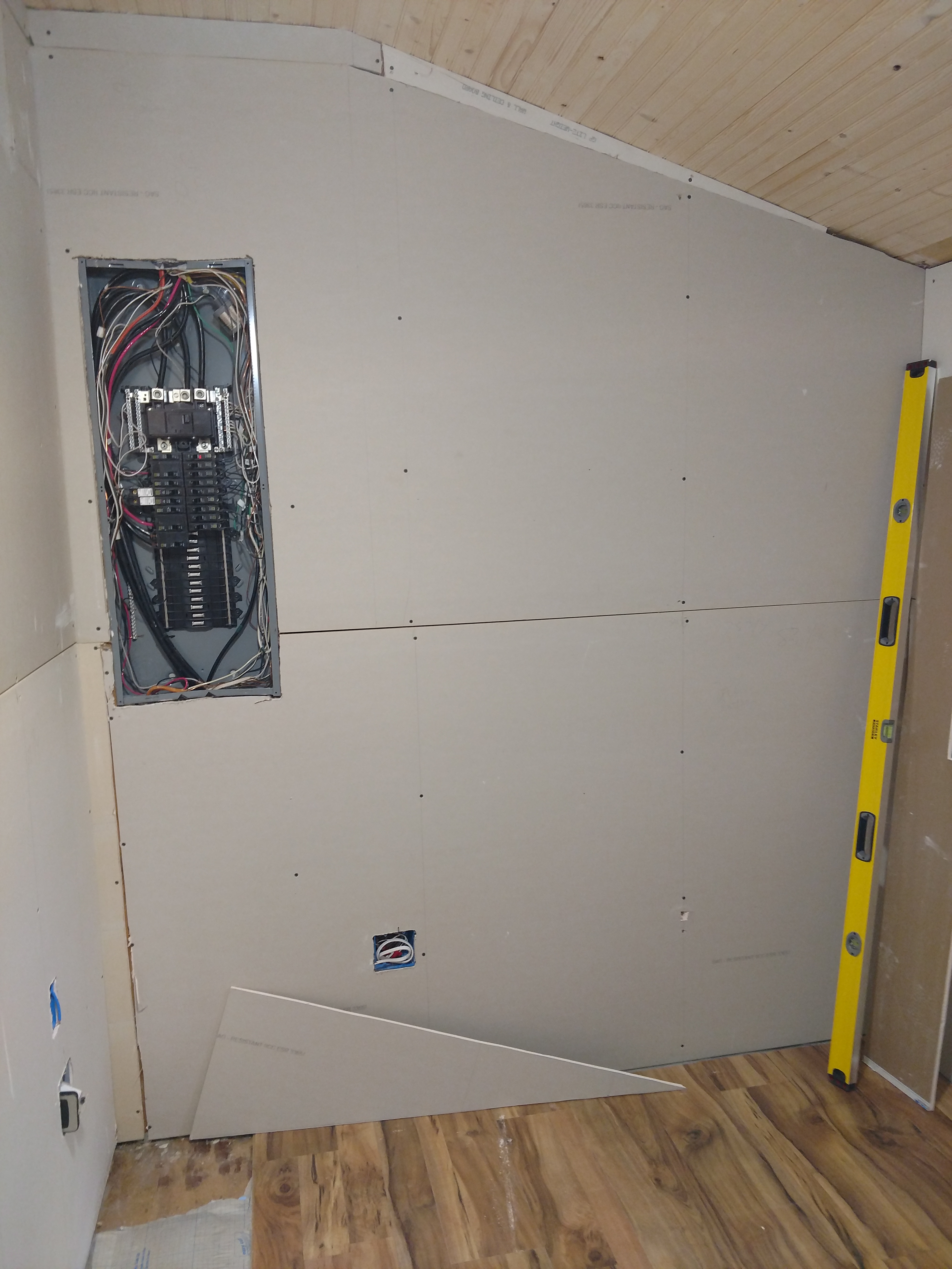

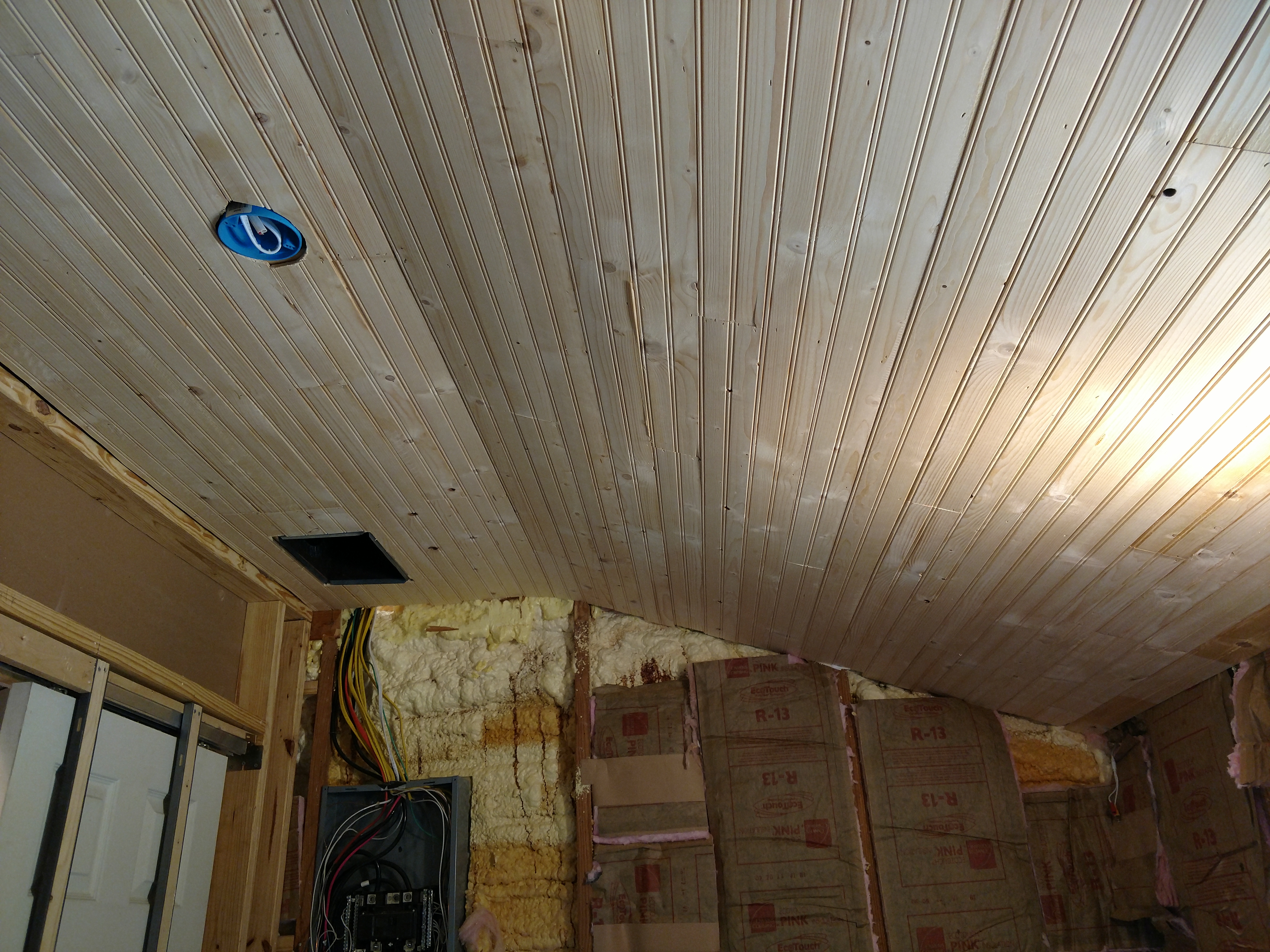

We've moved into the closet and shifted gears to remodel the bedroom and bathroom in the shed and get them ready for Savannah's arrival in early December. In the bedroom, that's moving some electrical, redoing the drywall and getting a ceiling in, I finally finished that all up yesterday. It took quite a bit longer than it should have for such a small room (7x10) but, I'm working through pain so it is what it is. I did a tongue and groove bead board on the ceiling, that I think turned out really well. I also finally got around to running the heavier wire into the breaker box for the 200A service since we're closing this wall up for good now, that was a real PITA.
Starting on the bathroom now, I've got to reroute the hot and cold water supply lines for the new water heater location, move some electrical, redo the drywall and build a custom vanity cabinet since it's an odd sized space and we can't find anything pre-built that fits. Hopefully, this only takes few days but, it'll probably take more than it should like everything else does now.
View attachment IMG_20181014_140346862.jpg View attachment IMG_20181014_140353908.jpg View attachment IMG_20181017_174524154.jpg IMG_20181017_174541779.jpg View attachment IMG_20181017_174608994_BURST000_COVER_TOP.jpg View attachment IMG_20181017_174615118_BURST000_COVER_TOP.jpg IMG_20181017_174625978.jpg

I like the ceiling. That's what I'm going to do with my porch. It's a great look!!!

Thanks on the ceiling, it was a lot more work than I expected but, the results were worth it. That part alone took me a couple of days. We're going to do the same thing in the living room, when we finally get to that part.

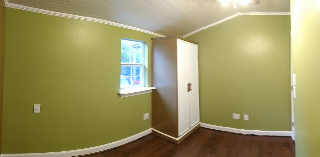

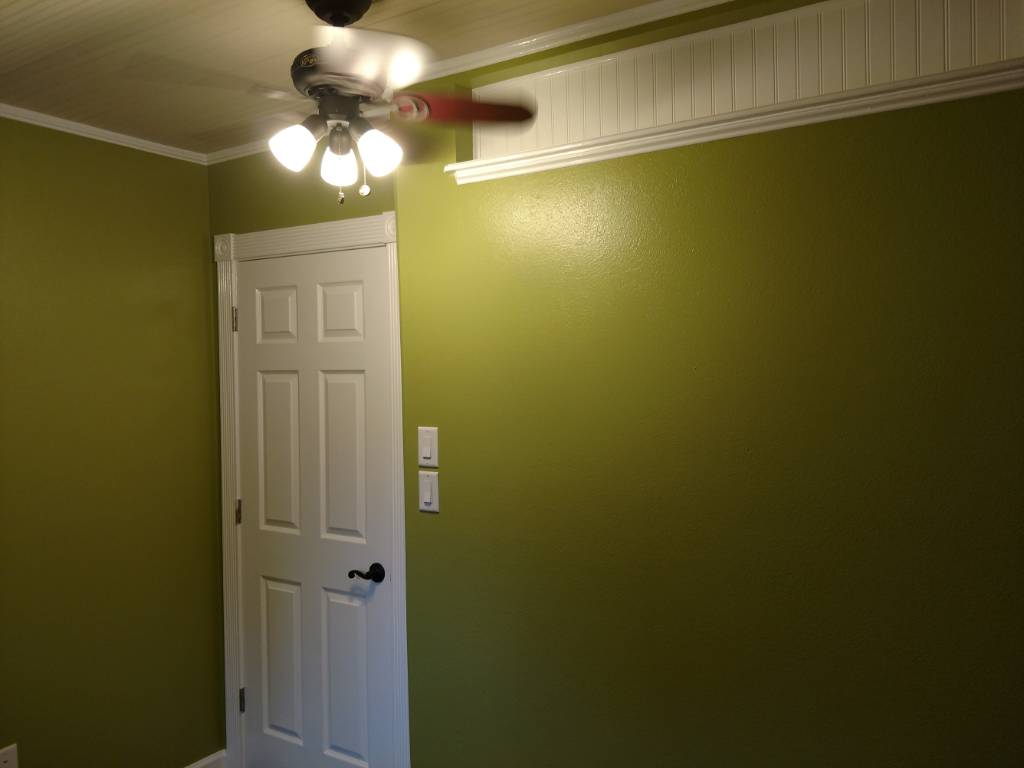

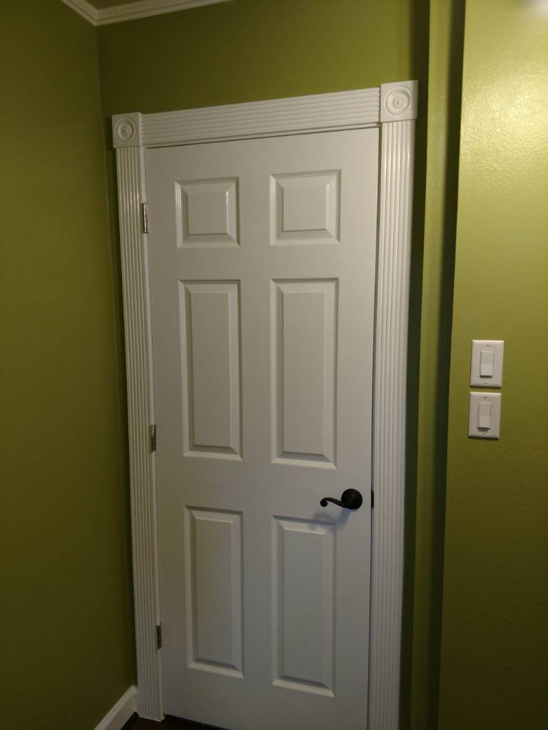

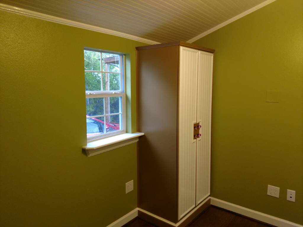

First room is finally complete, it's not in the addition though. It's a 10x7 room, which makes it tough to get good pictures.
This is our daughter's room, she's currently upstairs in our room and we're sleeping in the downstairs closet. With her room done, we can move her into it so that our room can be completed and we can move out of the closet. We have to finish the downstairs bathroom where we moved the wall out about a foot first though. It's not a whole lot do, hopefully it won't take long.
I made the rosette blocks in the door trim and the cove on the ceiling and in the inset because we couldn't find exactly what we wanted at the stores. I'm really happy with how this room turned out, my wife did a fantastic job, she does all the finish carpentry and painting. It's nice to have a complete room to give us a window into how this will all look, eventually.
