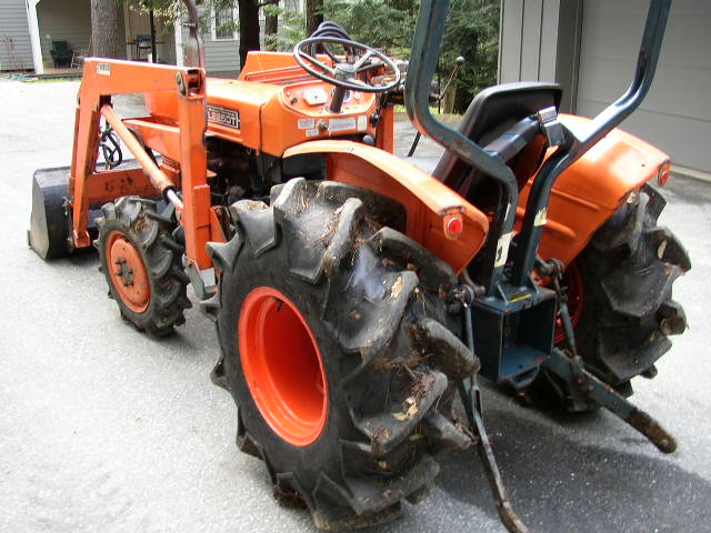

Hi, I have a problem with the rear wheels on my L225. The rims have rusted out and need to be replaced. I haven't been able to find any. I have a feeling I'm not looking in the right places. Any help will be appreciated.

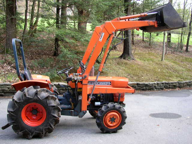

Finding wheels for the L225 is not simple, especially if it has front wheel drive. Front and rear tire diameters need to be the right ratio. The L225DT owner's manual showed 16" rear rims with tall-rib ag tires. Many had turf tires. When my L225DT needed a rear wheel, I found a 16" John Deere implement wheel that was nearly identical. The bolt holes needed to be slightly reamed out to slip on. Not ideal, but it worked. If your machine is 2wd there may be more rear wheel/tire options because they're independent of the fronts.

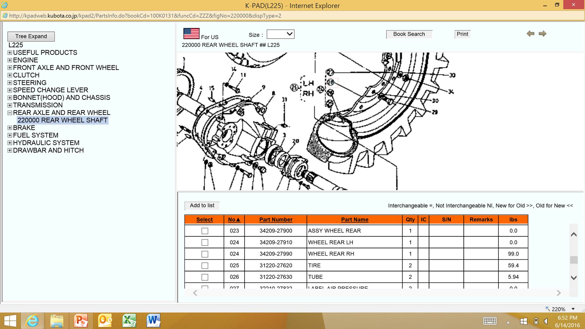

Did you consult your local Kubota dealership? It looks like the wheels are still available, but at a significant cost.
Looking at the parts listing on Kubota.com, it looks like there are different p/n's for left and right hand side. Not certain why, but that is the way they are listed.
34209-27910 LH ASY 9,5X24R1 $589.10
34209-27990 RH ASY 9.5X24R1 $818.85
The picture with item numbers on Kubota.com is very difficult to read, so it's possible I'm reading it incorrectly and suggest you verify yourself.

Did you see the p/n (34209-27900) for the wheel assembly in the photo provided in the earlier link? Sometimes it is cheaper to buy the wheel and tire from Kubota than the tire alone. Couldn't verify the item number (023) in the photo to confirm it was the AG tire/wheel. Might be worth investigating though. Keep in mind it is often more economical to purchase complete tire/wheel assembly from wholegoods (sales side) versus going though parts.
Long shot...
M7040SUH/SUHD uses a 9.5-24 R1 for the front tire. Order Code AMR8955C with a suggested List price of $459.00 This is for the wheel and tire mounted ready to put on your tractor. You'll need to research the bolt pattern and other mounting info.

I realize this is an old post but I thought I'd reply with a solution that worked for me incase anyone else has this issue in the future. The L225 was only made for a couple of years and I too found replacement 9.5x24 wheels impossible to find. I found some 10x24s on eBay however for $150/ea shipped that work perfectly. The only minor issues are that the eBay rim is silver in color and I had to buy some grade8 5/8"x3 1/2" bolts, nuts and washers to make it work. The Kubota wheel-centers fit like a glove. The rim was item #381840869095 and advertised as "Tractor Wheel Rim 10 X 24 for International Farmall Massey Harris Allis Chalmers".
