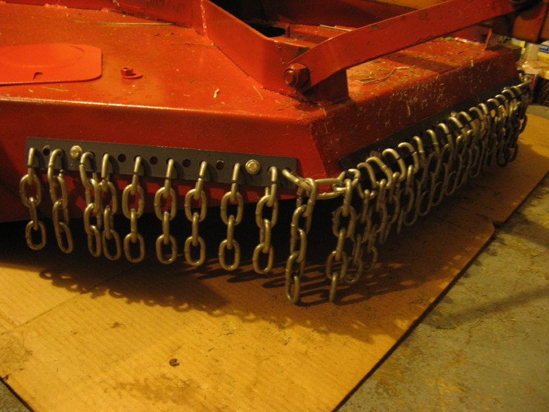

Well, I did some mowing with my rotary mower, and I think I should modify my chains. While I'm mowing, the chains get flipped up occasionally and tend to get stuck on the offset metal stock holding them. I think I'll just use short bolts and let the chains sit right against the mower deck. Hopefully I can get away without having to shorten each of those lengths of chain; my hands are still a little sore from doing all of those cuts before.

Well, I did some mowing with my rotary mower, and I think I should modify my chains. While I'm mowing, the chains get flipped up occasionally and tend to get stuck on the offset metal stock holding them. I think I'll just use short bolts and let the chains sit right against the mower deck. Hopefully I can get away without having to short each of those lengths of chain; my hands are still a little sore from doing all of those cuts before.
Man use an angle grinder. Maytake a second or 3 longer each cut but no force is involved!

Clemsonfor -- that would take all the fun out of it. :)
Here are pics of my modified chain guard. They are not off-set from the deck now, and I had to shorten most of the links so that none of them can reach the blade tips. I haven't tried mowing yet, but I don't think they will get caught on top now, and this modification may also solve the issue Clemsonfor raised earlier regarding backing into things.
I like it! It looks better too, dosent look as flimsy either. Slap some red pain on it and call it good. I know if you paint the chains it will come off in no time but it will help your flat stock blend better.

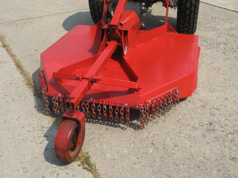

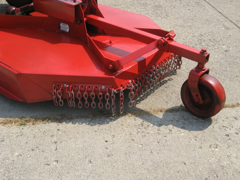

I ordered a quart of the Yanmar red paint from Hoye, and I'm going to do the whole mower including the flat metal stock. BTW, I started painting the mower with a can of the Yanmar red and ran out after 1 and a half coats... :D
   / Finish mower chains #26
Updated pictures after painting... :thumbsup:
Oh no! You got paint on the tire and on some of the chains. Better get some paint thinner and get that off fast its making your work look sloppy!
Gr8 job seriously and thanks for the pics.
