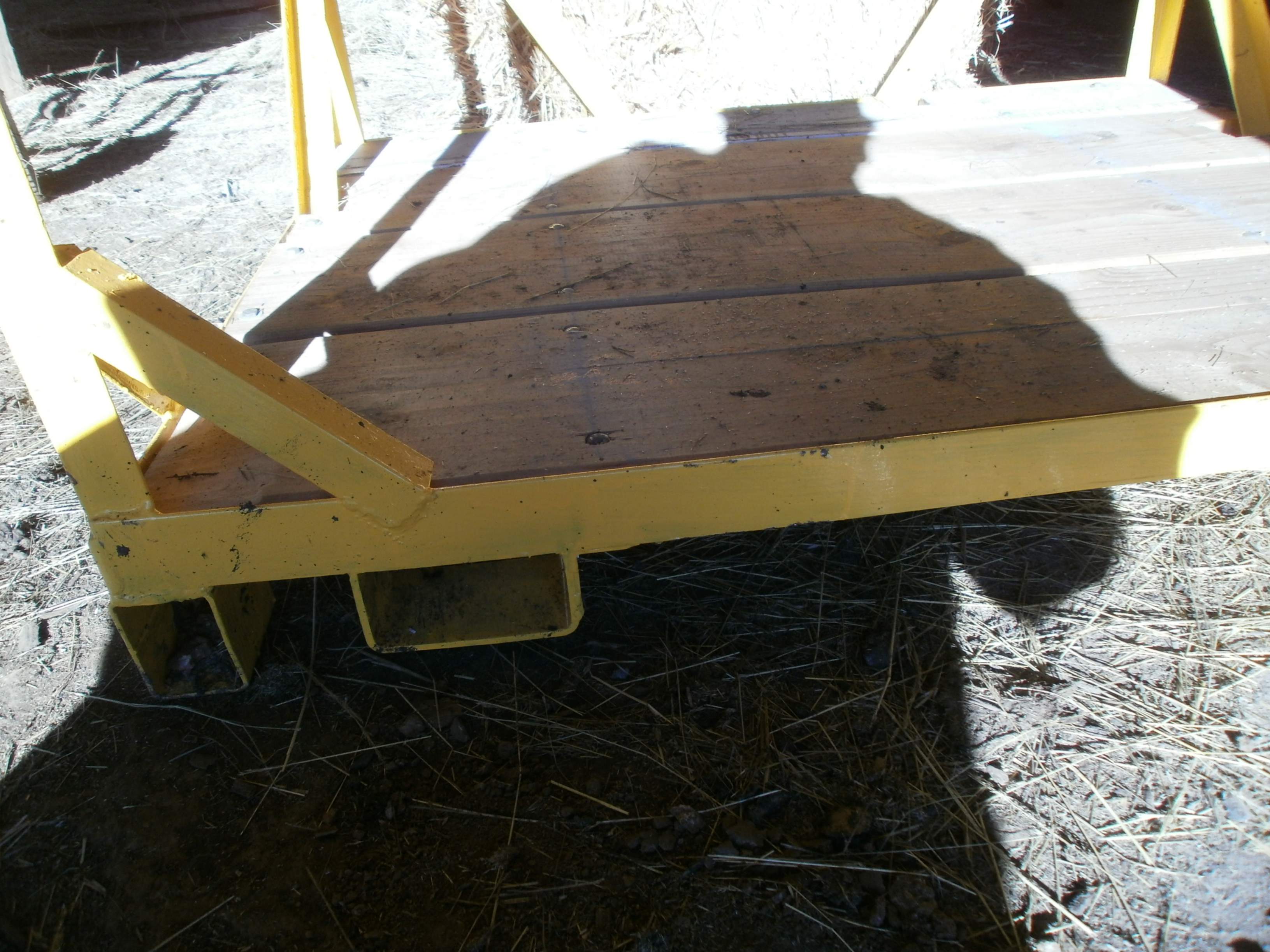

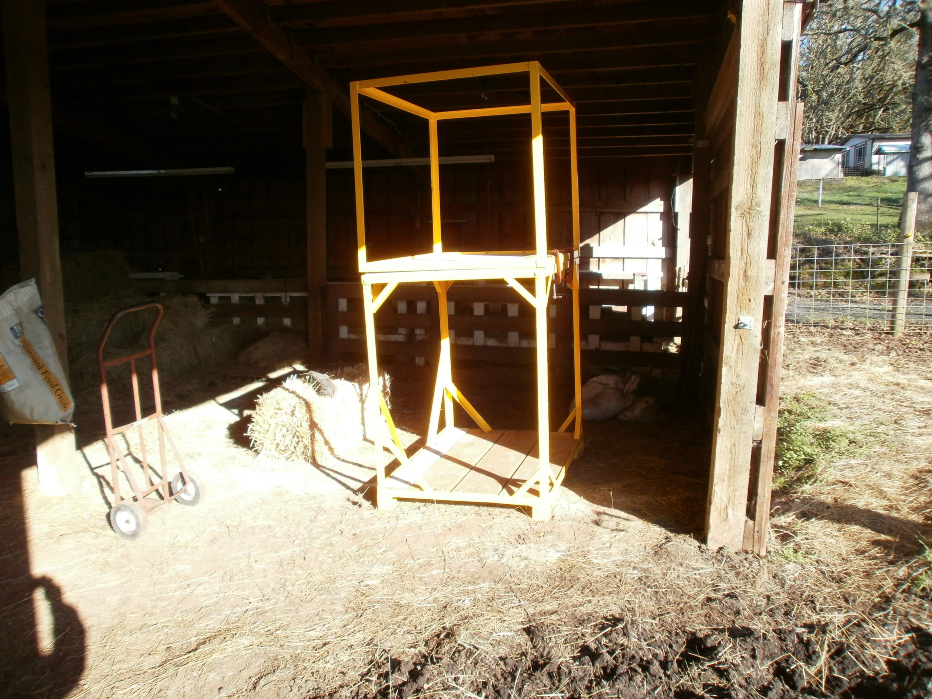

Here is my idea of one, i posted it before.
I can use the bottom deck, or if I need more height, attach the upper deck
Bottom deck is two by six
Upper deck is three quarter inch plywood. Both have angle or flat stock underneath for stringers.
The bottom one started out as a Woodmaxx Chipper pallet.

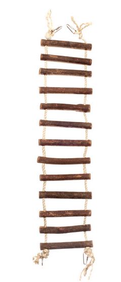

Wow... I thought I was being clever when I fabbed-up a 2x4 support for my FEL. REALLY helped with cleaning out the gutters on the house. Hard to do as a one-man show, but I used this from my son's playset to get up and down and work the levers. Probably not OSHA approved now that I think about it...
