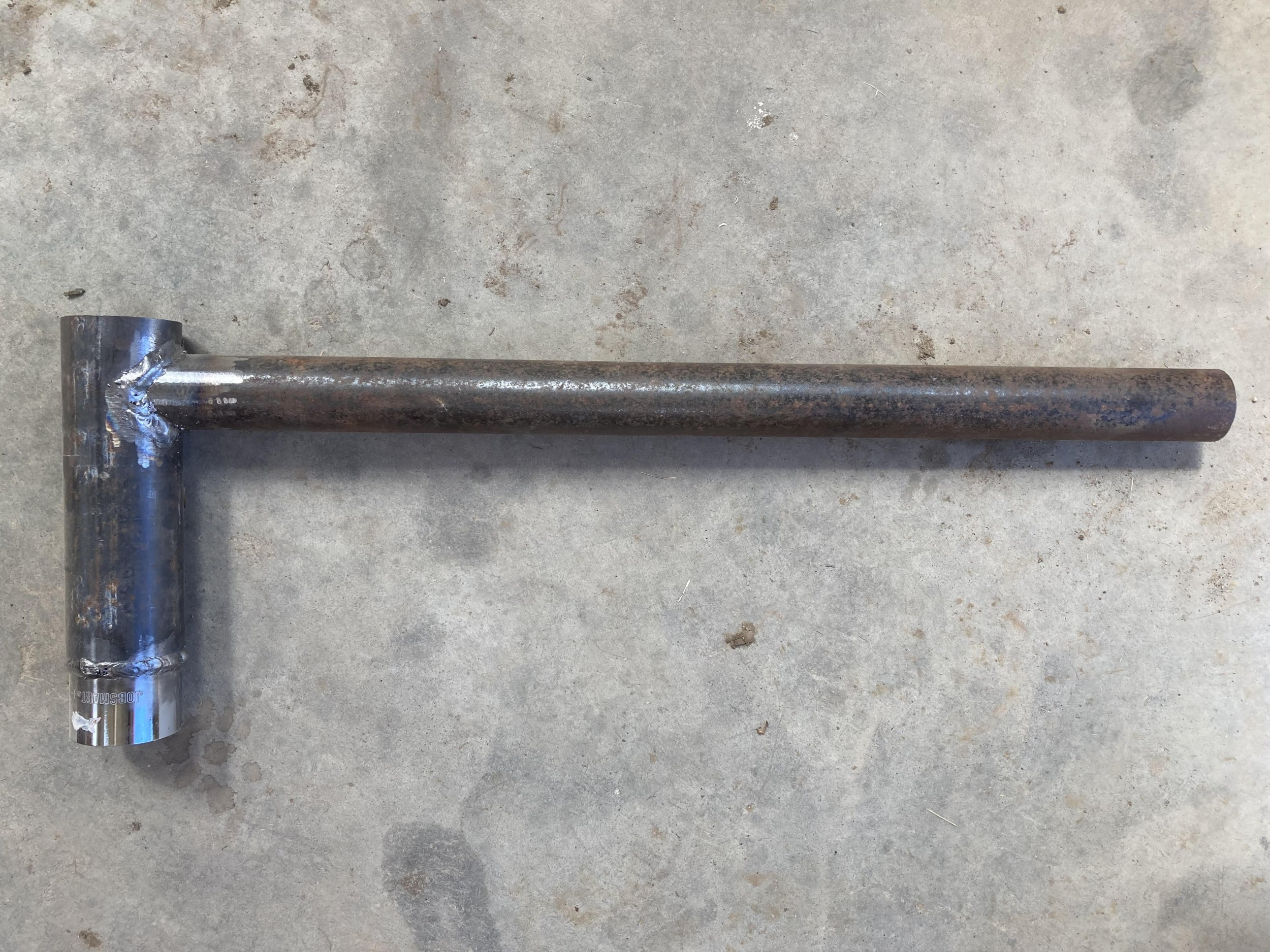

My Land Pride RCF2072 specs 450 ft-lbs for the 1-11/16" blade nuts. Made this wrench from scrap pipe and a cheap socket. Use a pipe to extend it out to 8' so removal is much easier and tightening to spec is about 56 lbs at the end. Worth the effort it made sharpening the blades much easier.
