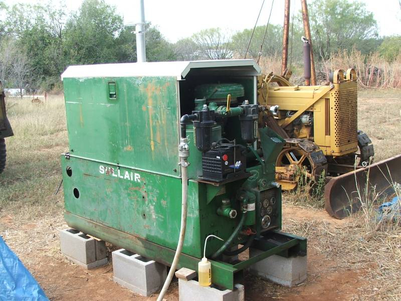

I've got an old Sullair 160 gasser (GM 4-cyl.). It puts out massive amounts of air. I haven't tried using air tools with it, but it sure does work dandy for sandblasting. ;) The 160 stands for 160cfm!
