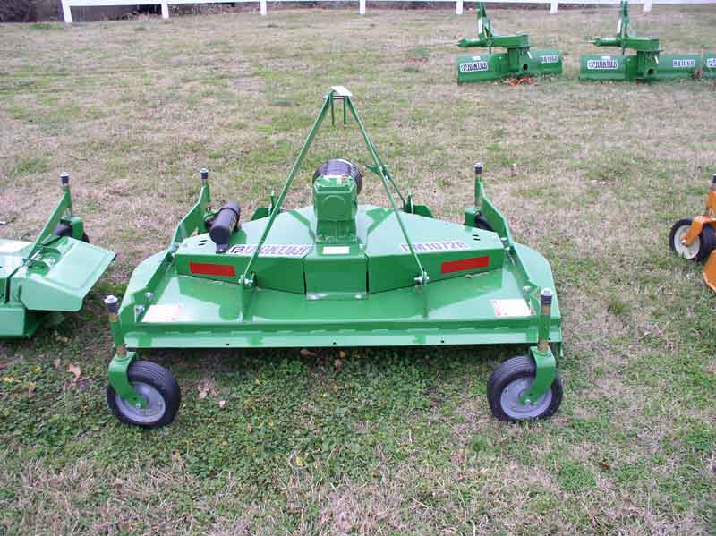

<font color="blue"> Frontier GM1072R </font>
   / FINISHING MOWERS :: PHOTO comparison of brands
<font color="blue">Frontier GM1072R </font>

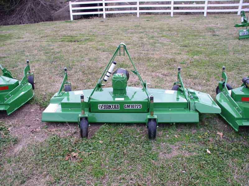

<font color="blue">Frontier GM1072S </font>

<font color="blue"> Frontier GM1072S</font>
