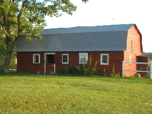

Here's a picture of the outside of our barn. I needed a sample pic so I could figure out how to attach.
This weekend I will take some "before" pics of the inside.
Bob

Nice looking building Bob. I think you've got the right idea in finishing this off. In my neighborhood, I see folks with these types of buildings convert them to home residences. Well worth the effort.
...Bob

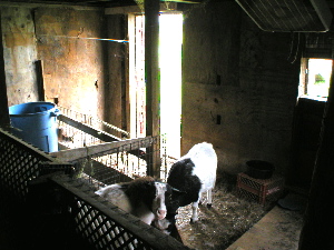

Here's a before picture facing west.
