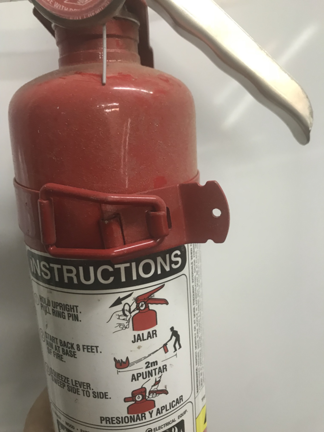

I have been looking for a fire extinguisher bracket for a tractor. Does anyone have any they like or don't like? Can someone point in the right direction? I worry about the brackets with the single metal strap that tightens down, I feel it could pop loose. What about Velcro?
   / Fire extinguisher #2
I bought my extinguisher at a local box store. It came with a plastic mounting bracket with plastic hold down strap. Its been on my tractor for 5 years now. Never had a problem with it coming off. It is mounted inside the cab on the lower left dash panel and has been kicked quite a few time with my big foot. If I recall it was less than $40. I know home depot sells metal brackets with single strap separate for a few size ext's.
   / Fire extinguisher #3
I thought about high quality nylon wire ties. Ones that won't degrade, strong enough to hold the extinuisher but weak enough that you can rip them off.
   / Fire extinguisher #4
Why not just tie down the strap that’s already in them so it can’t come undone? You also want to find a cap to cover the end so dirt dobbers won’t plug it up. IMG_1550.JPG
