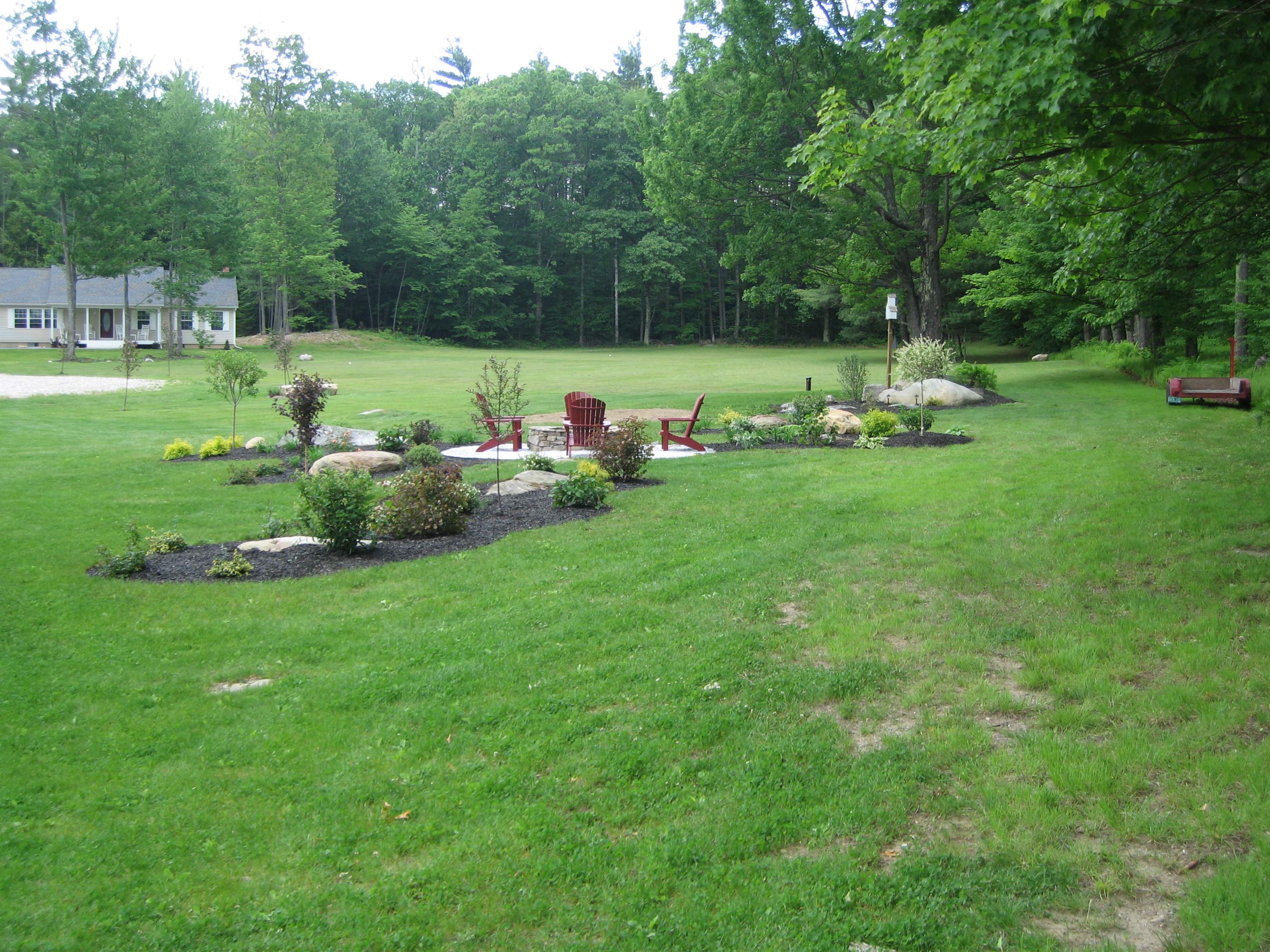

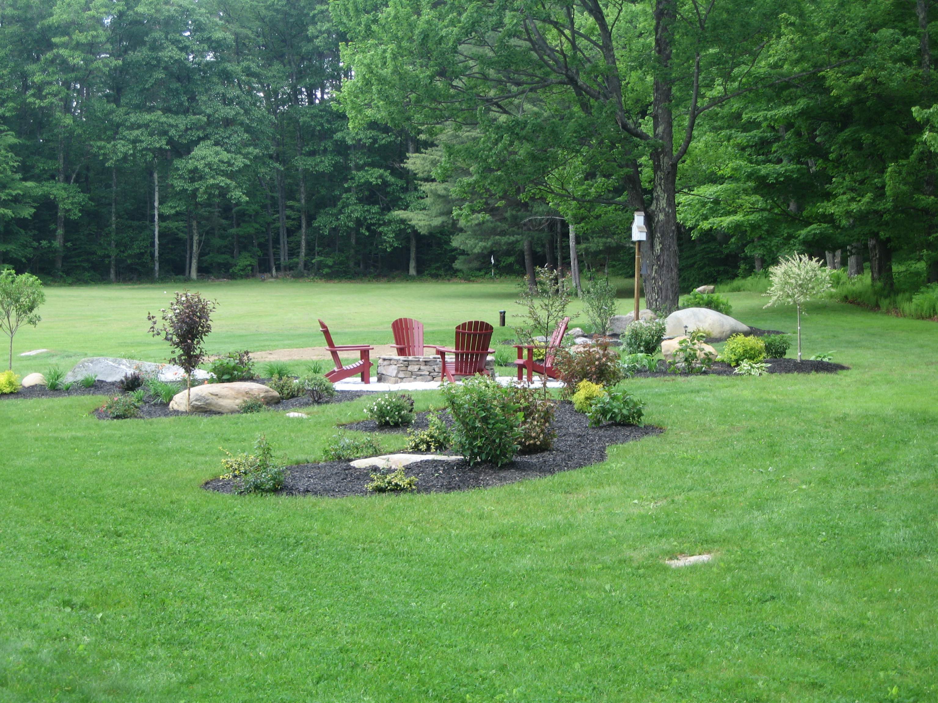

Hey, that looks great! You're a lot faster than we were. You're gonna love it! Not sure if the fire brick is necessary, but some have said regular rock can explode with high heat, so I opted to do the fire brick. Cheap insurance. We've had a few fires now and love the addition to our yard. So much that we did a little more landscaping. Eventually hope to do bluestone around the pit and add a walkway to the house. we made it a little big which makes starting fires a little harder but we can fit a lot of people around it. Cooks a mean Smore:)

Landscaping looks great! We had some rock left over so going to make boarders around a couple of the flower beds to match for the wife..
I kicked the idea around and around on the clay bricks. What a guy who builds clay pizza ovens told me was that the red solid bricks can be used for the top of the oven and will hold up just fine in the long run, but you might have a couple crack. The fire brick will last longer and are really meant for the high heats and cooling/heating cycles..
So when spending 300 - 400 bucks, whats another 100 for some insurance.. Specially when your spending the time and effort.
