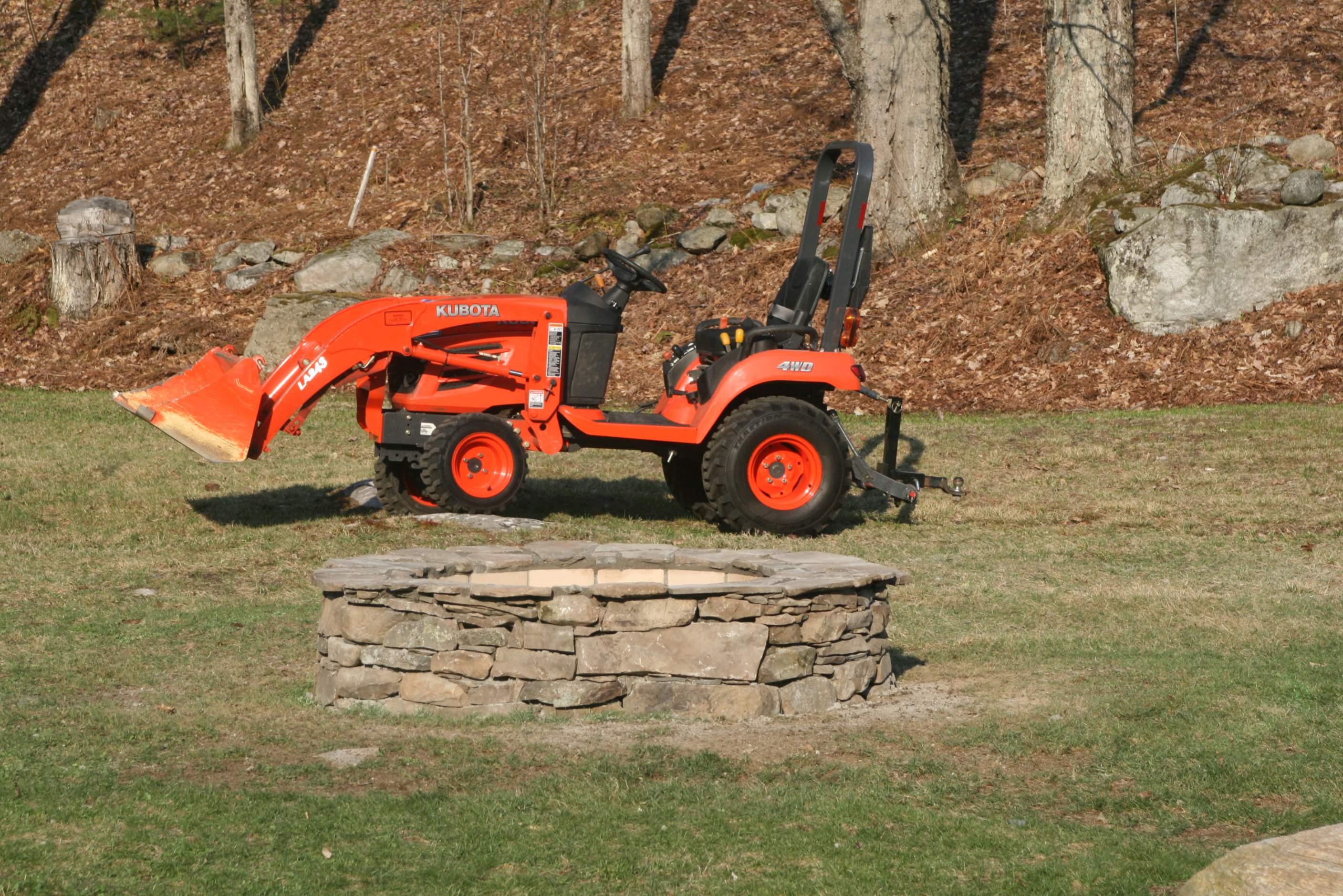

Thanks for all the nice comments! I'm just the lugger and toter. Kyle, the mason, is the doing a real nice job and teaching me a few things along the way. We did put rebar in the footing and the mortar is 2 parts masonry sand to one part masonry cement. Much cheaper than buying the premix. Hopefully we'll get it capped today and pictures tonight. The inside we're unsure of. I may put in some sort of stone or sand, but i'm open to suggestions. Then it's on to the patio portion. Should be just as much fun and just as much totin' and lifting:)

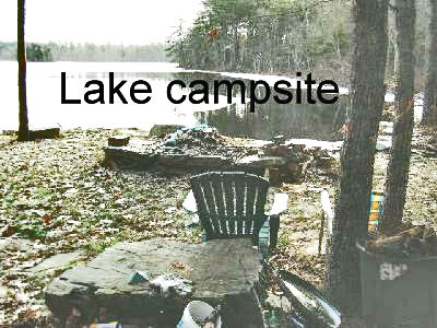

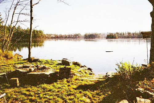

I just drive up to my Fire Hill and sweep the ashes into the tractor bucket!:D

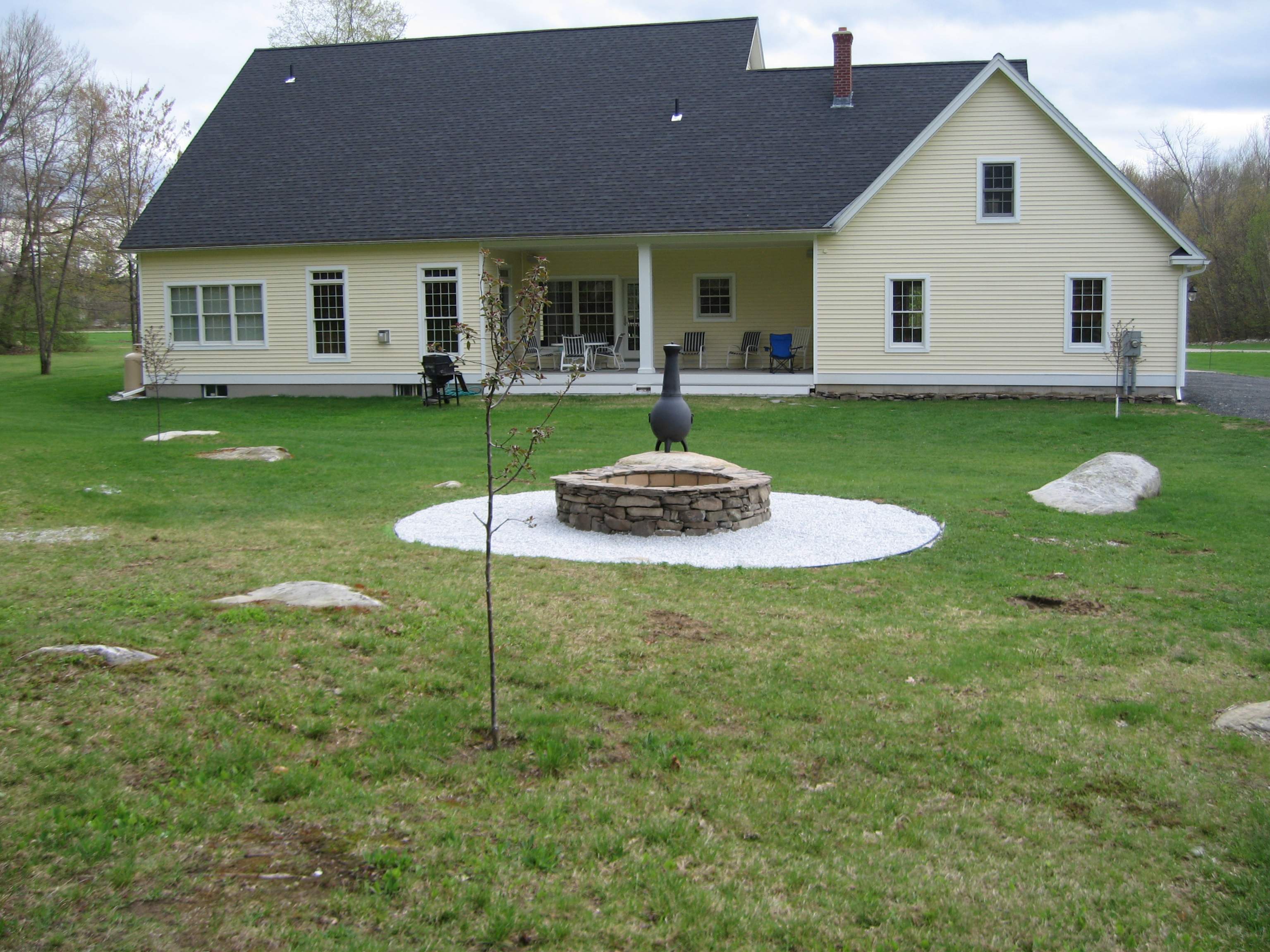

Well, I finished the seating area for now. 2 tons of 3/8" stone for 17 bucks. what a deal! I still want to put some sort of stone down but am going to let this settle for awhile and look around for what I want to do. Had enough stone left over to put a small planting bed wall on the side of the garage. I really like the pit but now I realize we need some more landscaping around it. Have to sit on the back porch and ponder that over a few beers. My best ideas come after about beer #6 on a nice hot summer day!
I'm hoping for a fire soon, but the forecast calls for rain thru the weekend. Sure to post the fire pic when I do.

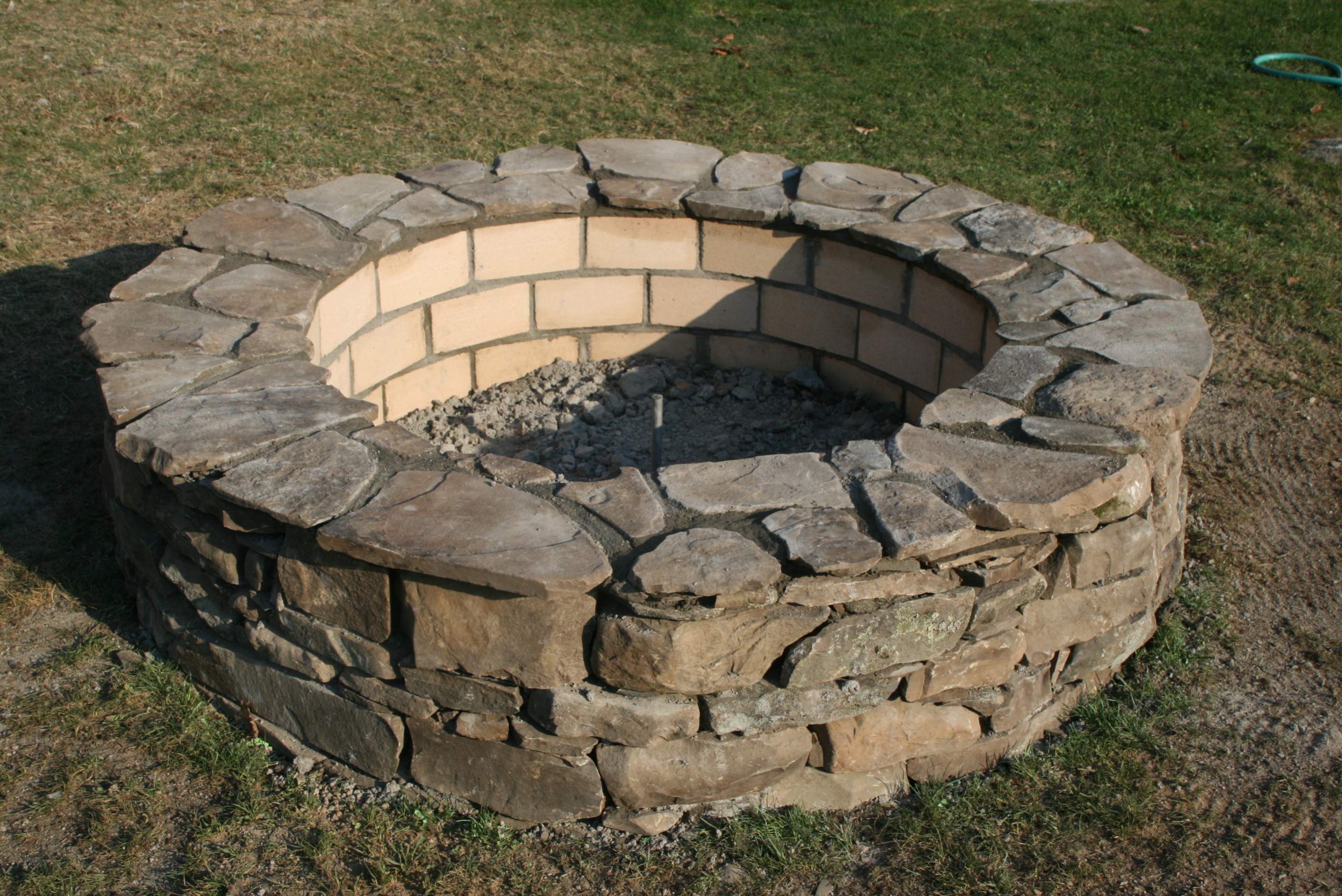

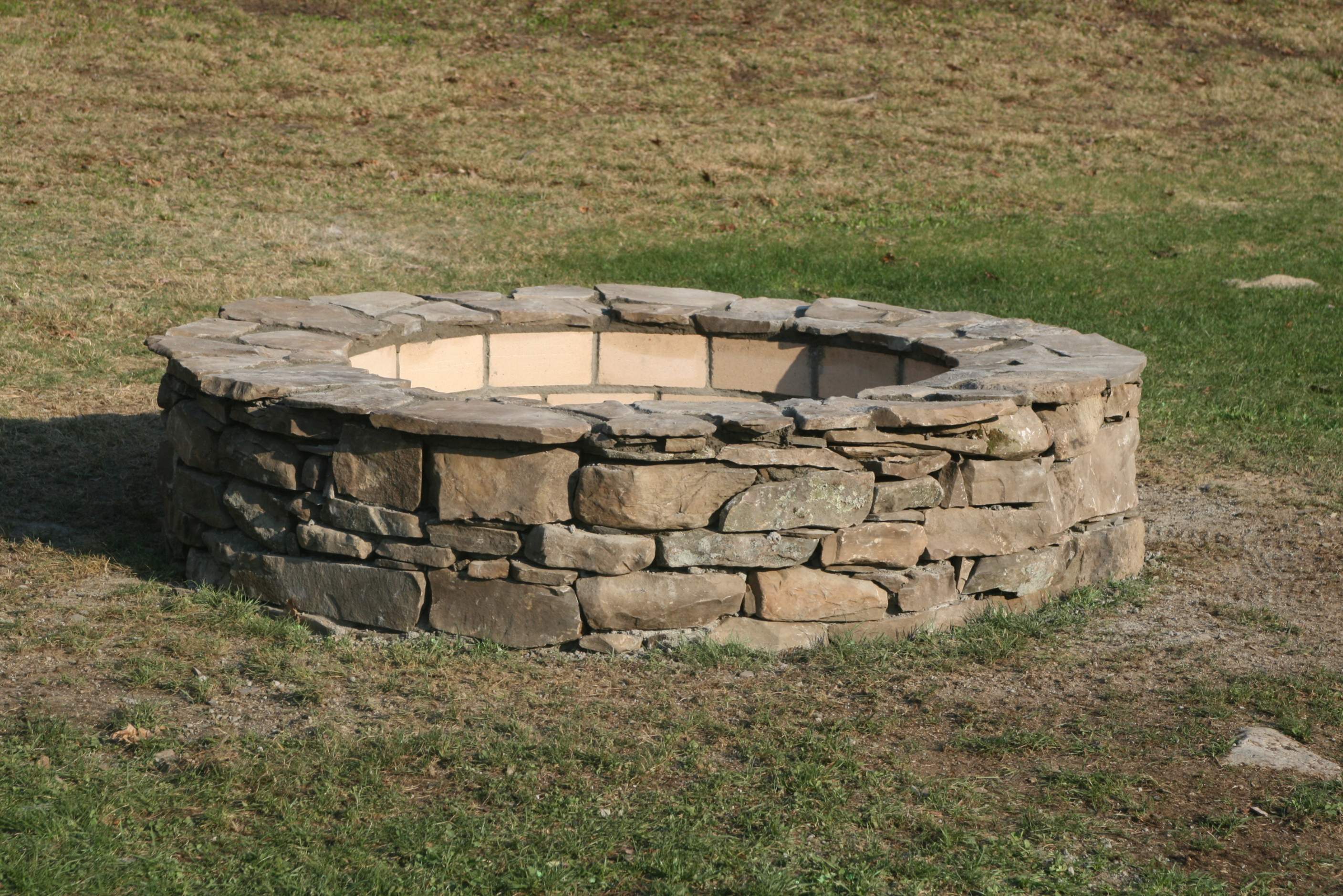

sure, I hit post and forgot the pics:) Geese just showed up to see what was going on.

Good Evenin harpoonalt,
Gee that came out great ! Thanks for posting all the great pics also !
Post more pics of the first fire and of course the whiskey ! ;):)

Nice job. I like the rock that you put around the fire pit to stand on and keep the grass separate from the fire pit. Thanks for the update and commentary.

harpoonalt - I am going to do a simlar thing (hopefully in a weekend) at the cottage. Can you give me a rough idea how much brick you used? Also the overall diameter..
Thanks looks great..
/ Fire Pit #35
Fire pit looks great, I'm not to crazy about the white stone around, IMO it distracts from the beauty of the professionally laid natural stone work and it gets messy, some type of flat patio stone would go better.
If you get a good sized fire in there you wont be standing that close anyway though :)
JB.
/ Fire Pit
#36
Thanks for the nice comments! I'm not crazy about the stone color either. I wanted a darker color but whatever vein the pit is working at the time is your choice. We're going to live with it for awhile until we find some complementary flagstone to put down instead. The pit is based on a DIY rock solid episode. They called for 60 firebrick for a smaller pit. We used 3 rows of 16 or 48 total for a larger pit. The pit is 6' OD with foot thick walls and an ID of 4'. The one on tv was smaller and didn't look right in our yard when I did the layout so we upsized. Still need some fire pictures and hopefully the right patio stone will show up in the stone yard and we'll finish that. Hope that helped.
