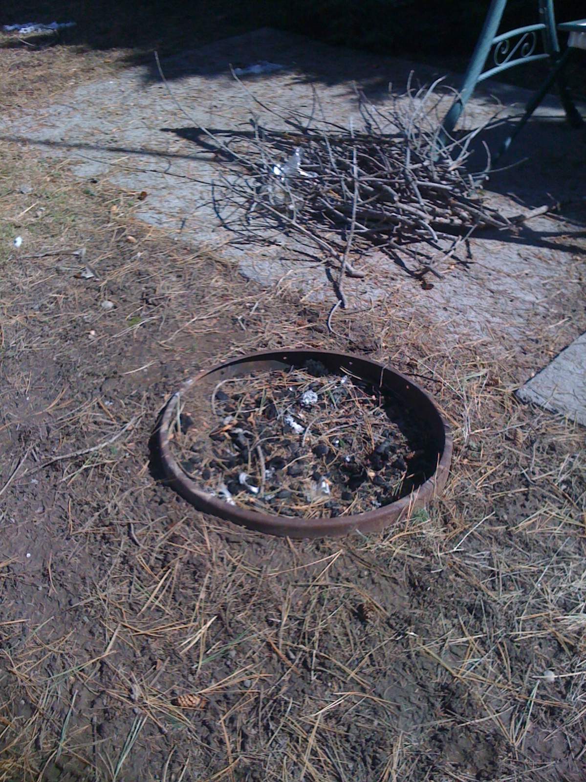

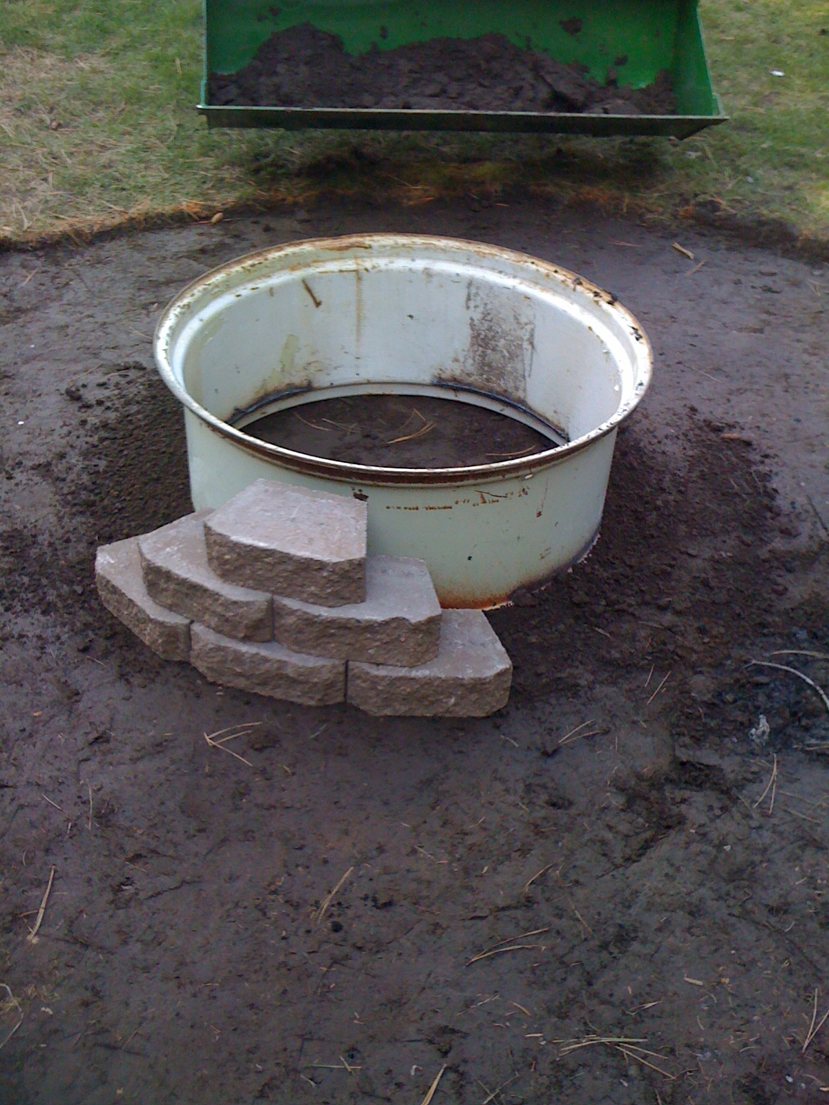

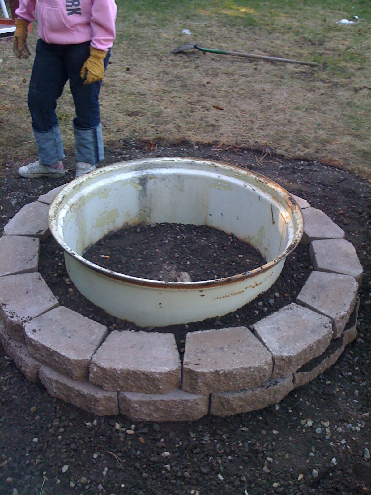

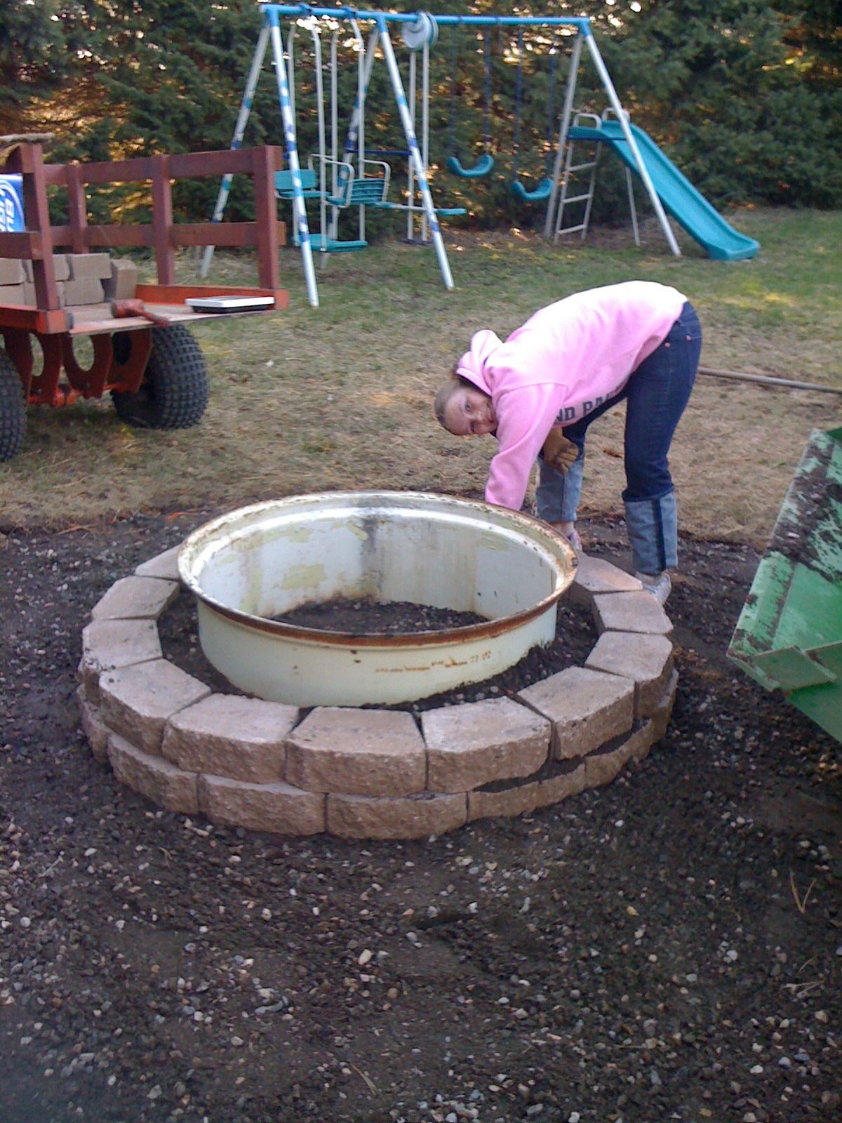

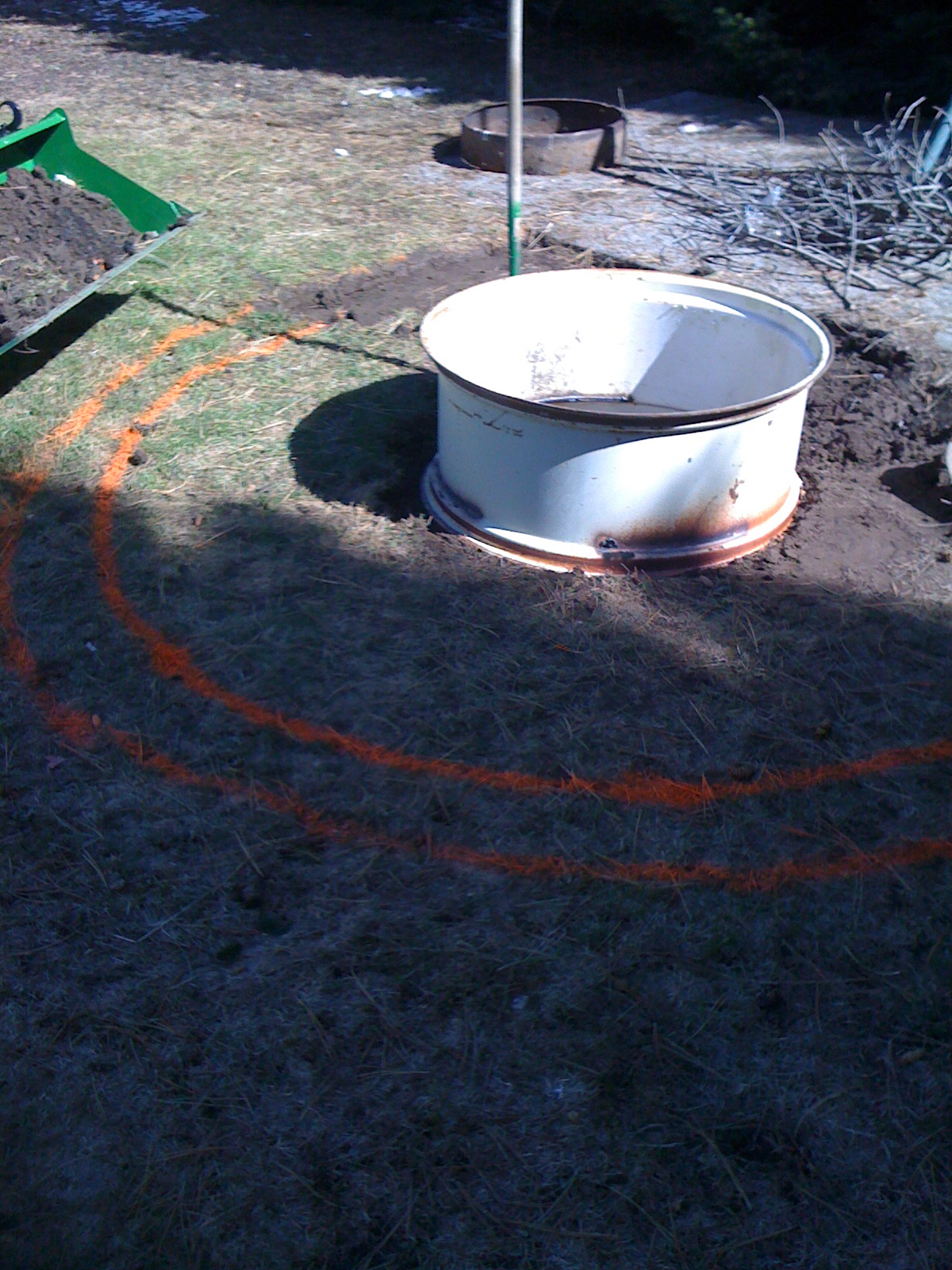

So we finally got around to putting in a new fire pit in our backyard over the weekend. The old one was just an old steel rim with center cut out and dirt surrounding it, muddy mess some days, and dangerous as someone always ended up with melted shoe bottoms for some reason;);) lol, and little kids running around always worried us about tripping into the pit.
Anyhow, I got a new/used tractor rim from a local farmer for free, cut the center out, cutout sod and dirt area for new pit, placed rim and leveled it, installed retaining wall blocks 4 high around it leaving a gap between the rim and blocks, once the 3rd row of blocks was in we filled the gap with crushed gravel and sand to absorb the heat and keep it off the blocks. Still need to add more gravel and sand around the top row of blocks and some more gravel around the pit as it has settled and packed down. Even got my girls to help if you can believe that:shocked::shocked:

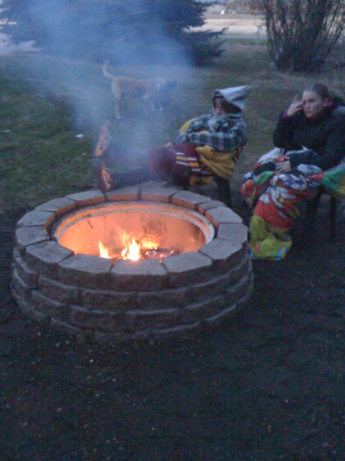

Nice setup now, as people can actually sit on the edge of the blocks to warm their backside and not get burned. We used it Sat for 6 hrs and the blocks were still cool to the touch.
Thanks to older posts here on TBN for the idea and info!!!!

I like that.
Do you have any vent holes near the bottom to let some air in to flame the fire.??
/ Fire pit
I like that.
No vent holes. With the rim being 40" diameter it seems to feed the flame pretty good as is.
Thanks for the comments:drink:

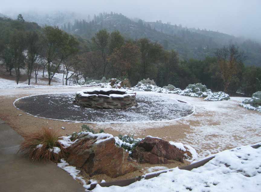

Wish I'd of seen this thread before I built mine. Had plenty of stone, but no wheel for a liner, so I wonder how long the mortar is gonna hold up?
One thing I'm glad I did was dig a trench from the center over the edge of the hill for drainage. Had some perf pipe left over from another job, and just filled washed gravel into the bottom of the pit to keep it from melting.

Very nice pit and awesome view! Man that would make a great post card..:thumbsup:
/ Fire pit #20
Maybe next year for Christmas, Murph ;)
First time in the four years I've been here that it's actually snowed at the house. Kinda reminds me of winter in Ohio when I was a kid...
